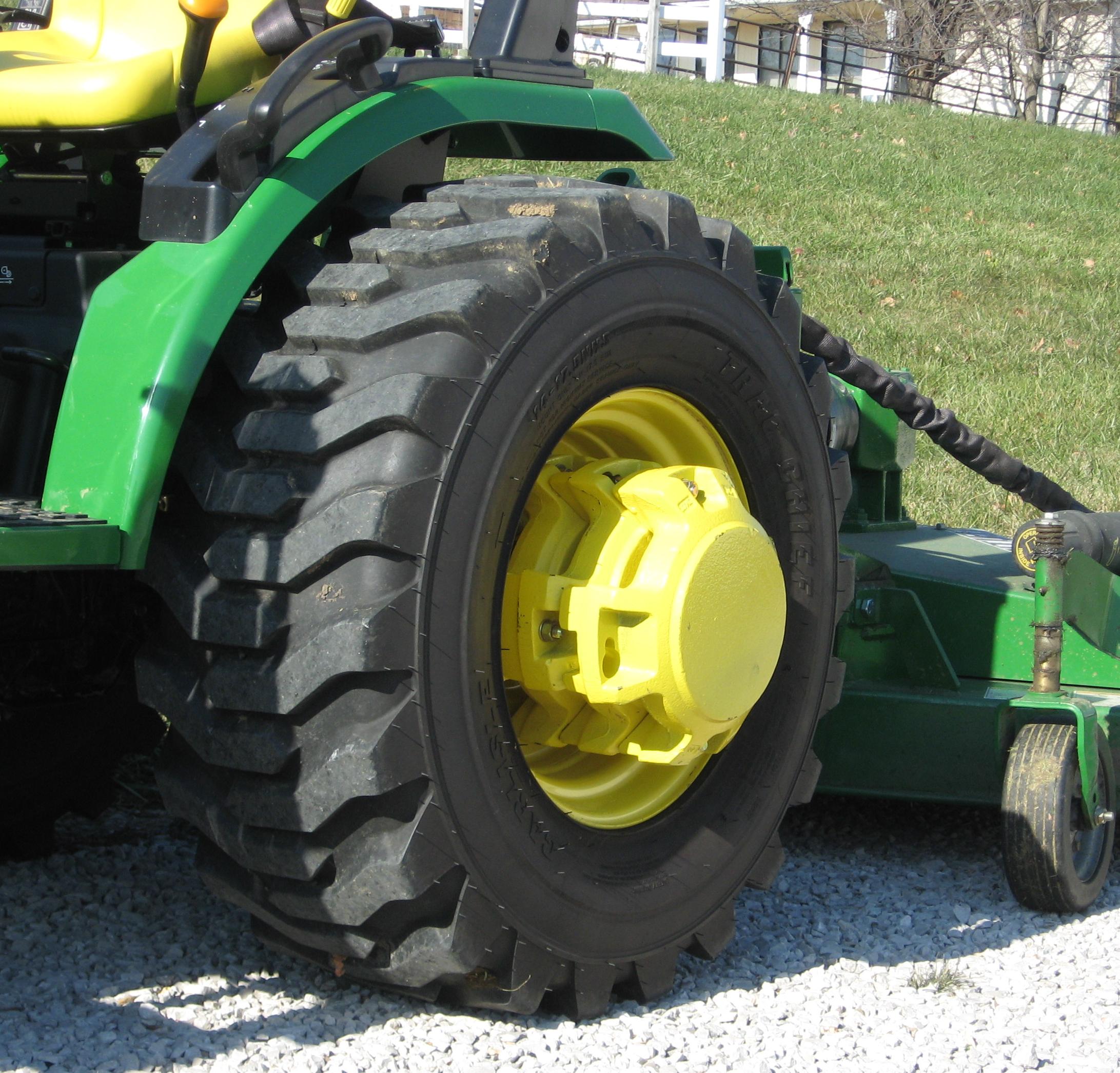

There is another option: wheel weights.
Doesn't put as much weight on the tires as loading, but a heck of a lot easier to remove if you decide you don't need it. I need the traction so have six wheel weights on at all times.

Runner, I take it you have been happy with wheel weights? I have decided against filling the tires, and instead plan to buy at least 2 wheel weights per side (maybe the max of 3)... The weights for our tractor (2520) is 60 lbs per weight correct? I am thinking the weights will help with the slopes on my property. Can they be installed even when the wheels are in the "wide/reversed" position?

"The weights for our tractor (2520) is 60 lbs per weight correct? I am thinking the weights will help with the slopes on my property. Can they be installed even when the wheels are in the "wide/reversed" position?"
Yes. My wheels are in the reversed position and I have three weights per side. And you are correct, they are 60 lbs each.
I started out with two per side and couldn't tell any difference. Three is a little better, but still kind of light. I think it's a fairly good compromise between traction and lawn-friendliness.
