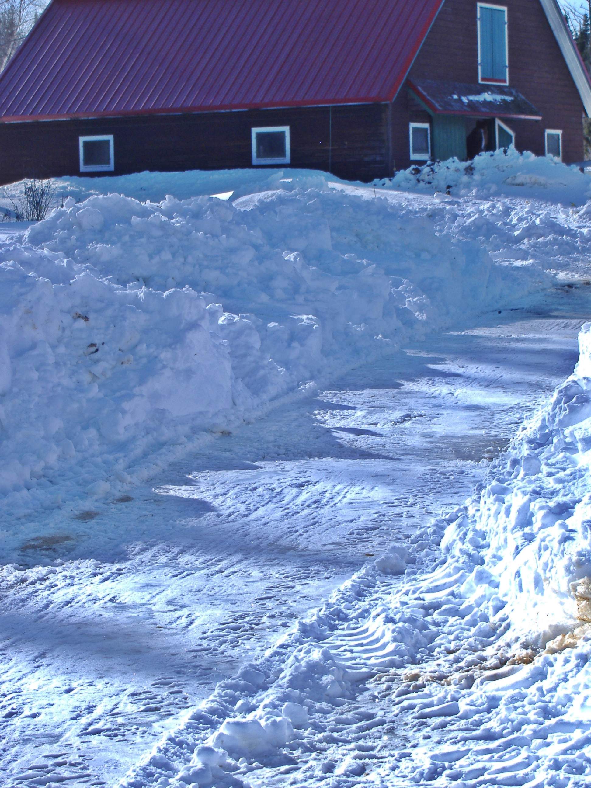

I use the bucket on my NH TC30 for snow. I have R1 ag tires. I used to have a 7' plow on it but I went to the bucket so that I could move horse manure during the winter. The tire are loaded with beet juice. I use chains. With the snow and ice, I need them both. The banks get high. I clear the drives and around the barn. Do them both- worth it. A blower would be nice, but I am too stiff to twist around in the seat. This is the previous year.
