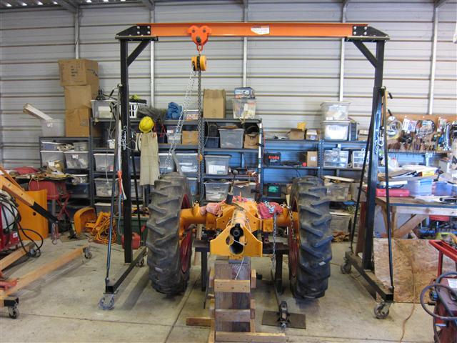

I need to remove the loaded rear tires to install wheel spacers. They weigh 700-800 lbs each. Anyone here had to remove loaded tires and how did you do it while minimizing the risk of the tire falling over and not being able to stand it back up?
Get a chain hoist and do the job safely. Don't rely on yourself and a buddy to handle that kind of weight.
I bought my hoist from Harbor Freight for $500. If you can't afford proper equipment or don't have floor space to do the job safely, drain the tires.
Good luck and be careful out there.
