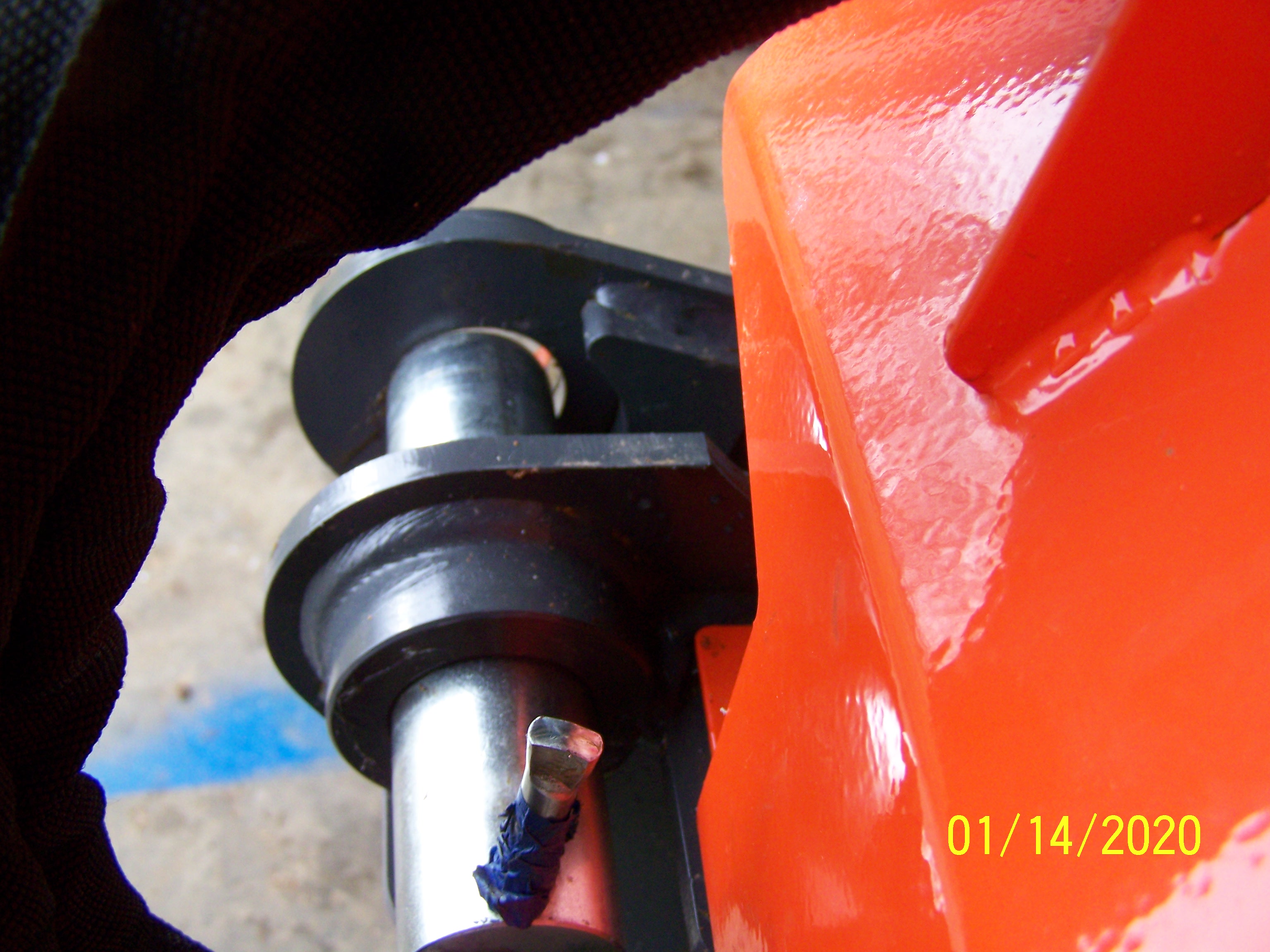

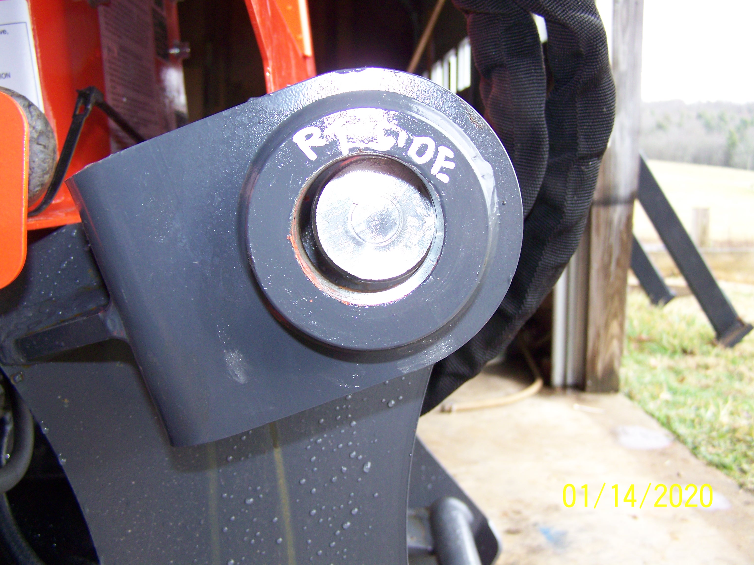

I thank you all for your opinions. I think I'll ignore the warning and leave the tires loaded.
In anticipation of hooking up the backhoe I've removed my counterweight and the 3 point hitch components. This greatly reduces my FEL lifting capabilities. Without the loaded tires, I think the FEL would be about useless.
I'll find out today.
Murphy's law went into high gear yesterday.
I went to couple the backhoe up and I found that the coupling pins wouldn't go through the clevis. After an hour or two of trying to align the coupling, I decided to pull the tractor away from the backhoe and disconnect.
With the backhoe sitting all by itself I discovered that the locking pins won't go through their clevises! The holes are misaligned by about 1/4 inch!:shocked:
I wish I checked the alignment while it was still on the pallet, but I never dreamed that it would be necessary. So much for made in USA QC.
I called my salesman and I'm sure Kubota will make it right. It's just kind of a PITA having to repack everything and return it.
Without the 3 PH/ counterweight on my L47 I doubt I'll be able to load it on the trailer. Time to borrow my friends NH.
Thanks again for your opinions.

I was able to connect the backhoe to my tractor by using a couple of pieces of 1 1/2 iron pipe in place of the pins.
The pipe was just a little bit smaller od so it made up for the misalignment.
I won't dig a hole with this jury rig, but it allowed me to load tractor and backhoe as a unit and not have to put it on a pallet.
Off to to the Kubota dealer I go.
No argument from the staff. Everyone agreed that it was a factory screwup, and the clevis was badly misaligned on both sides.
Since it was going to be a major PITA to fix, they gave me a backhoe off another new L47TLB. The mechanics mounted it on my tractor, and home I went.
