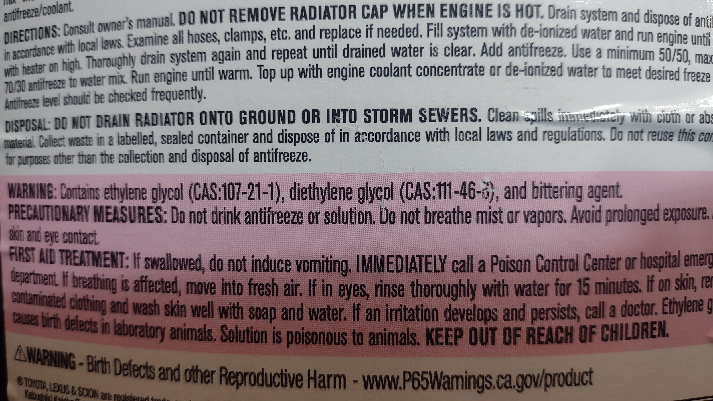

Thanks guys. I am familiar with the two types of glycol because of my 30 years working in HVAC. I am also hoping it is P glycol and not E glycol. My worry is that they are using this as a way to dispose of old antifreeze (E type) that they have drained out of tractors during service work.
Being in hvac you may recognize Cryotek - a non-toxic antifreeze used in potable water systems. I diluted some and loaded my rears with it.
I just wasn't comfortable with a toxic fill.

I use antifreeze in my tires because I had over 55 gallons of used 50/50 on hand.
Previously they had calcium chloride in them and it damage both my ag & turf tire rims.
I felt if was a good way to use old antifreeze.
