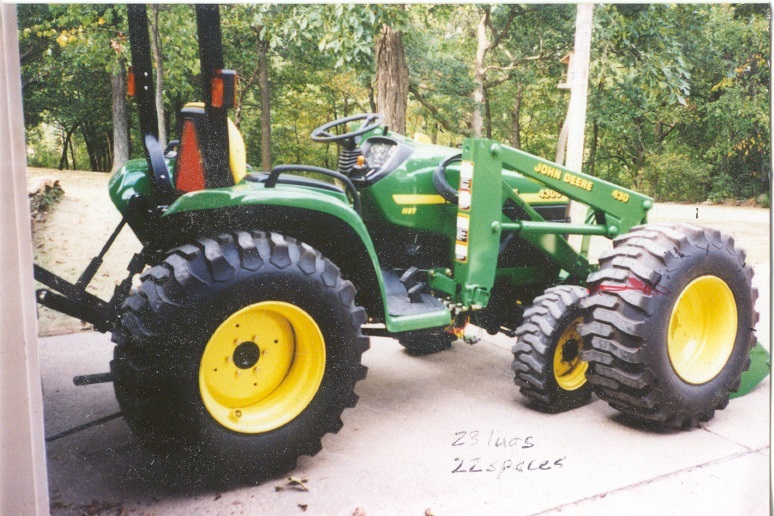

The times I've needed to remove/remount the loaded rear tires on the 4300 have not been much of a problem. R-4's balance pretty good and moving them about enough to line up the bolts doesn't take much as I recall. Sure not worth dealing with grease or special pointed pins.
Get one started and the others are pretty easy to move into place. Do it with one bottle jack or floor jack.
