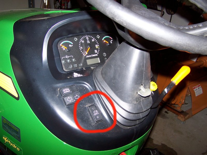

I have a 2008, 3320 and can not figure out how to shut the load match off. The manual says to use the switch to shut it off but there is no switch where the manual shows. Just a place for the switch. I have read that the 08s did not have a switch and you had to turn it on and off some other way. My selling dealer is clueless on how to turn it off. The digital display says loader on when going through start up. The problem I am having is I want to be able to go down the road in high range and hot have the tractor slow down and engine RPMs go up. Any ideas?
When you buy the automotive cruse control does the Load Match switch come with that kit?

Do you have this switch?

Mine's an '05, and it had the Loadmatch when I bought it. The switch was in the same place as Killer_B's pic shows. When I added the automotive cruise there was a loadmatch switch included, that I obviously didn't have to use.
I wonder if you turn the LM off, will your machine's engine slow down (ie start to stall) as well as the tractor slow down, when you hit a bit of an uphill grade?? Are you wanting to control the RPM's manually??

The 08 tractors do not have the switch. I talked to the dealer again this morning and he THINKS I need to buy the auto cruse kit be able to switch the load match off. He is not sure and said he would check some more.
I do want to be able to control the engine rpms manually such as road speed or field work. You can't lug the engine the way it is now. I havn't tried pulling my disc yet but I can almost tell you how that will go before even trying.

Dan, I just looked through my manual, 08 Model 3320 and there is no mention of a function w/o the LM switch to turn it off. I went and tried my tractor using the selector switch and I could not find a way to turn it off.
So, I guess you have to have the LM switch to perform this function.

My manual (September 08 build) tells how to do it with the display switch. I don't have the book here, but you can turn it on and off that way. Your dealer can give you the steps if it is not in your book.

Using LoadMatch (eHydro)
LoadMatch enables the operator to prevent the engine stalling during heavy load applications such as operating with a loader. This feature is turned on and off using the display mode switch
1. Turn key switch to ON position.
2. No error codes should be displayed. If any errors are displayed, activate the display mode switch (A) to acknowledge the error.
3. Press and hold the display mode switch (A) until the display reads 途ELEAS?
4. The last edited command will display, either Coast or Load.
5. If Load is not displayed, use left or right turn signals to select the Load command.
6. Activate the display mode switch (A) to edit the LoadMatch setting.
7. The LCD (B) will display the last setting for LoadMatch, either On or Off.
8. Activate the left or right turn signals (C) to turn LoadMatch On or Off.
9. When the desired setting is displayed, activate the display mode switch (A) to store the setting.
10. The LCD (B) will flash the entered command twice and then change to the normal mode.
I think I will spring for the Automotive cruse kit because I will never remember all of this. Why couldn't they have left well enough alone.
