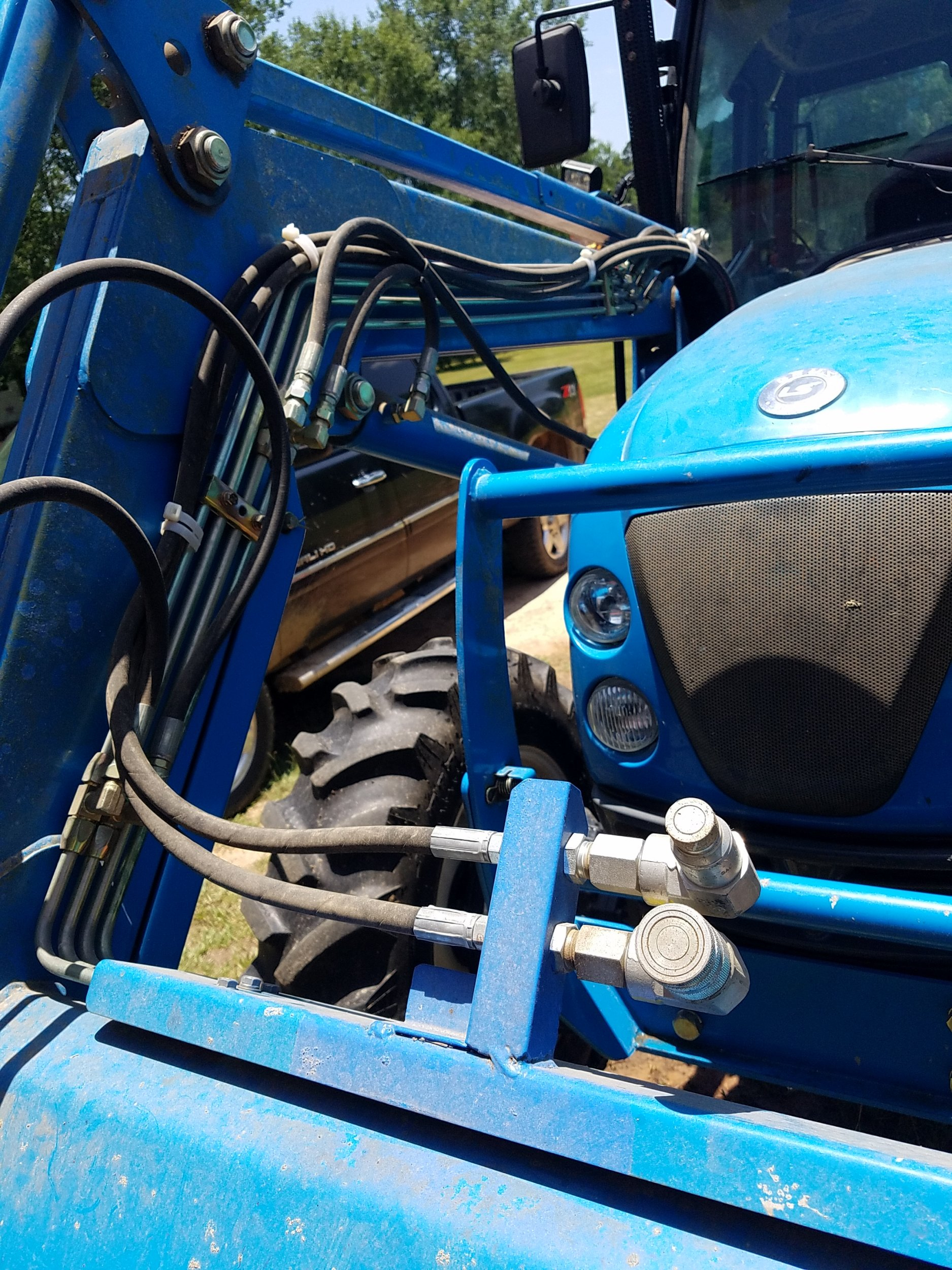

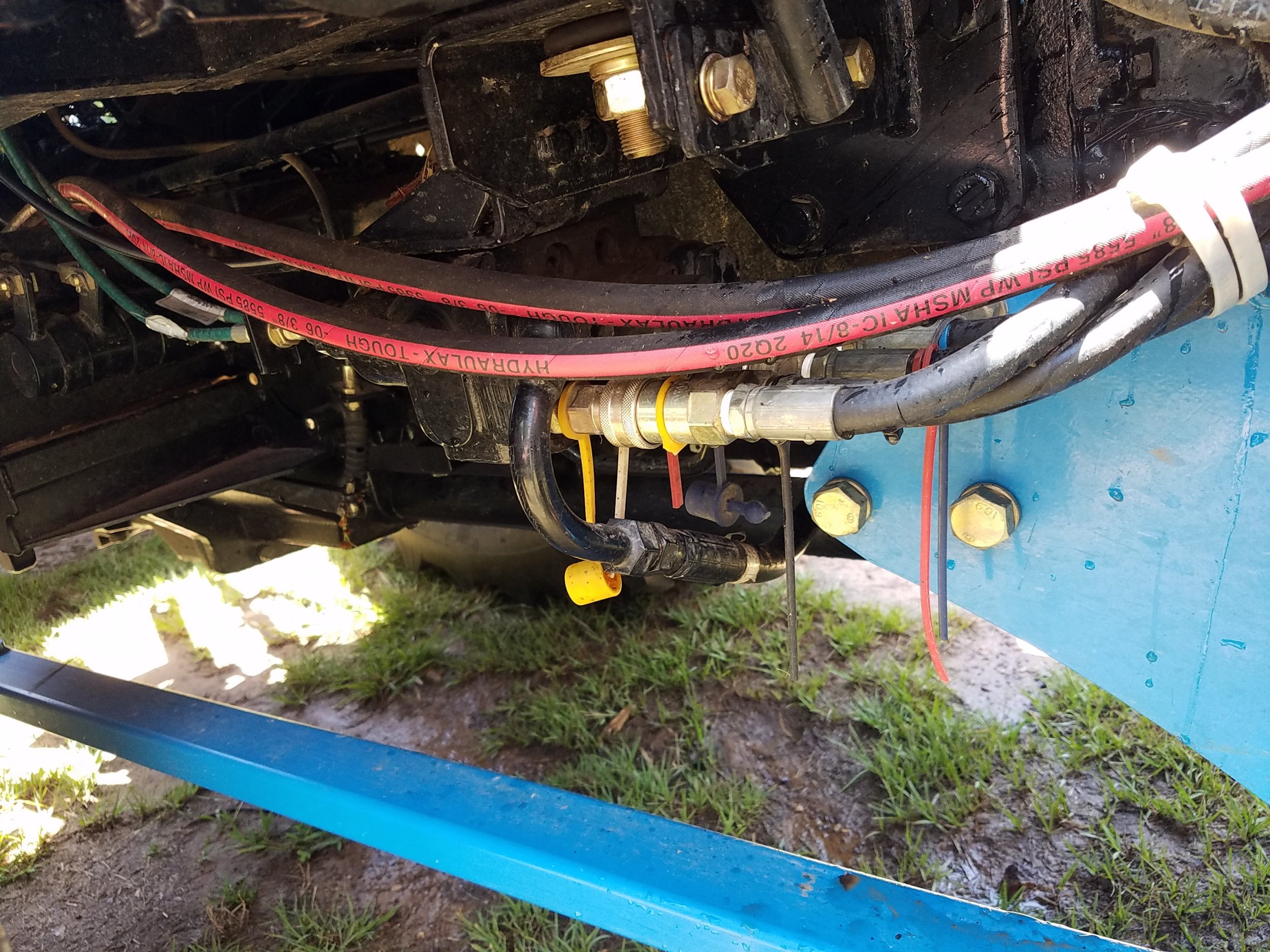

I have a 72" brush grapple with pinchers (like a crab or crawfish).
Added these several years ago. When you have 3 remotes, you do not have to add a 3rd function to your loader.
Skidsteer hydraulic connectors came with grapple (1 pair). My father bought one too. He wanted to use pioneer ag style connectors. Bought him a set and he gave me his skid steer connectors. Ordered custom 3/8" hoses from Discount Hydraulic Hose much cheaper than local shops.
Added perk, cannot borrow my grapple unless it is set up for skid steer hydraulic fittings! Told neighbor he could use it. But couldn't use it due to he had ag connectors.

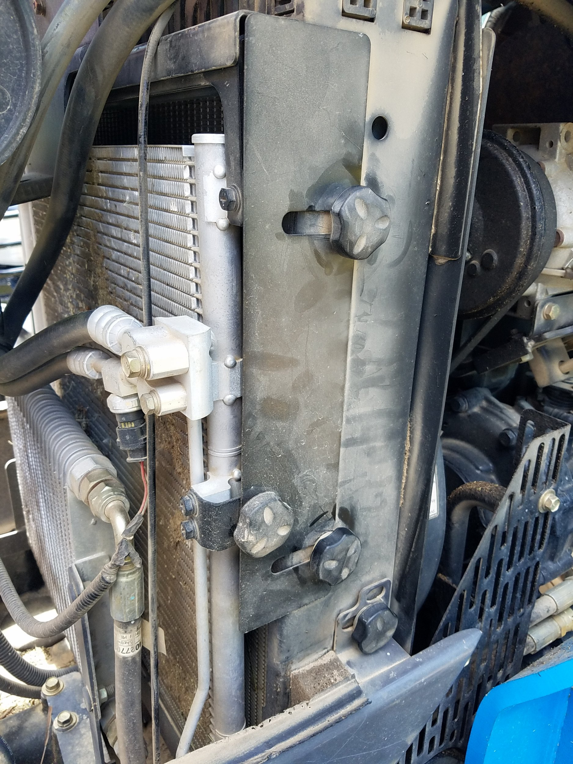

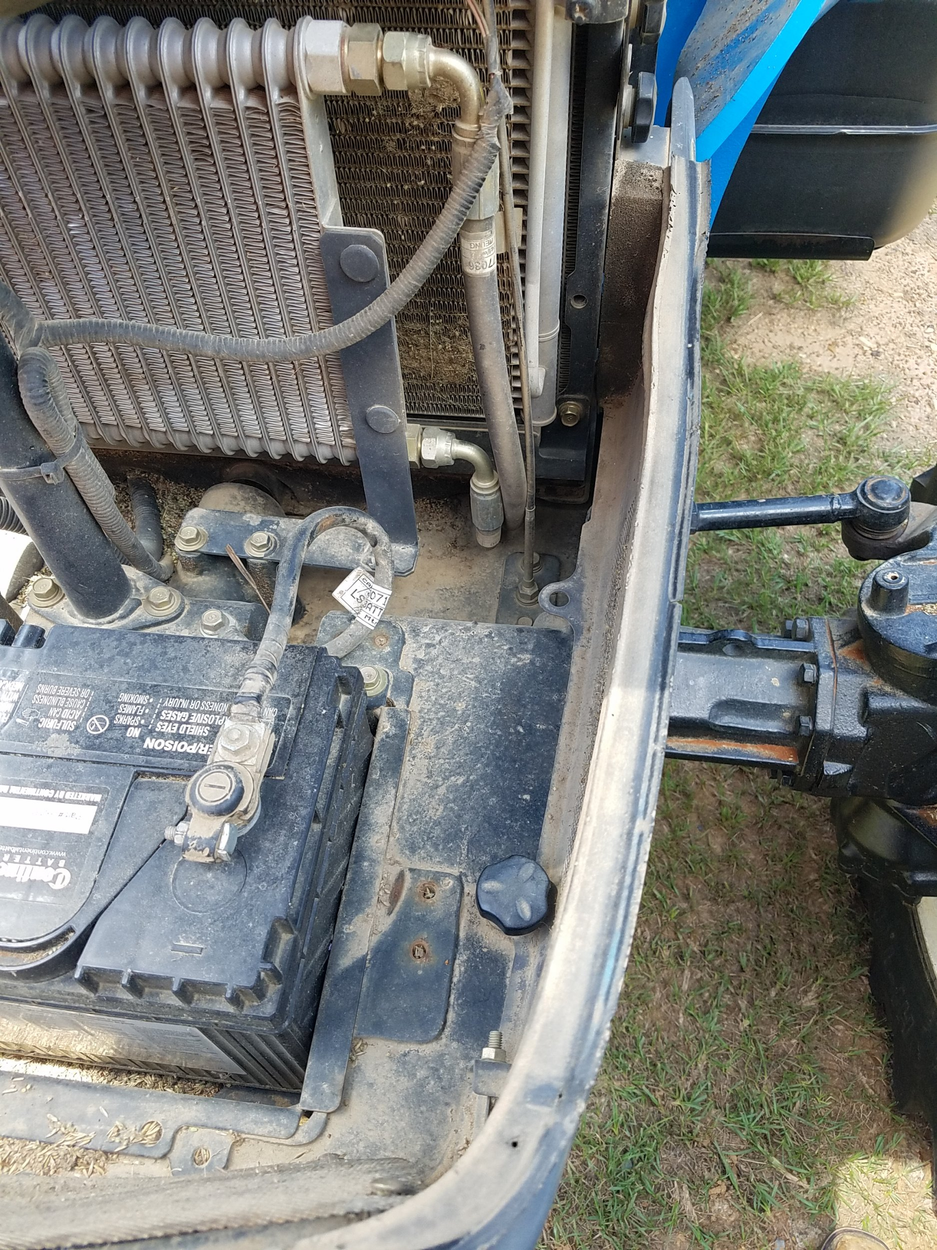

How to clean oil cooler, ac condenser and radiator on a P7010C.
Fold grill guard forward and open hood. Locate the 4 hand bolts that secure lower body.
Next remove 1 hand bolt holding condenser and loosen other 2. Slide plate out of the way. Unhook pressure switch harness.

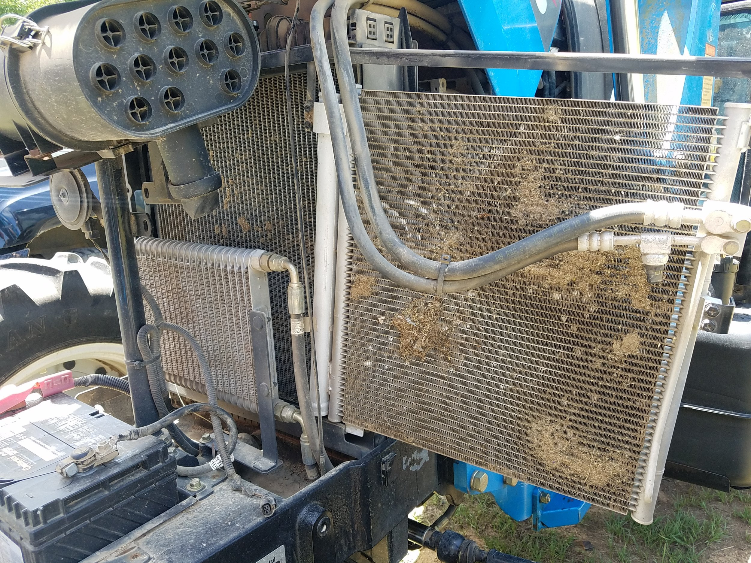

Now slide condenser out of the way. Can access everything. I just use a garden hose with water. Be careful if you have high water pressure. It can fold fins.
Ready to go!

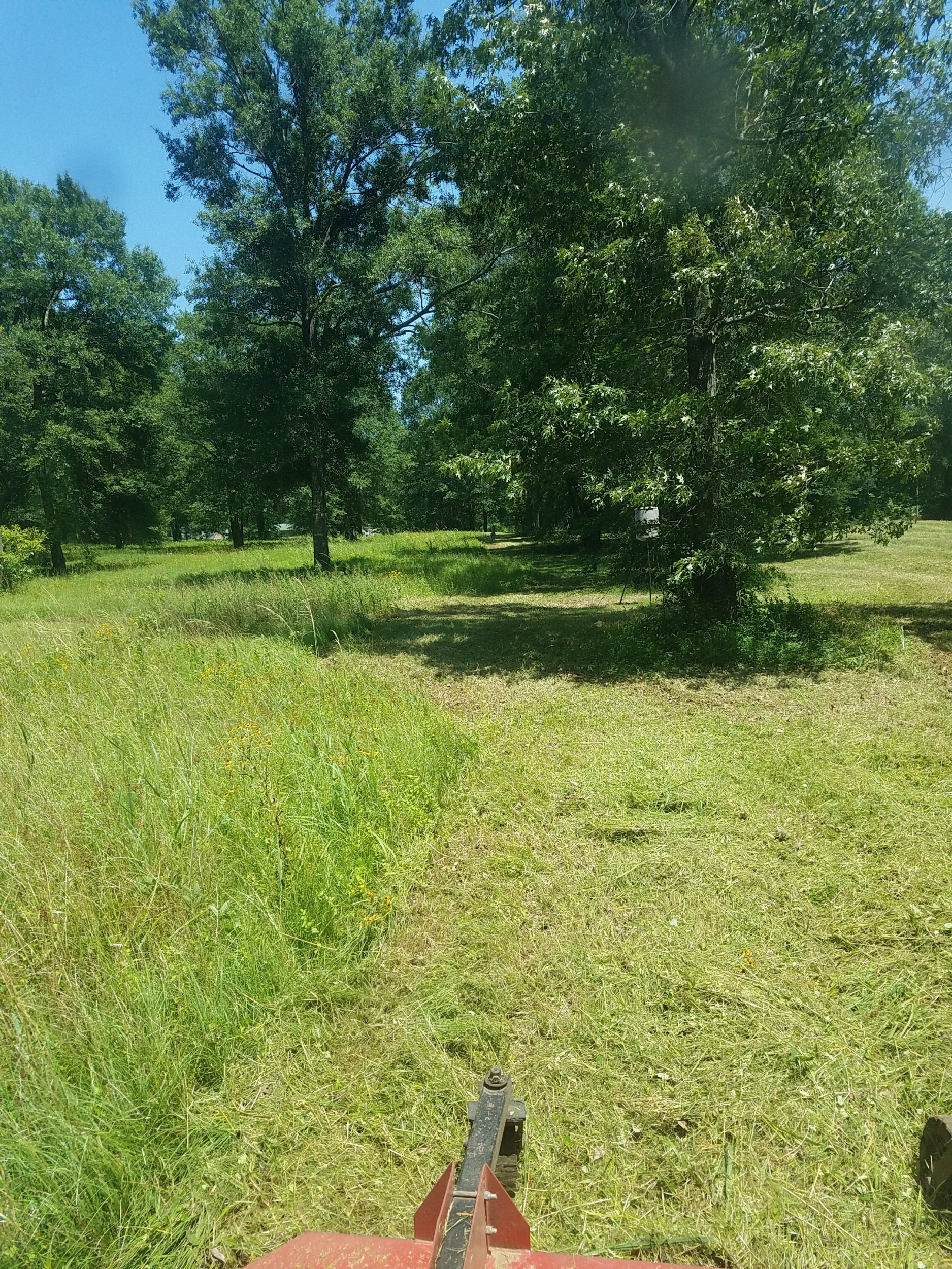

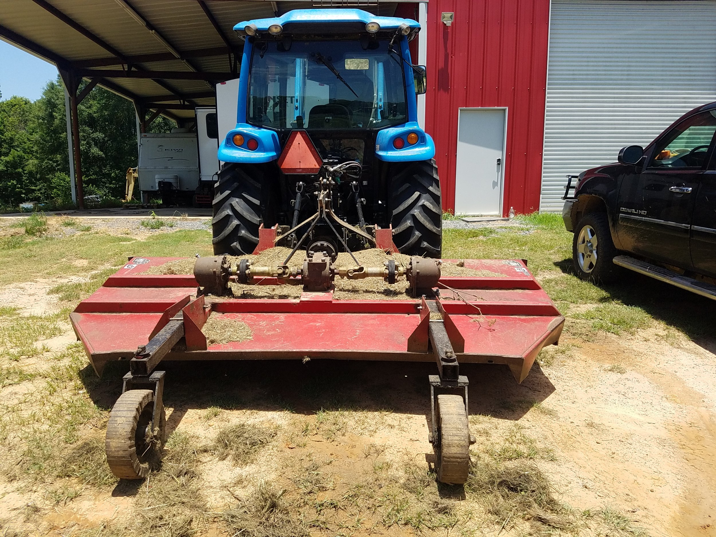

Kodiak 10' HD cutter. American made.
Old blades. Will put new blades on before next cut. These have found some concrete. Have edged them a few times.
