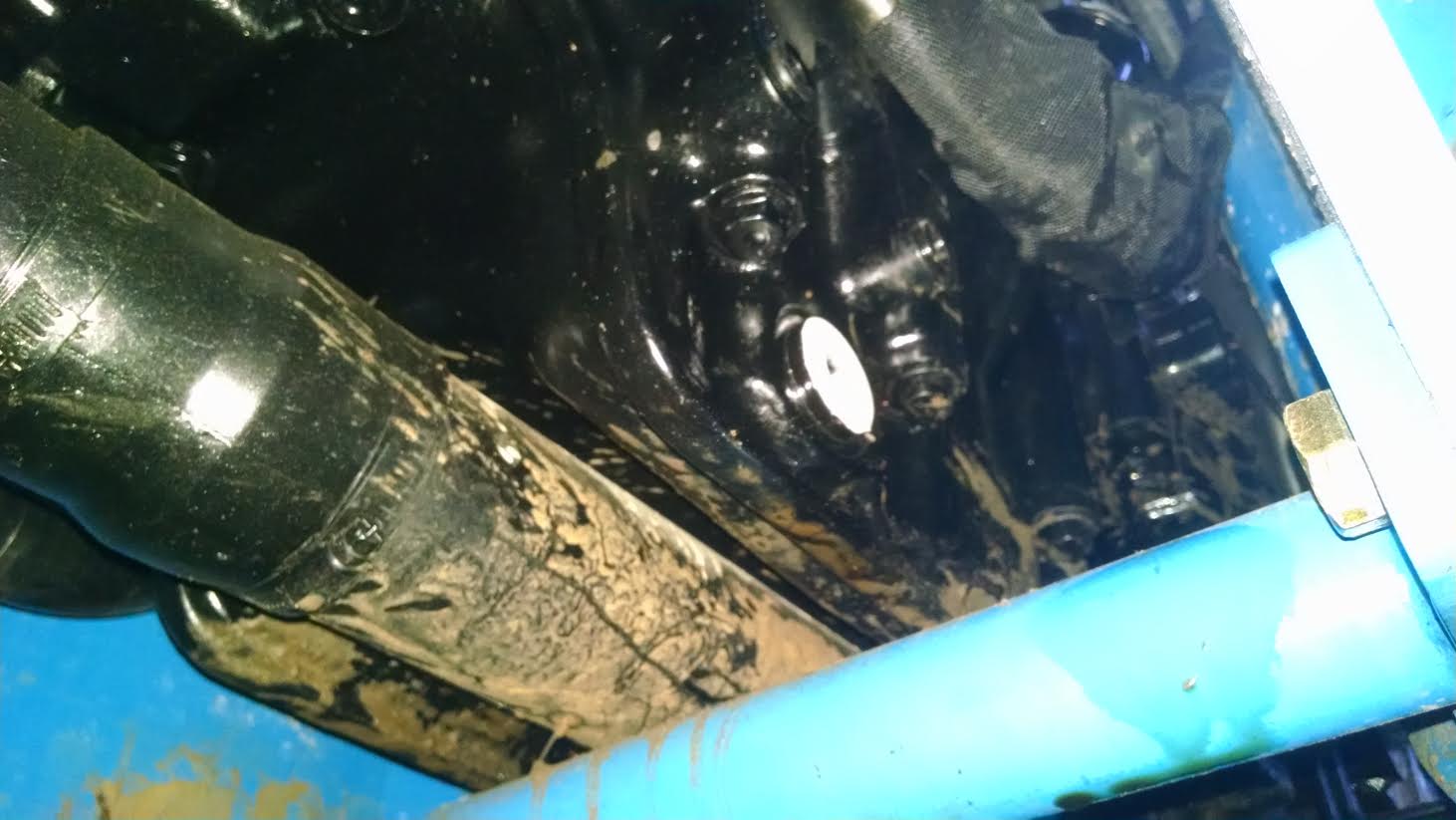

Well, today I performed my 50hr service... Well part of it, at 58 hrs. Since its still so freaking wet I cannot bush hog, I figured I'll get ready for the new season to use my LS P7010C. Here is the oil change procedure.
First you need a 12mm allen wrench or socket to get the drain plugs out. It has one on each side of the oil pan. I did notice that all drain and fill points are marked with white paint. Nice.

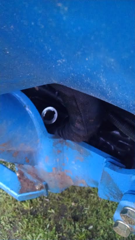

Here is the location of the oil fill. Its tight!

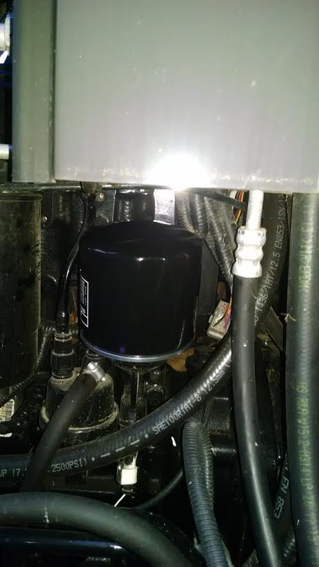

Filter change is tight too. It doesn't show well, but there is a wiring harness and fuel line very close to the filter. Makes getting a filter wrench on interesting.

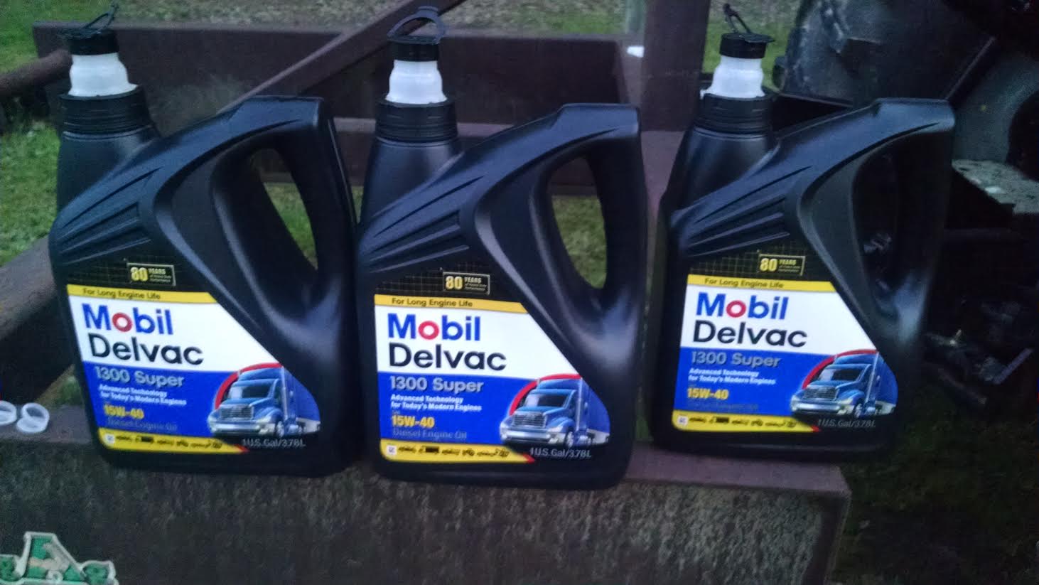

Oil of choice. Mobil Delvac 1300 Super 15W-40... Not really, just on sale at O'Rileys! $12.99/gallon. Requires 2.3 gallons, (about 9 quarts)... Dang metric system.

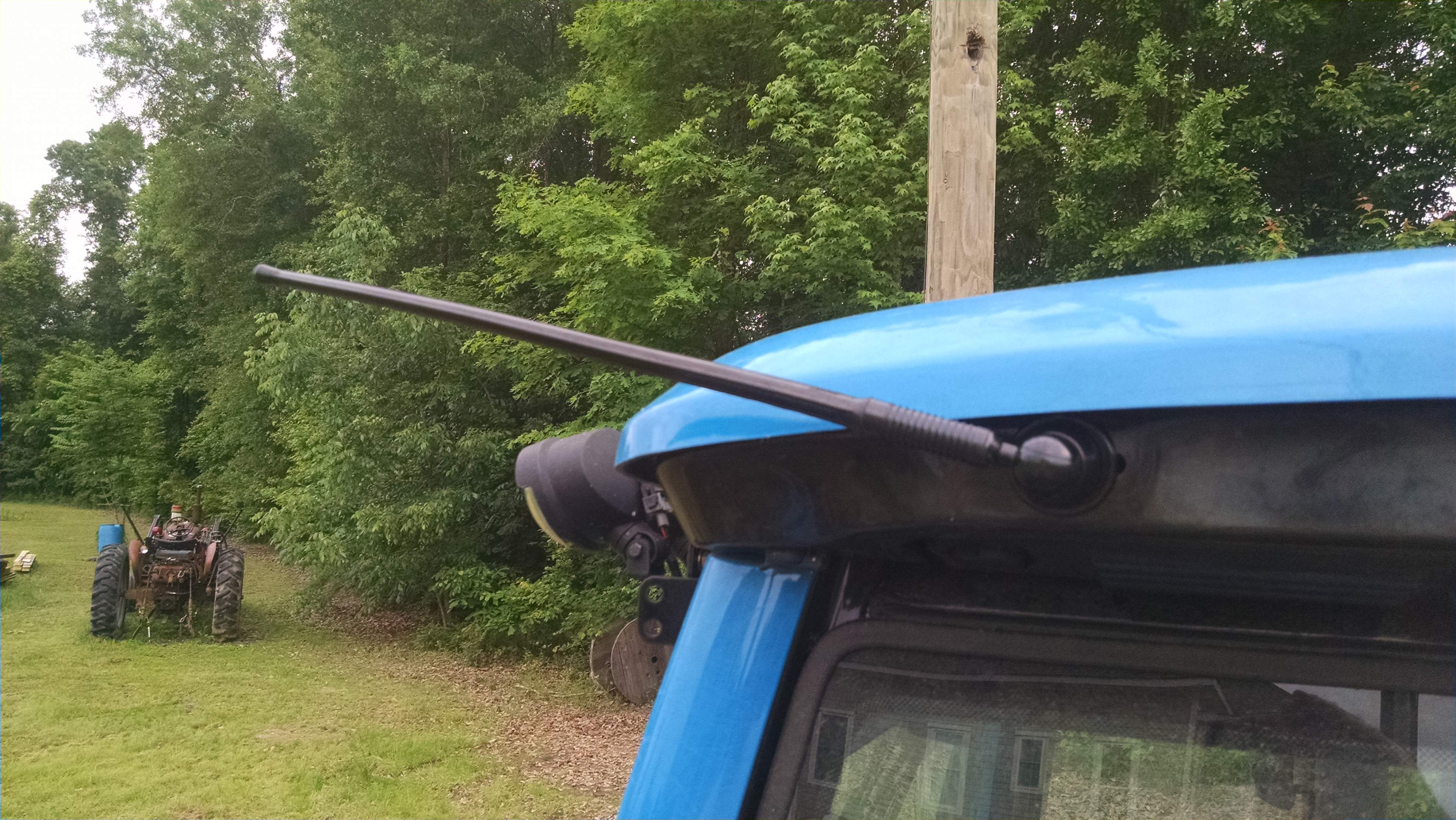

Well I cannot use my P7010C yet, still very wet. I don't want to rut up the fields. So, I decided to replace the radio antenna that I managed to break off at about 6 hours on a tree limb.
This is what was left of the OEM antenna.

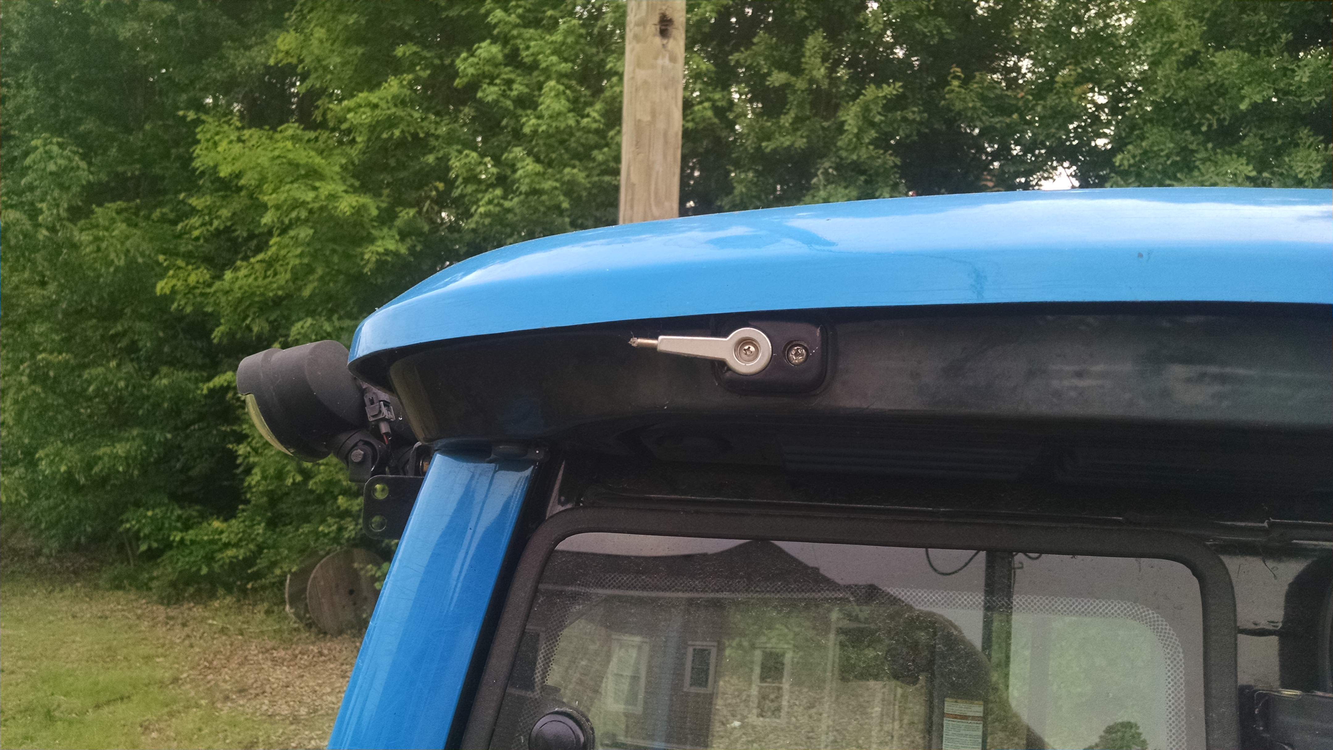

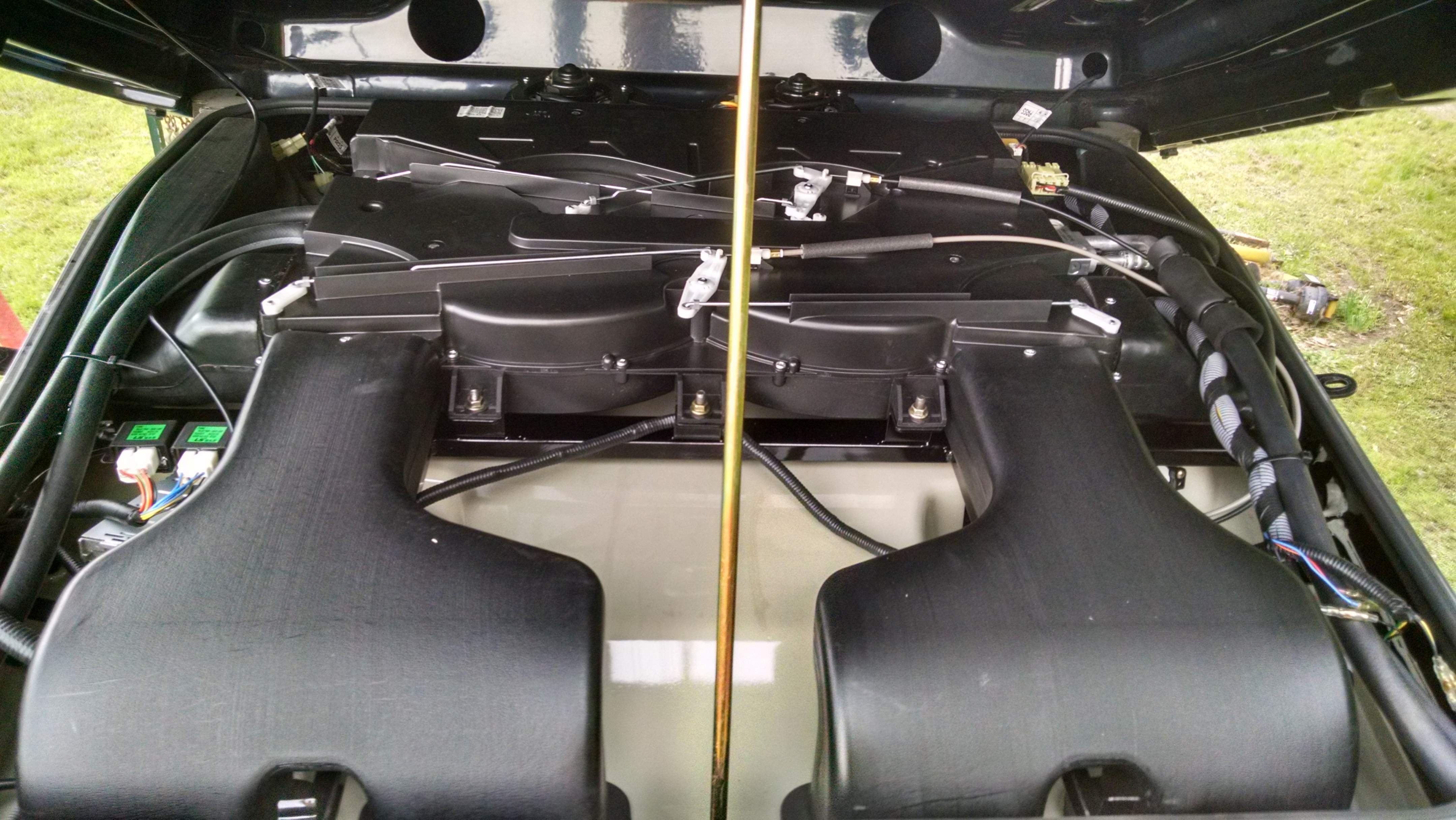

So I figured out how to open the roof to access the antenna. Remove 4 nuts and unplug the front cab work lights, raises right up. It even had a prop rod stowed inside!

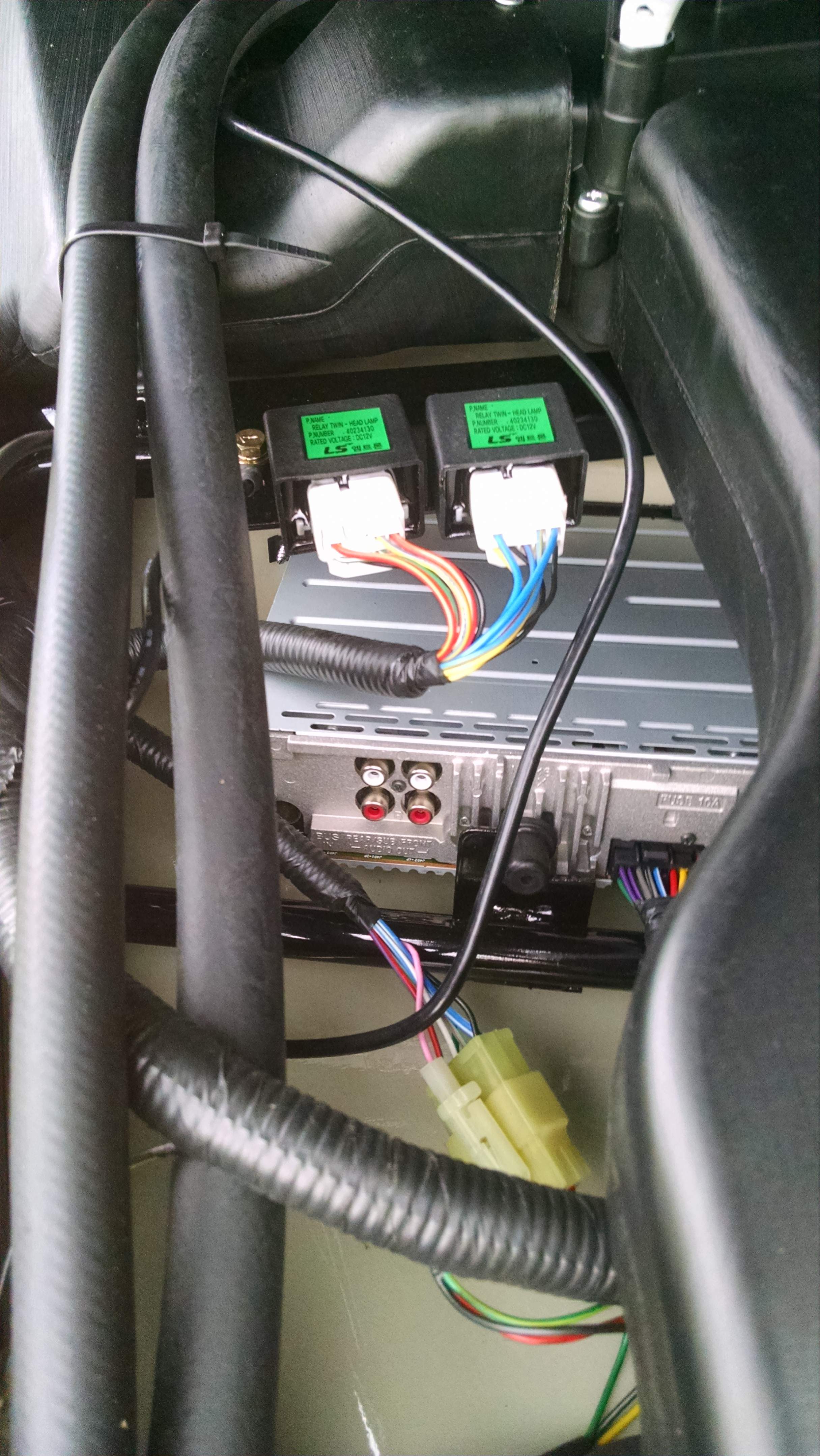

Back of the radio.

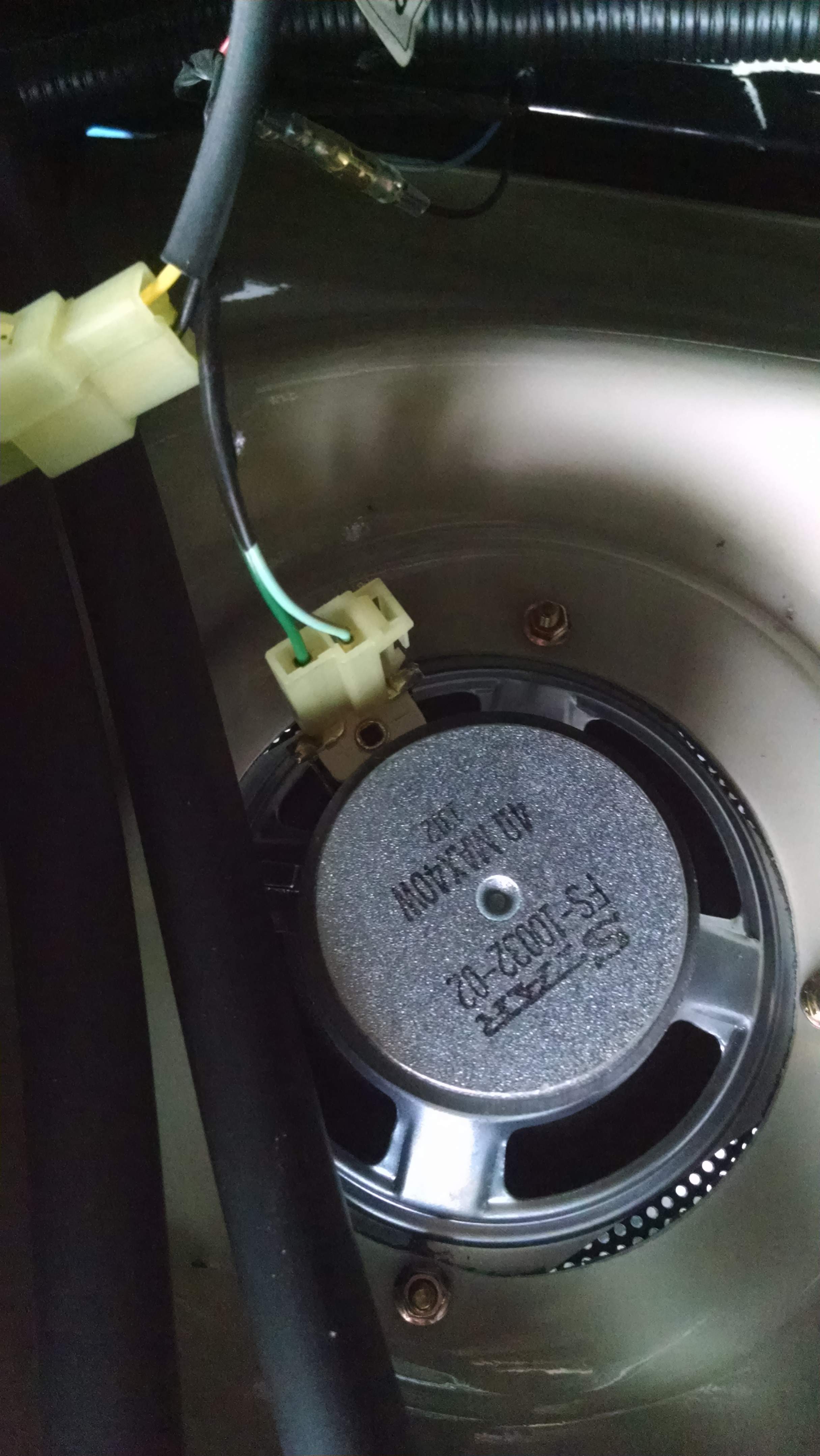

Cheap OEM speakers, I will replace the later with coaxial or triaxial speakers later. May even add a small powered sub behind the seat.

New antenna installed and roof secured. The OEM replacement was $50-$60... WHAT!?!? :shocked: These LS OEM parts are insanely expensive. Found this antenna on Amazon for about $10. I positioned it facing rearward (like the OEM) to minimize snagging on limbs. Just have to remember to be aware when backing up! This antenna is about 15" long. The OEM was about 6" or 8".

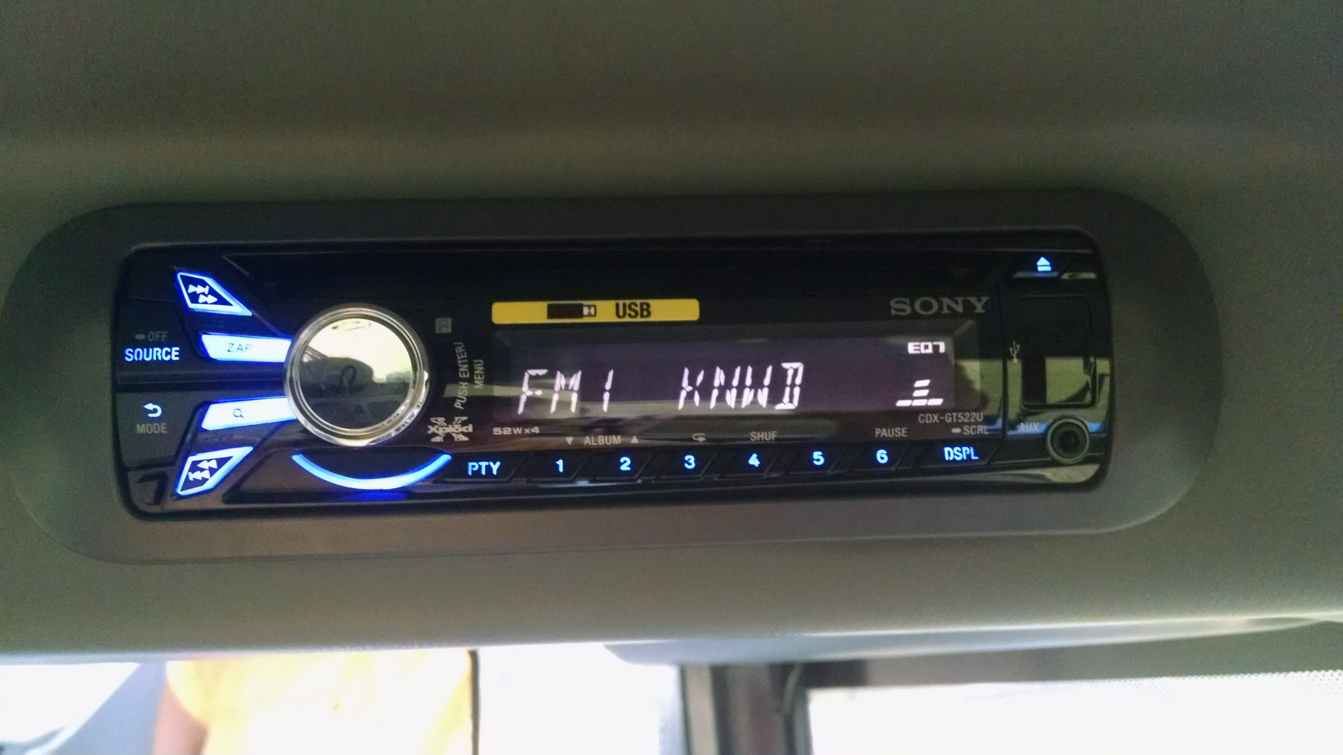

This antenna seems to actually be better than the OEM. I could even tune into the University's low powered radio station (250 watts I believe).
