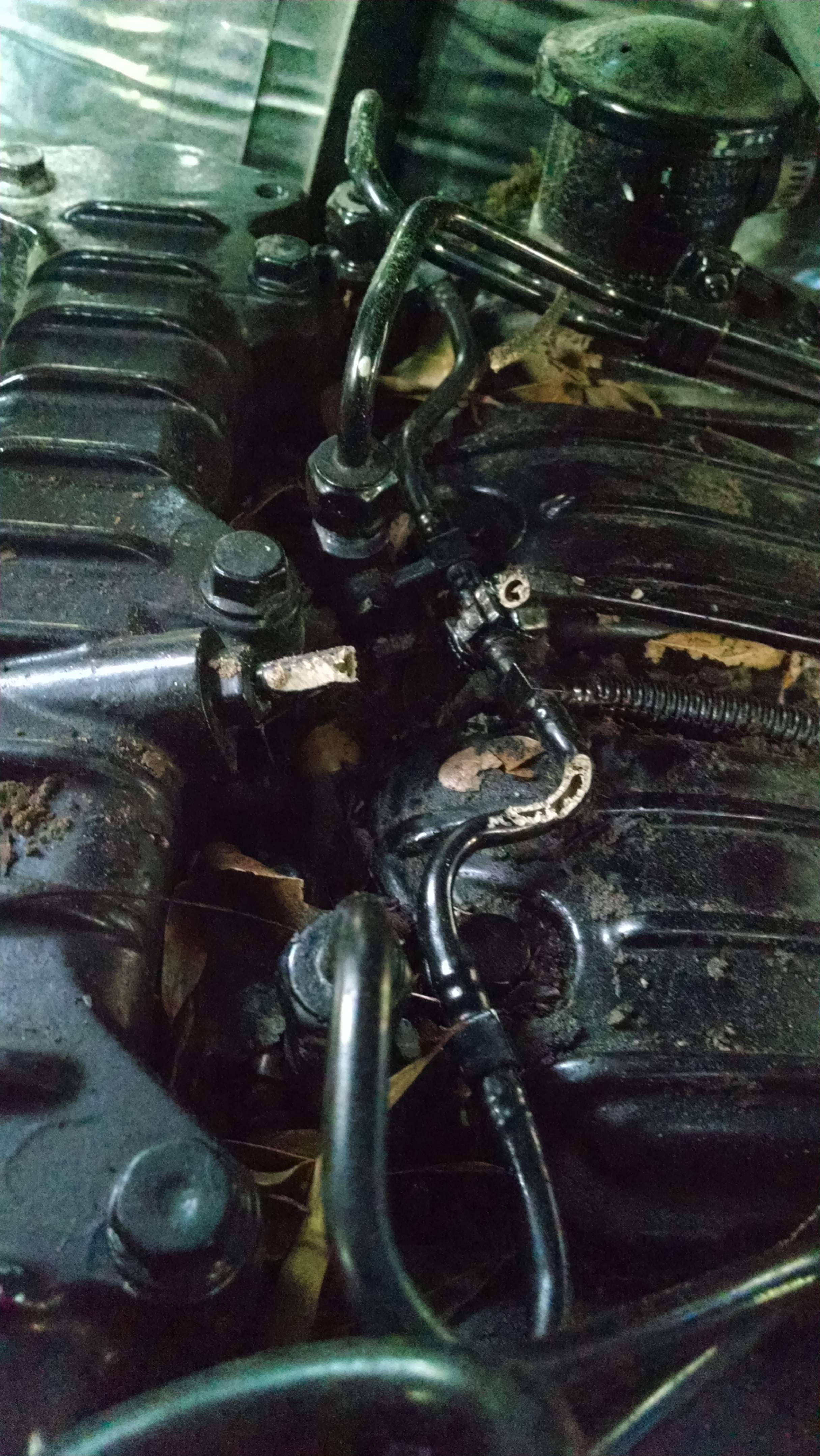

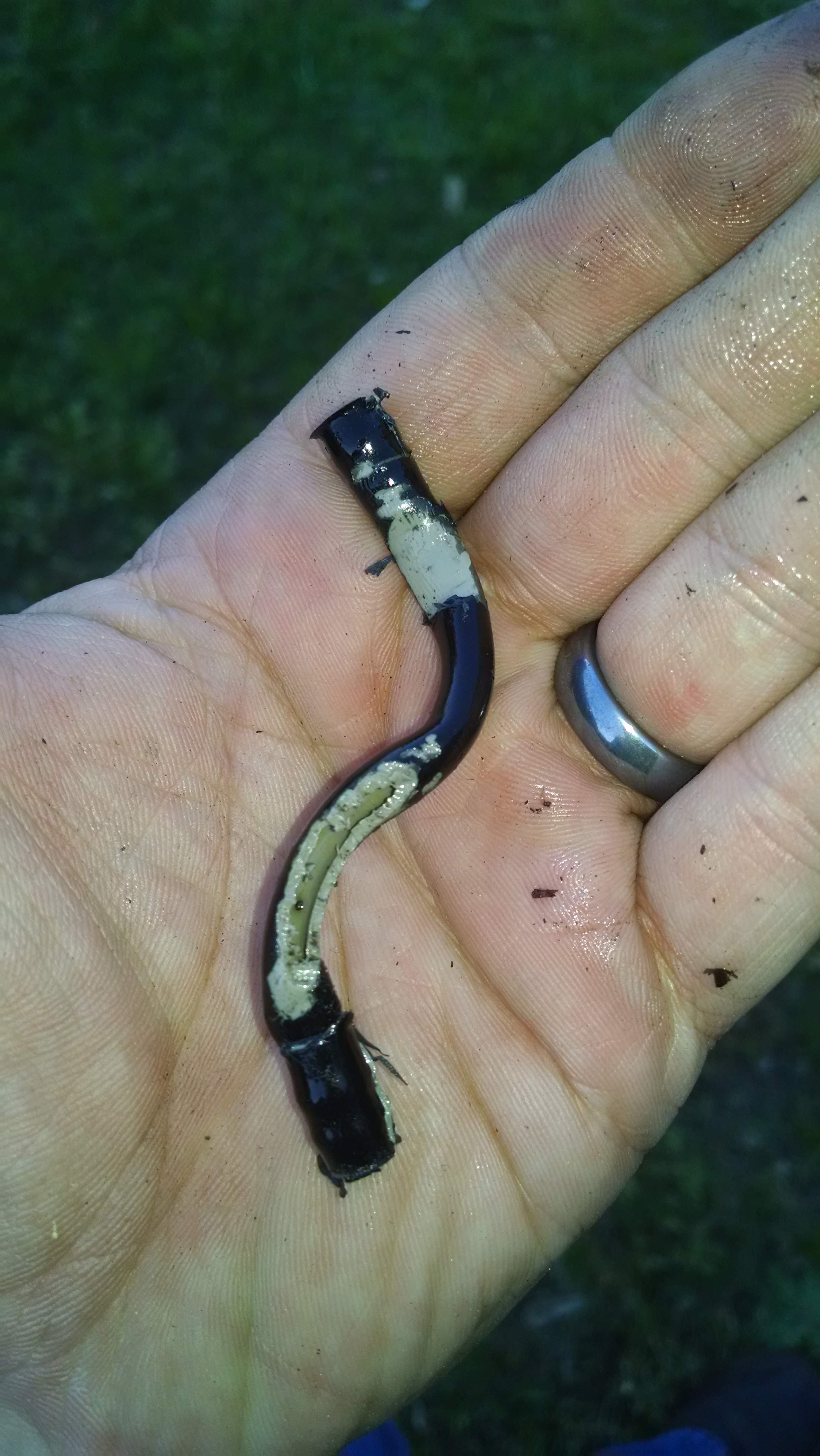

@ breadtrk, I agree. I am in search of some cats... I never thought I would actually ever say that, but I am. They are actually pretty effective I'm told.
@ underdog57, get busy! I would think it would be even worse in the north. I would have never dreamed that they would set up camp under the hood... And it don't take long for them to cause machine debilitating damage.
