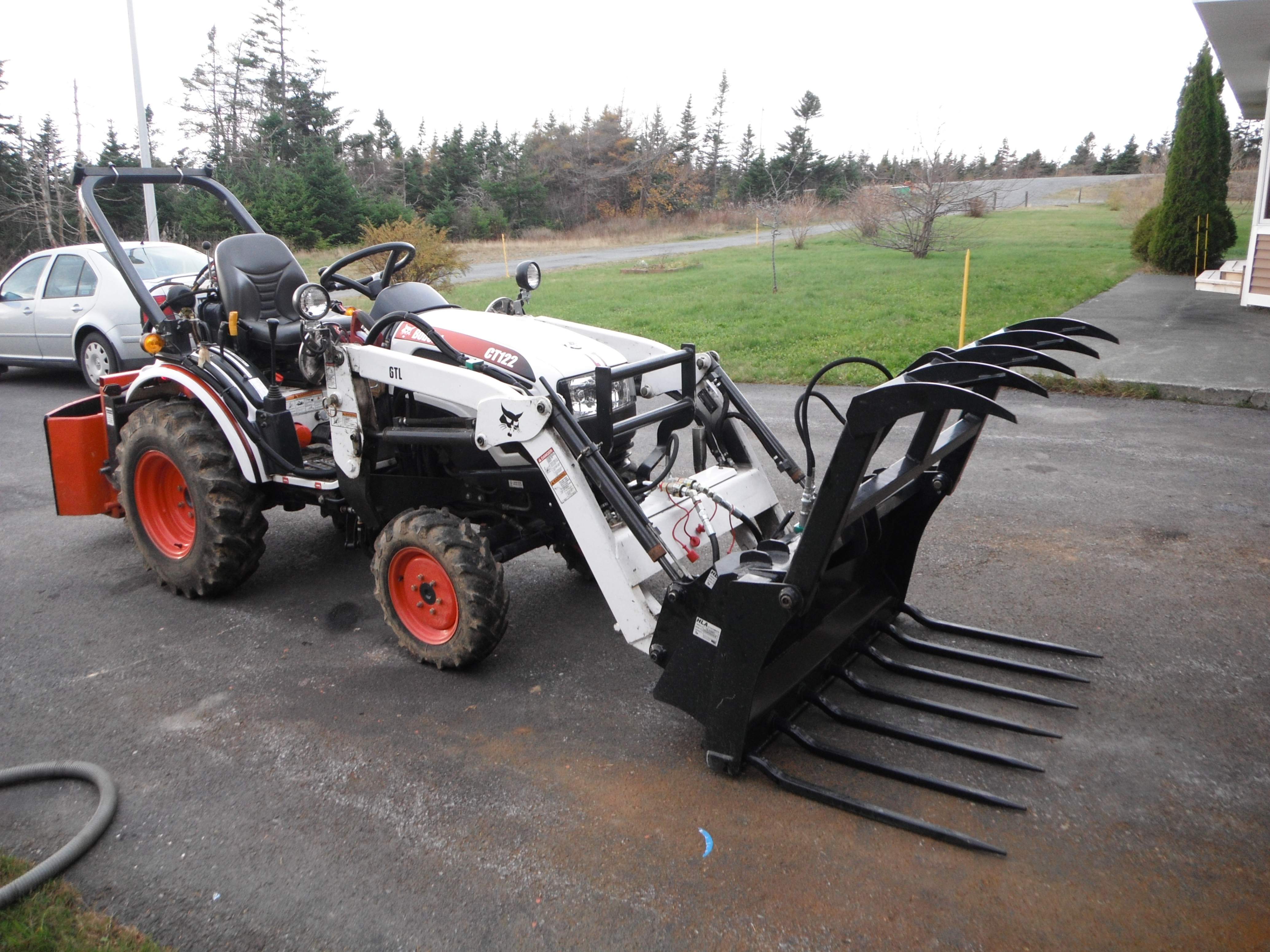

Linear Actuator for ct120 grapple

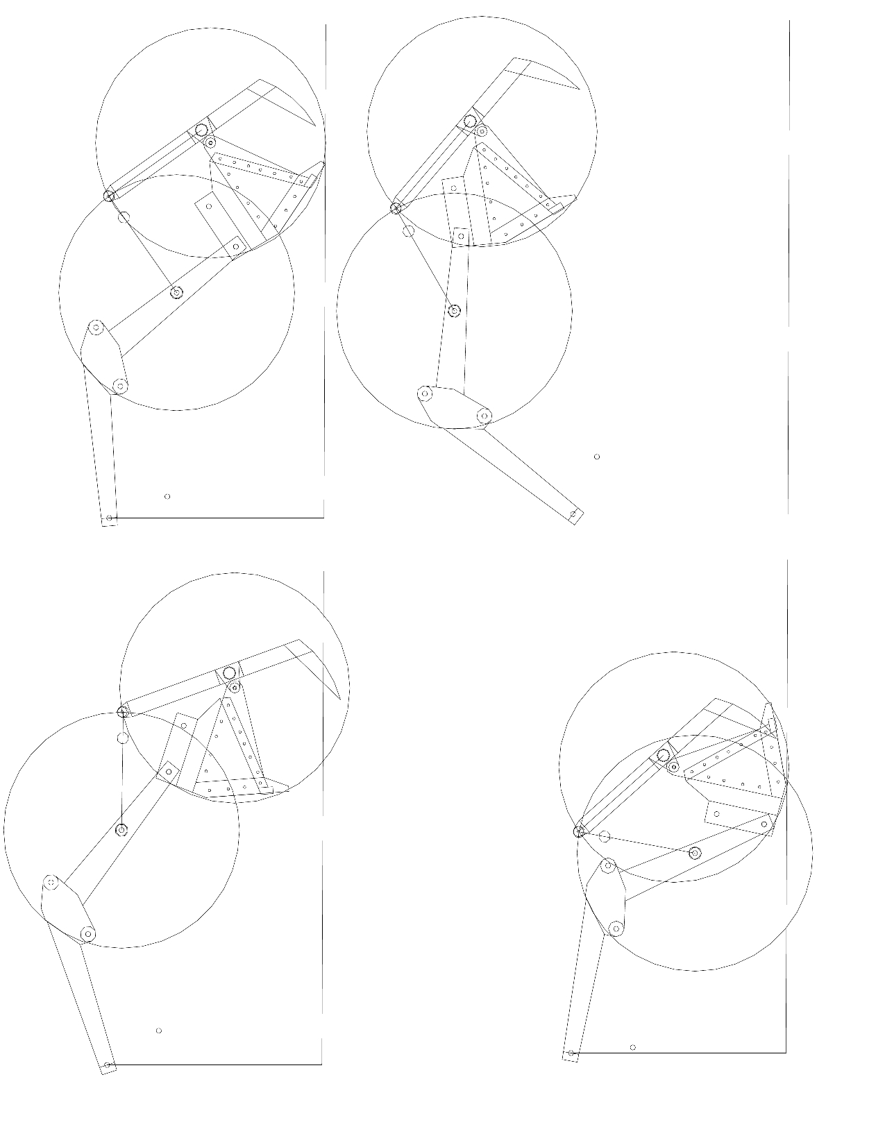

There was a thread about a mechanical closing bucket and grapple that was done by clever use of linkages that the bucket closed against the grapple as it curled back. I can't find it now.
I saved the drawings, with his member name, in my "Project Ideas" file, so did a search on his "Started Threads" and found it: http://www.tractorbynet.com/forums/build-yourself/353078-heavy-duty-mechanical-grapple-little.html

If I recall correctly you lose the normal curl function if you rig such a grapple closing device. Given the complexity and limitation I don't see it as a particularly viable option. Not that big a deal to rig up some rear remotes and just use those to control a grapple.

4) I have a tractor almost identical to your CT450, the Kioti DK40se. I assure you it can lift more than 1000lbs and move it safely. Photo below shows a granite boulder that by volume weighed between 2000-2500lbs. I didn't try to lift it higher than seen in the photo and I lowered it almost to the ground before moving it. I used a BH for ballast. The rear felt light but as I was only moving 100 feet or so to the side of the field I just moved slowly and finished the job. I didn't see whether I could lift it higher as I had no reason to but I'm pretty sure I was about maxed out on lift and recognized it would be stupid to raise the tractor center of gravity unnecessarily when lifting such a load.
5) DK40 also lifted a 7ft section of Jersey barrier at about 400lbs per foot =about 2800lbs. I didn't try to lift it higher than I needed to to move it several hundred yards across a field. I recall I only had a flail mower as ballast.
6) To get back to the OP's situation, he has a CT120 which I believe has just about the same lift capacity as a CK20: a bit over 1000lbs to full height at pivot pins. A 48" bucket holds about 1/4 yard so if loaded with sand would weigh about 600-700lbs. I have lifted that much sand to near full height with a CK20 when loading a pickup truck with sand.
Bottom line: The CT120 can certainly lift more than the 400lbs in the bucket estimated by the OP. Just ballast it properly and pay attention to dynamic forces when moving (slowly!).
