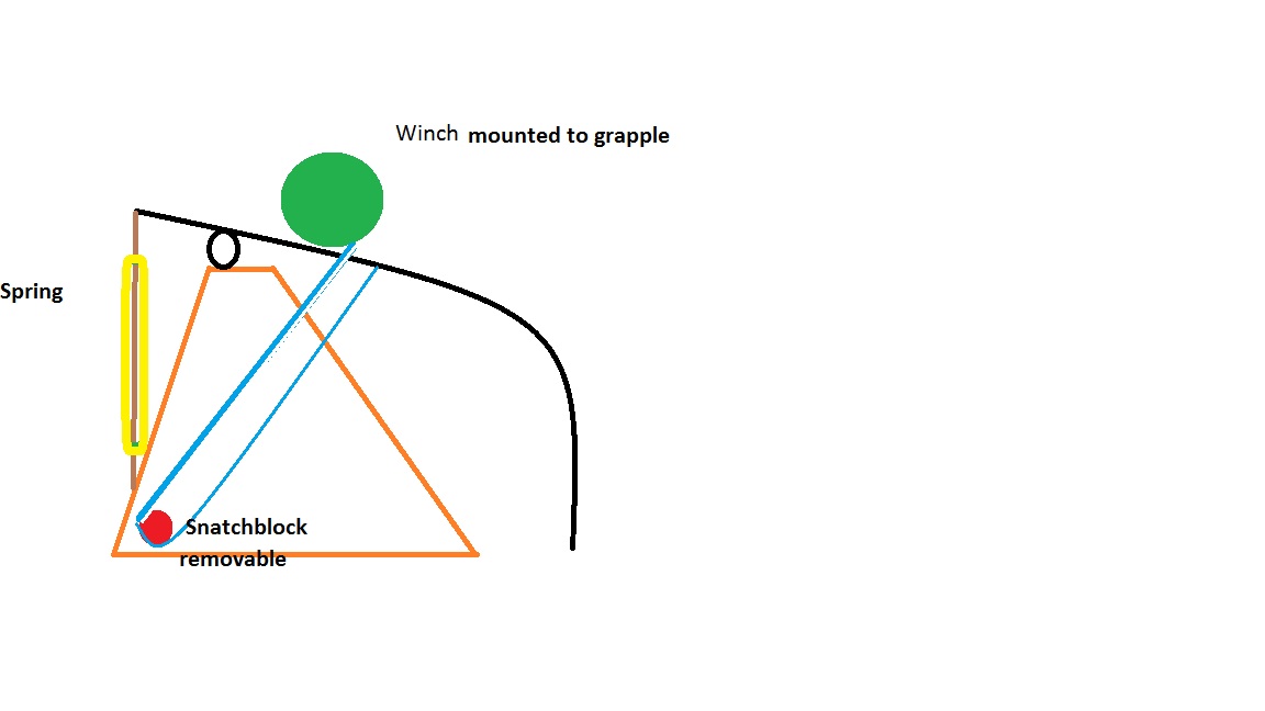

small compressor with tank and pneumatic cylinders? a 1.75" bore cylinder at 100psi with 1:4 ratio will net you 200 lbs and tighten as the load shifts. much easier plumbing and the air might be useful elsewhere on the tractor.
/ Linear Actuator for ct120 grapple #23
Maybe an electric winch could be used to close the grapple and a couple of heavy springs could open it?
I like this idea the best of anything yet. It might be easier to use the springs to close the grapple and the winch to open it.
/ Linear Actuator for ct120 grapple #24
Sounds like you are going to build not a mouse trap but a person trap.
Having the energy of the springs holding the jaws open when someone might be near it is deadly.
I know you don`t intend to allow anyone near it when open but it will happen.

There is the possibility of danger there, but i would feel safe enough around it. There's still the possibility of danger using a spring to open it.
/ Linear Actuator for ct120 grapple #26
There may be advantages of spring open and winch close. Safer not having energy waiting to be released at any moment all the time versus just when clamping something.
Harbor Freight winches are cheap and some even have wireless controllers. Plus in a pinch you could unhook the winch from the thumb and use the winch for other stuff.

The possible problem that I was trying to avoid is the only way I can think of to close the grapple with a winch would be having a cumbersome lever extending out the back of the grapple or run the cable in front of the the thumb which would create problems.
/ Linear Actuator for ct120 grapple #29
This is just one idea that you may find helpful. Removable tines could be added to bottom of bucket. :2cents:

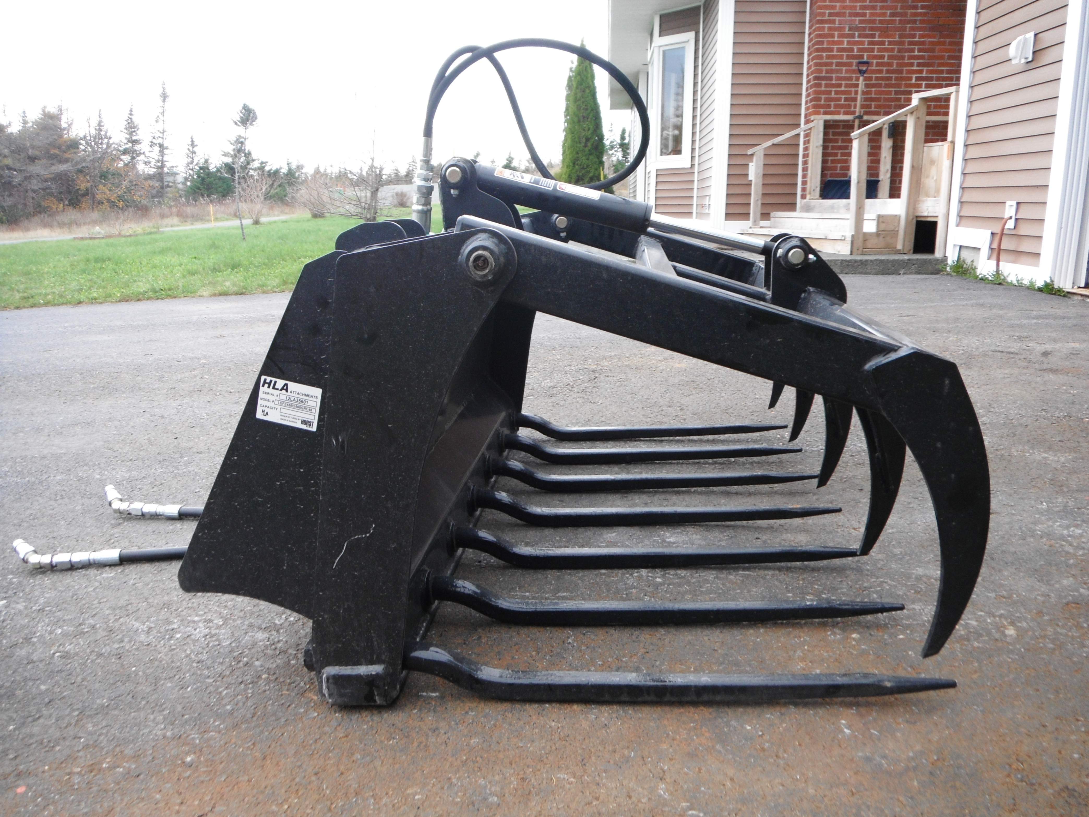

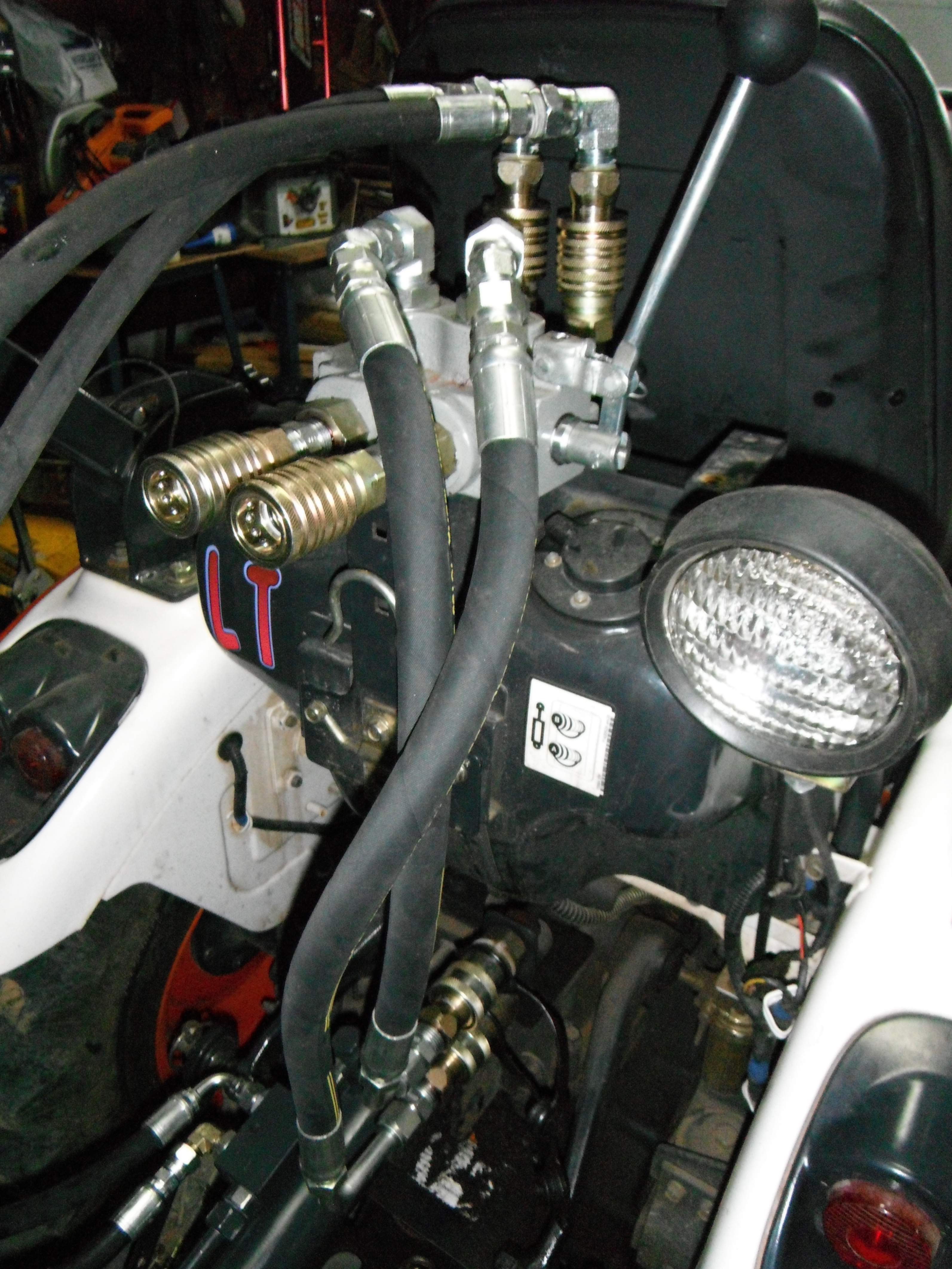

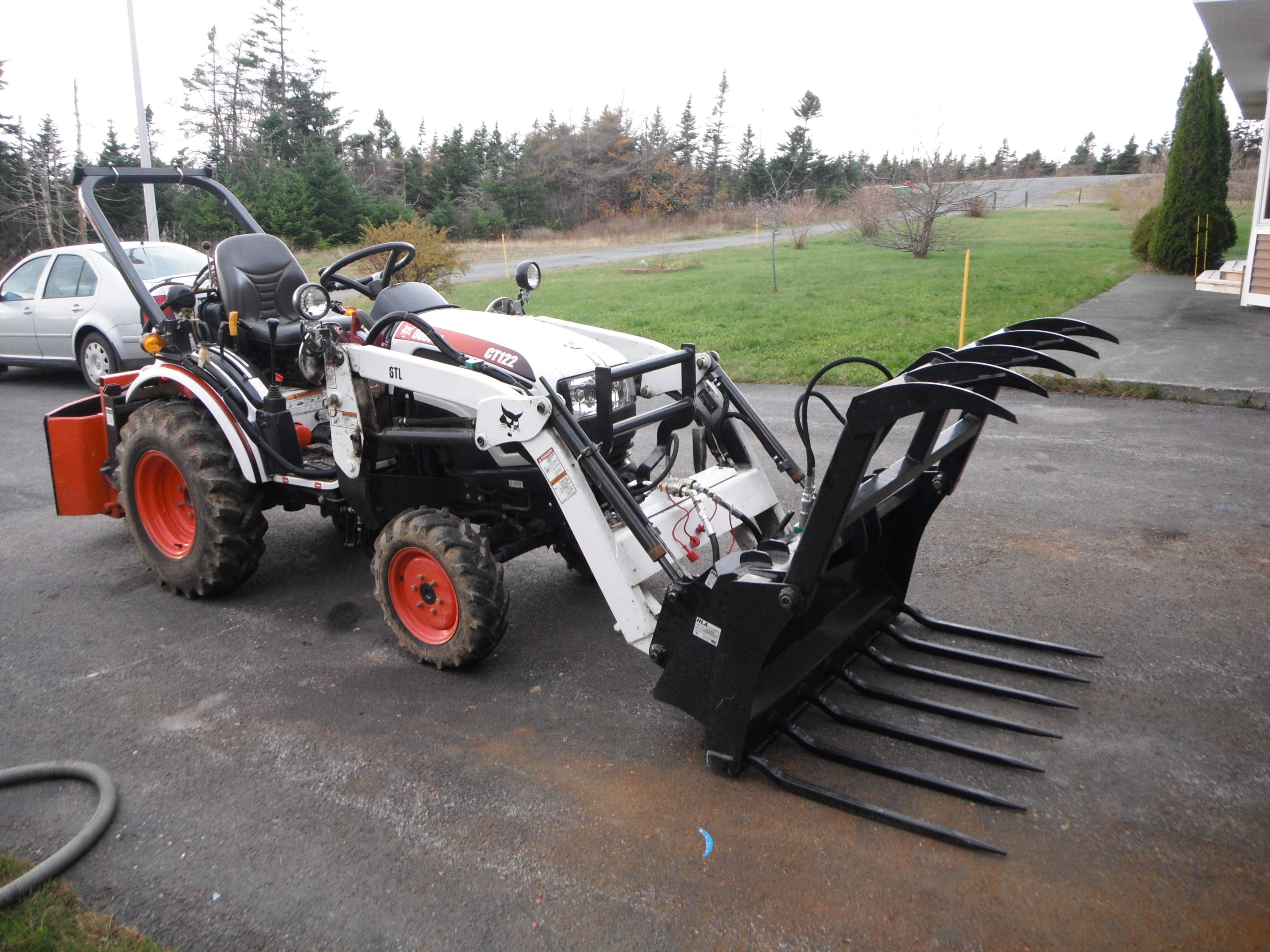

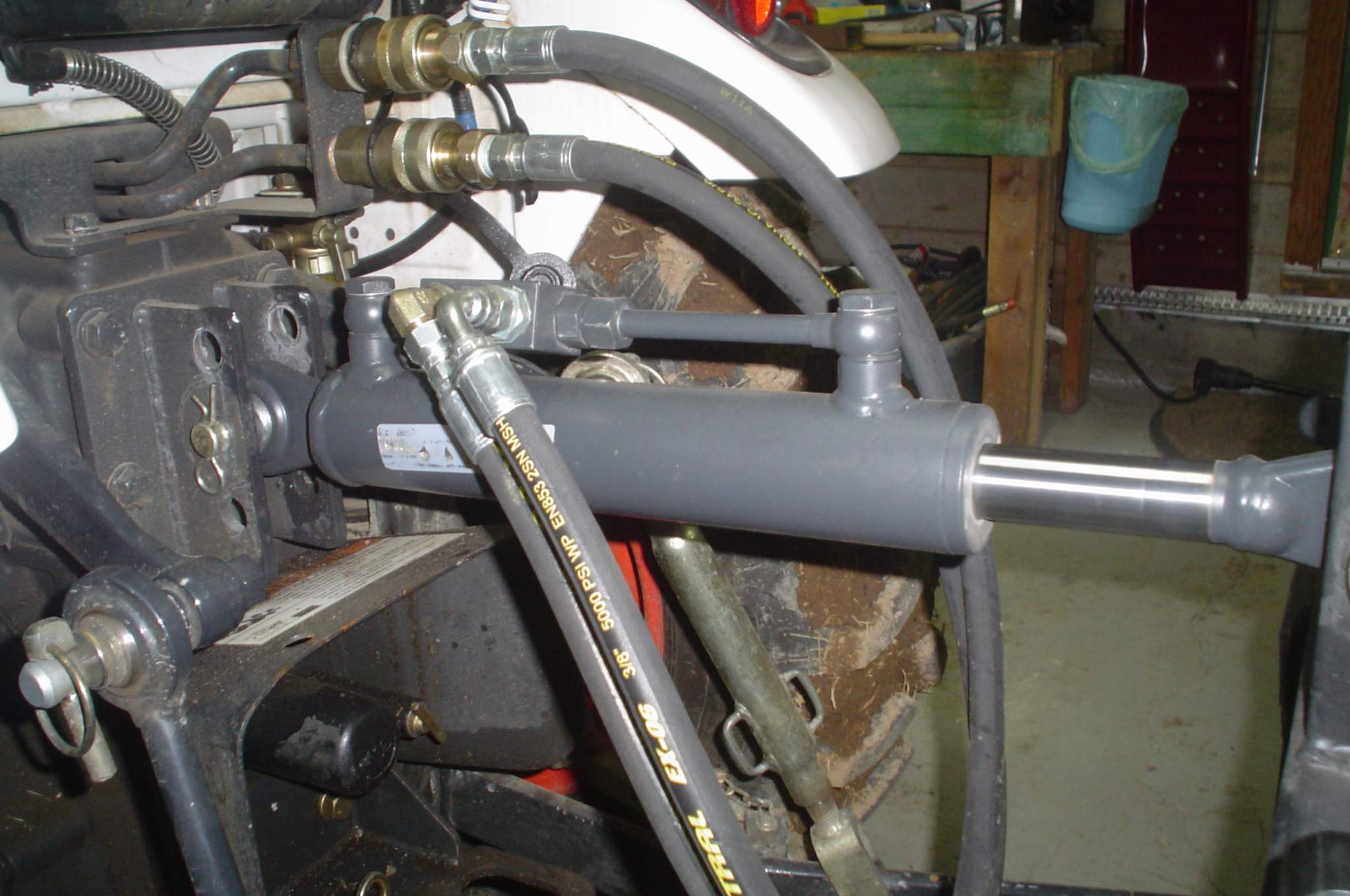

Rear valve ports are the way to go. So much you can do from there.

It's a worthwhile investment in your equipment if you are doing this professionally. Either add a rear port and run a hose to the front or put a diverter valve on the curl function.
My diverter was $100 and another $200 in fittings and hoses. So, $300 all-in.
This grapple would be too big, but maybe a 48" Wicked...
