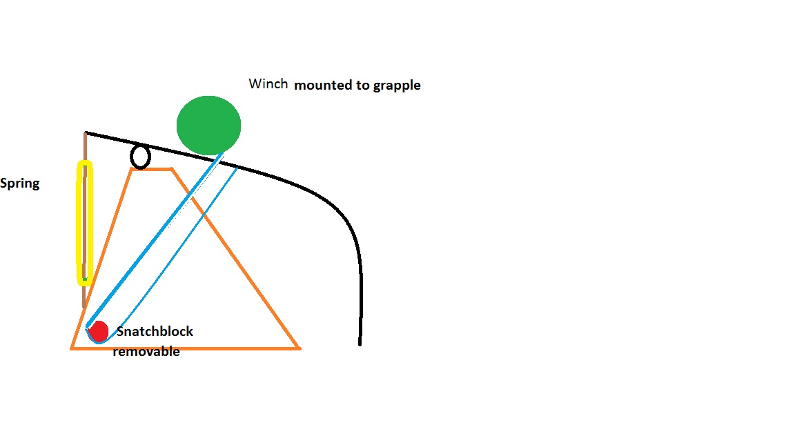

/ Linear Actuator for ct120 grapple #44
My bobcat ct120 can lift about 400 lbs. could a Linear Actuator with a lift force of 200lbs work for a thumb on a bucket. Mostly to hold brush on the bucket for traveling. I don't intend to lift logs with the bucket tilted down position.
Putting a diverter valve in seems like a lot of work money. I don't know anyone who can put one in and frankly I don't want to.
I found one for $58 and I'm going to see what it can do. It has. 12" travel I hope it's enough.

I put a diverter valve from KennyDs on my loader arm in order to run my grapple from EA. All in with making new lines kinda expensively at the local parts store, I was under 500 bucks.
I think the winch with springs and linear actuator aren't going to be robust enough.
There was a thread about a mechanical closing bucket and grapple that was done by clever use of linkages that the bucket closed against the grapple as it curled back. I can't find it now.
