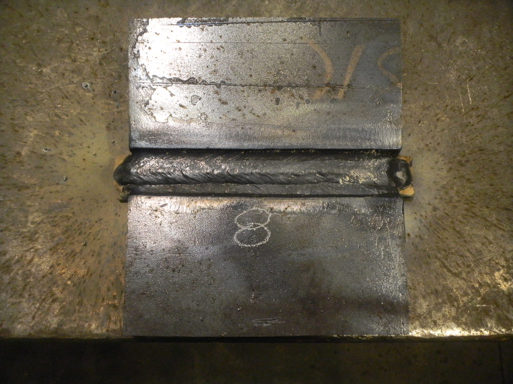

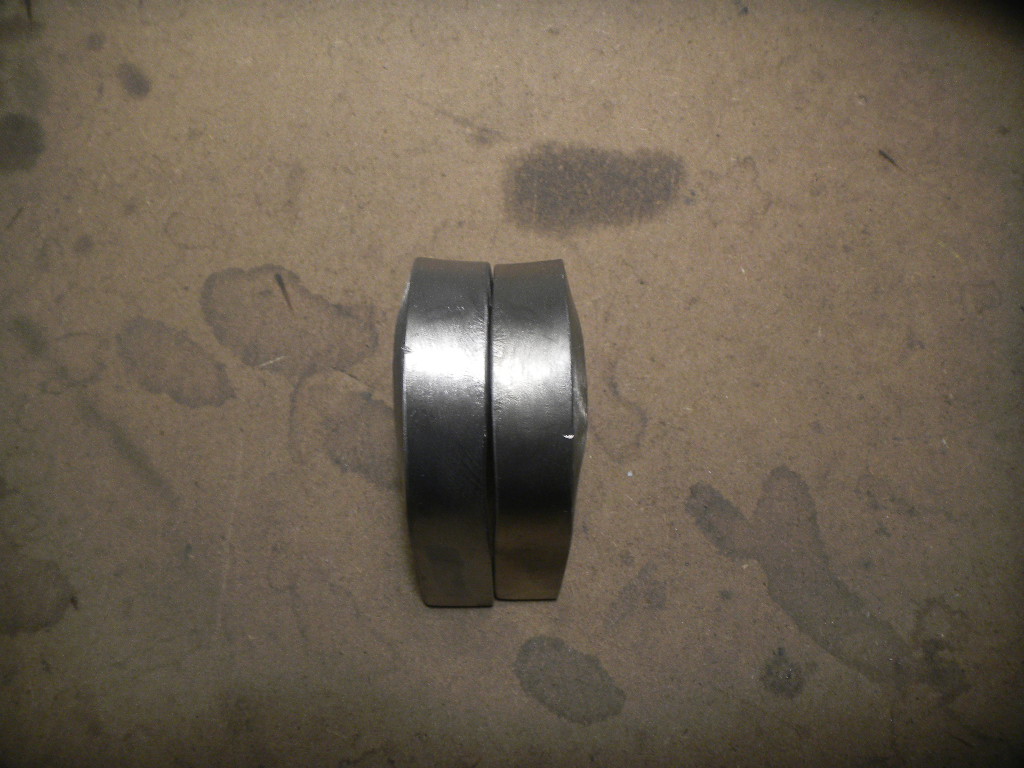

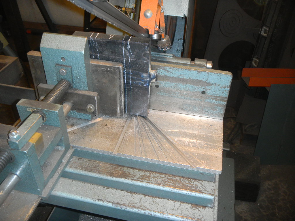

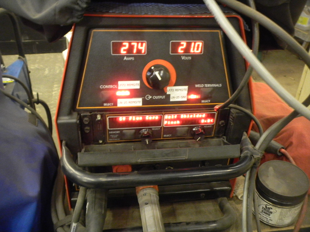

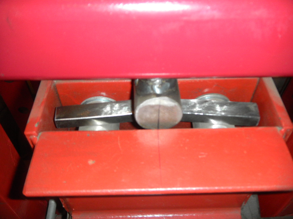

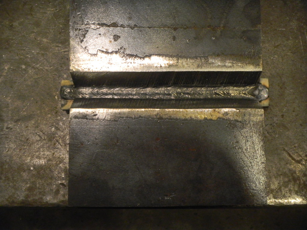

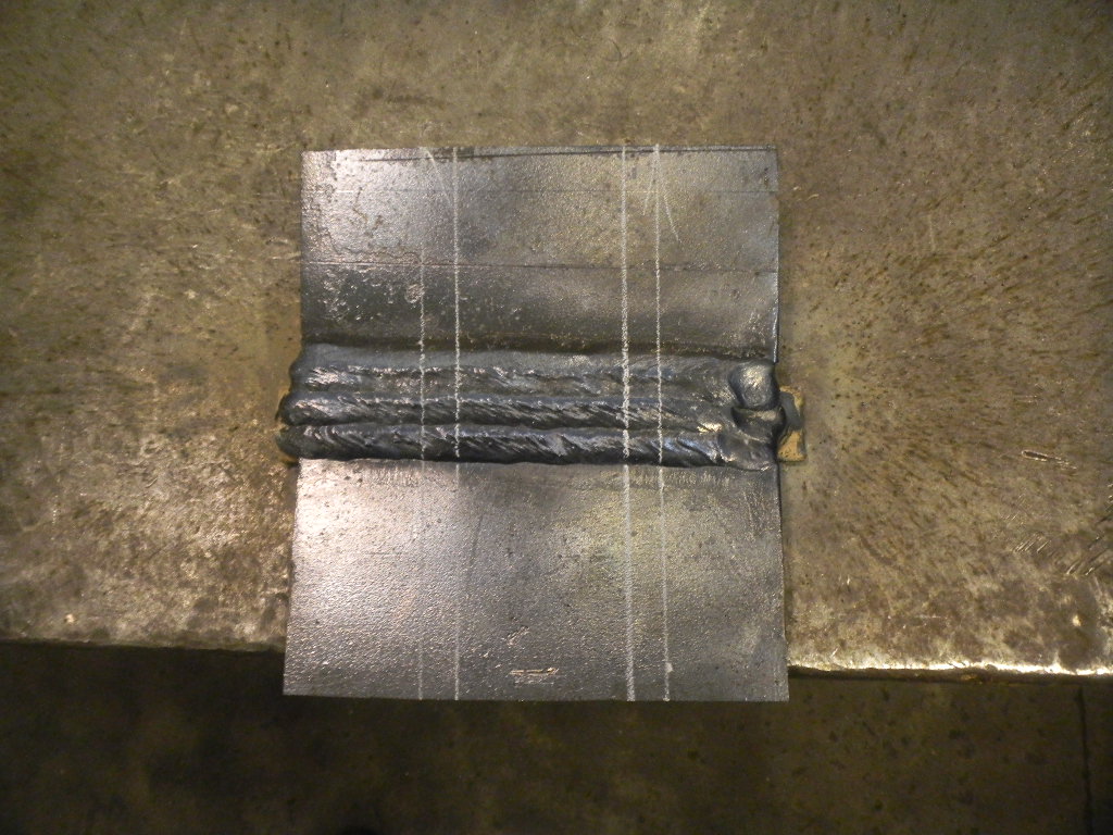

I was ask to run a bend test over on Welding Web. I thought you guys might be interested in seeing it. After the Northridge earthquake in California Lincoln and Hobart started putting thickness limitations on their wire. Over the years I've had several welding inspectors tell me they have never seen anyone pass a bend test with NR-211. So I gave it a go this morning.
Well so much for Lincolns 1/2-inch limitation. And this was with 30-year old wire, that had a little rust on it.:eek:
.068 NR-211 MP. Ran at 21-volts, 274-AMPS, 0.0 pinch. 3/4-inch thick plate, 35-degree bevel 3/16-inch gap, 1/4 backing plate. The little ding on the coupons is from the bender, first one I didn't place a rag under it. Second one I did, but it still got a ding.:rolleyes:

Well , Since your Coupons are literally bent in half and there are no breaks , I am Thinking that I would trust that wire on anything I might try to stick together .
To Say that I am Impressed with Your capabilities would be a Gross Understatement . :thumbsup:

You know I really figured they would break, or have major flaws:confused3:. The wire being 30-years old for one thing!:eek: Then Lincoln putting the 1/2-inch thickness limit on the wire too. That earthquake really stood the structural welding world on it's ear here on the west coast. Soon after you hardly ever seen T-11 wire on structural jobs, all T-8 wire.
