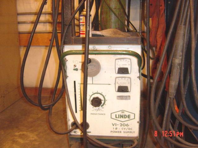

What I have read about these taped machines, is they're great for beginners. A beginner may spend all day looking for the sweet spot with a infinite adjustable machine, where someone like me can dial a machine in, in just a couple minutes. So this just might be the machine for you!
Here's what the face of my Mig machine looks like, I have adjustable voltage, and inductance, plus wire speed.
