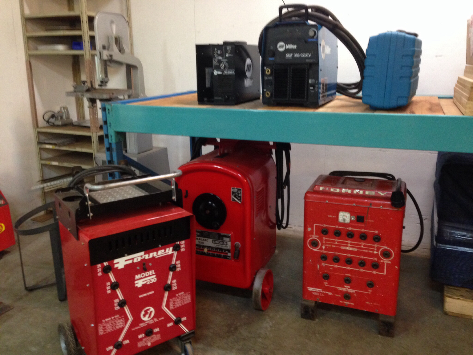

The older transformer welders ARE pretty much "bullet proof"
Not a Lincoln, but my Forney (on the left in photo) was purchased new for the farm in 1966.
Terry
/ Lincoln AC225 #24
Not a Lincoln, but my Forney (on the left in photo) was purchased new for the farm in 1976.
Terry
Did you set it on the shelf in its wrapping paper?:D The darn thing looks nearly new!:thumbsup:

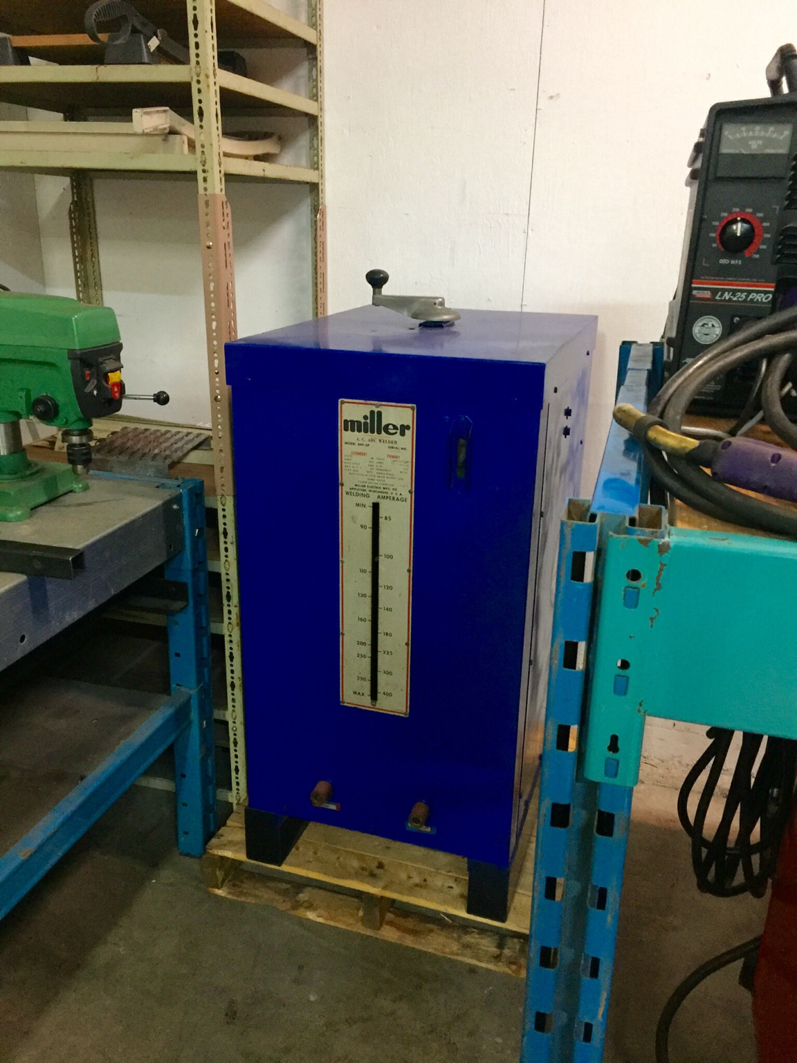

You should take a look at the Everlast PowerArc 300. It has adjustable hot start, and arc force. If you have been welding long, the hot start will not be of any use to you. The adjustable arc force is very handy to have.
A 300-AMP stick welder will weld just about any thickness steel you would ever want to weld.
Here's my old Miller 300 amp buzz-box for comparison
Shipping weight (aprx).
Miller 500#. :(
Everlast 70# :)
Input power requirements
Miller. 100 amp. :(
Everlast. 60 amp :)
Everlast inverter performance advantages:
Everything Shield Arc and kOua mentioned.
Terry
