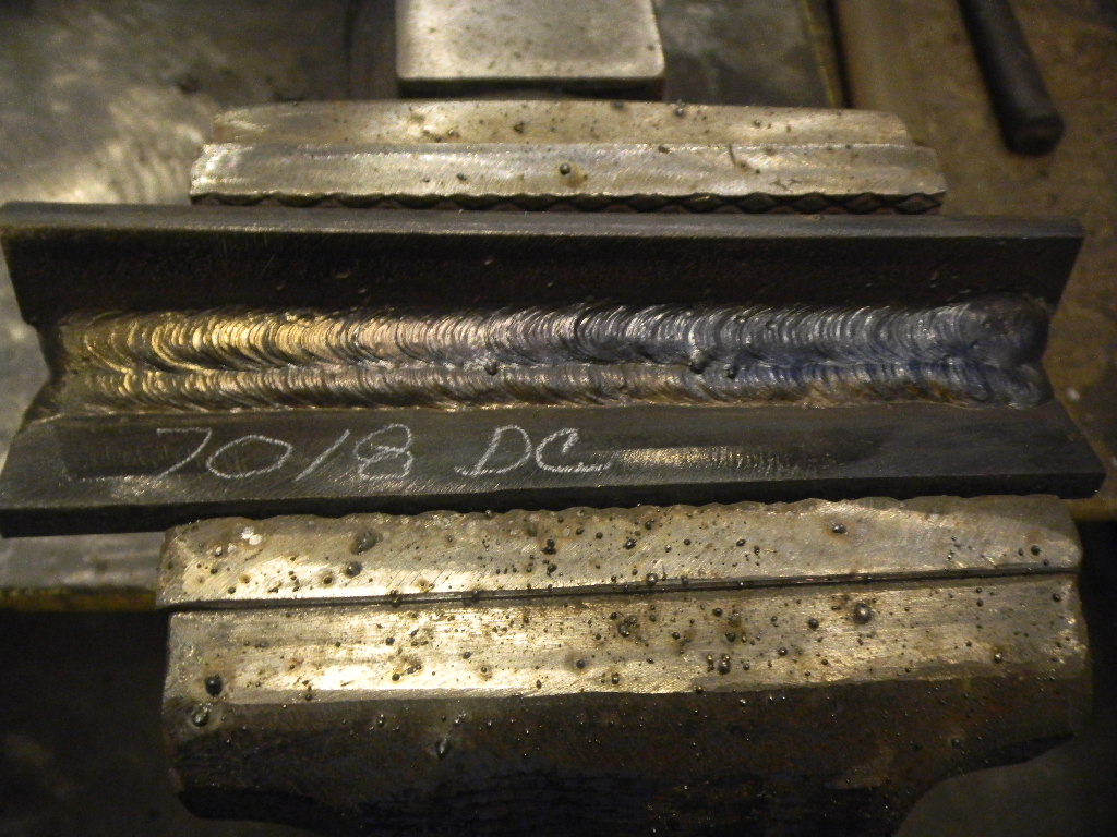

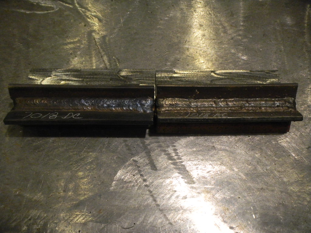

Until joining these tractor forums I never thought about welding on AC except with Tig aluminum. In my line of work we ran into arc blow all the time, but we only used engine drives, so AC machines were all most unheard of. I took my Montgomery Wards buzz box and did some comparison welding with 7018. You can see in the AC plate where I lost the arc a couple times, and see all the splatter.
When you have some time here are a couple article about welding on AC. In the last paragraph of the Lincoln article pretty much sums it up about welding with AC.
"The first, most common situation is when you have no choice. This is because you are using a power source with AC output only. This is typical with low cost, entry-level type welding machines, often referred to as a buzz box welder".
DC vs. AC Polarity for SMAW
Miller - Basic Tips to Improve Stick Welding
As the resident welding expert already said, "your money.. your call".
