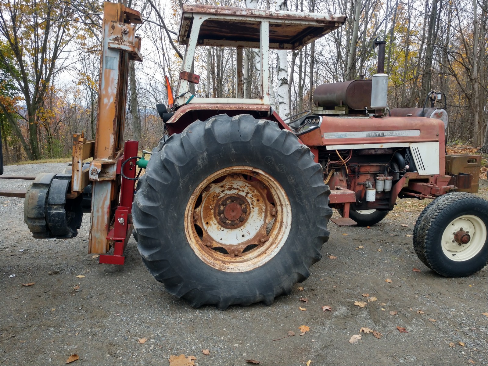

You sometimes see 3ph forklift masts for sale. Except for having to be turned around, this is the natural choice. It's where a tractor should be carrying the weight anyways. On the heavy rear axle, and the robust driven one on a 2WD.

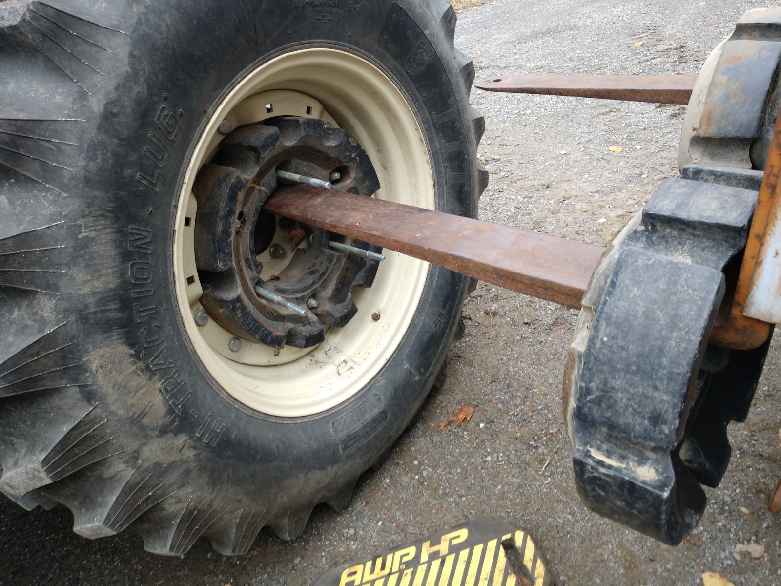

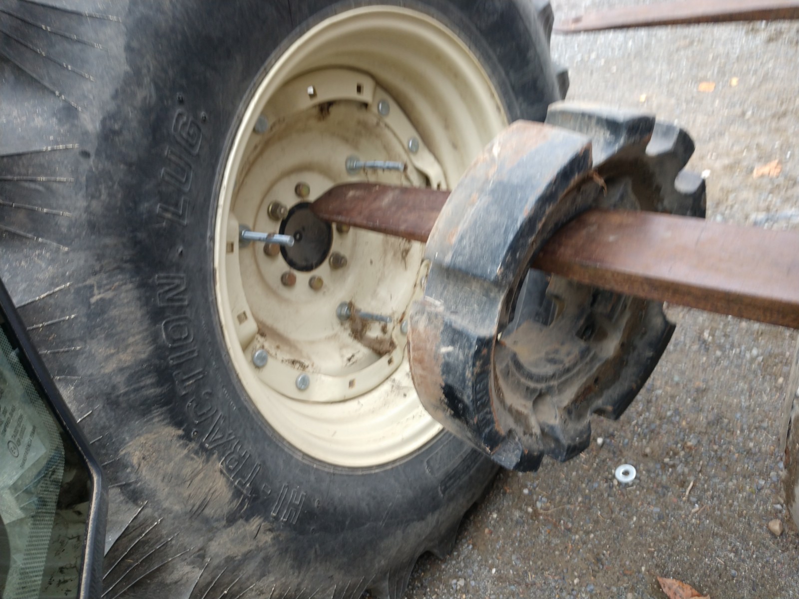

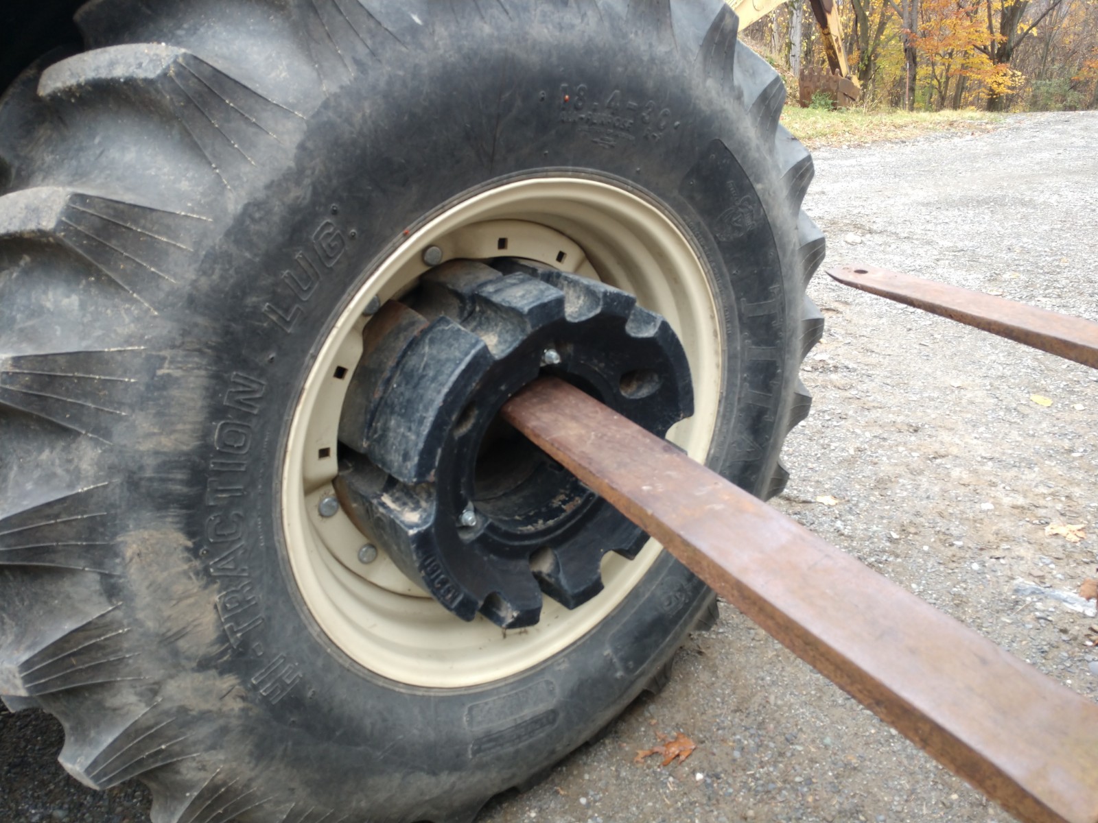

I bought a 1989 JD2555 (for less than his budget) and bought the carriage from a couple of forklifts, mounted 3 point pins on them and it will outlift the FEL on my Kubota M7040 as far as weight. The issue with it is being able to pick up something high enough to put it in a truck bed or get it out, but a low trailer solves that problem. Things not on pallets can be hoisted with a 3 point boom pole. I like the idea of using the whole forklift mast to get the height needed to put things in a pickup truck. A "LiL' Joe" is a pull around forklift that actually would make a great donor for a 3 point mast. It is a shame that the original poster (Bad Decisions) lives so far away, or I would make him a package deal on most of what he needs for his budget.
