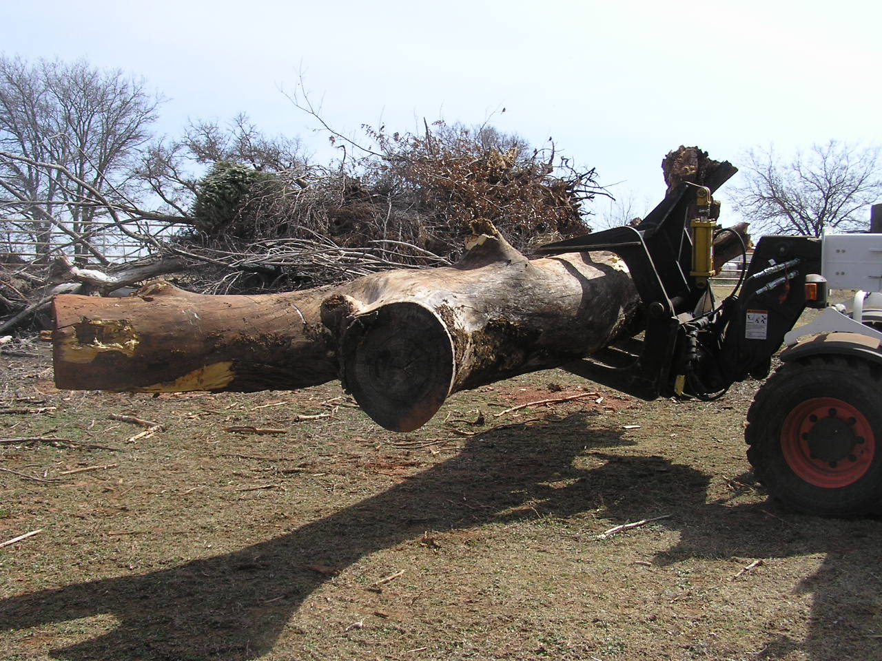

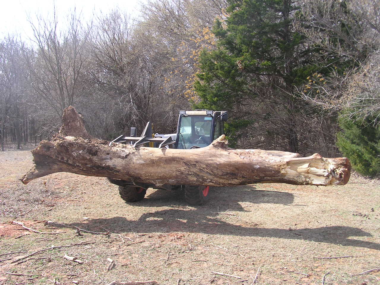

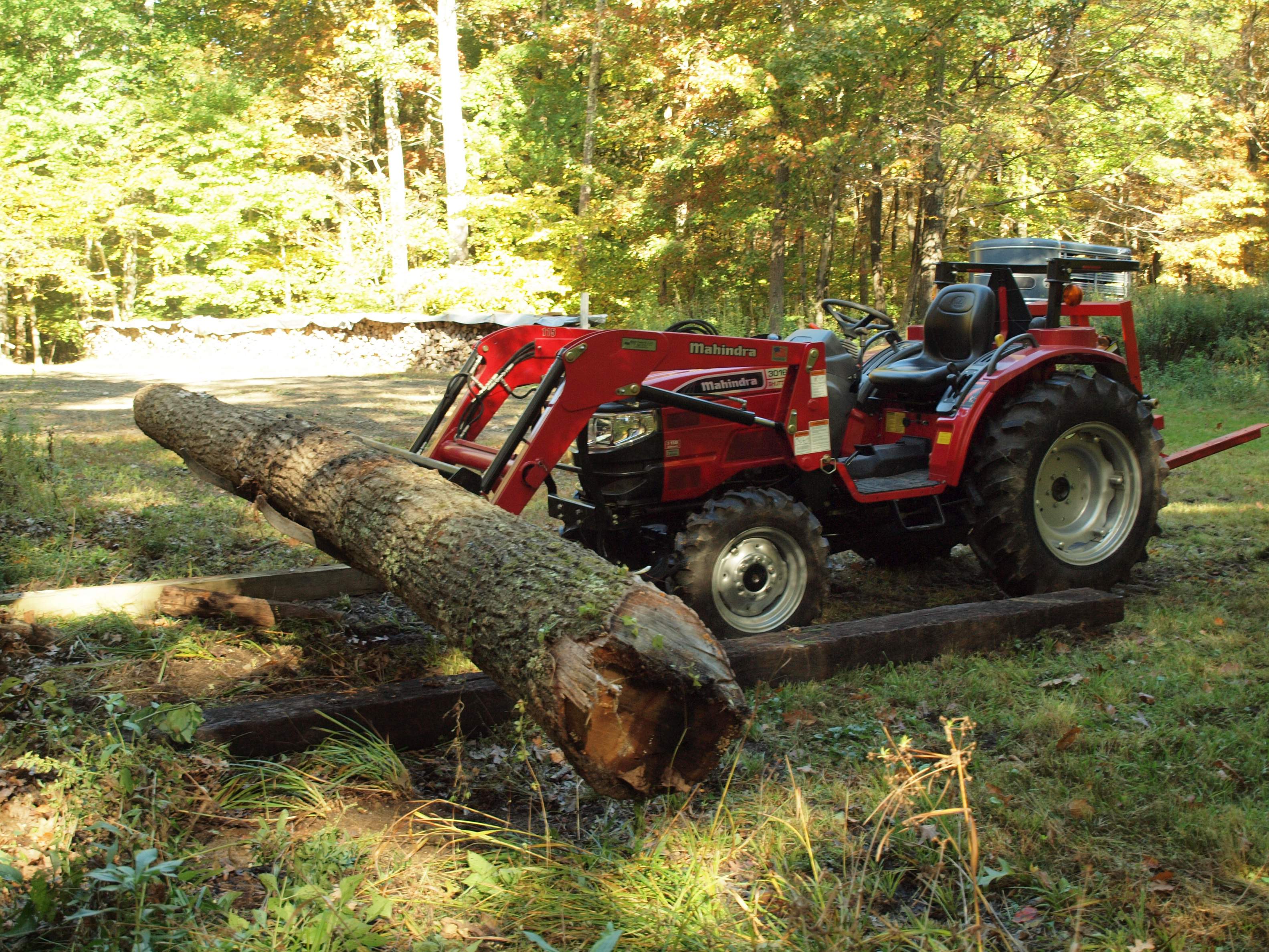

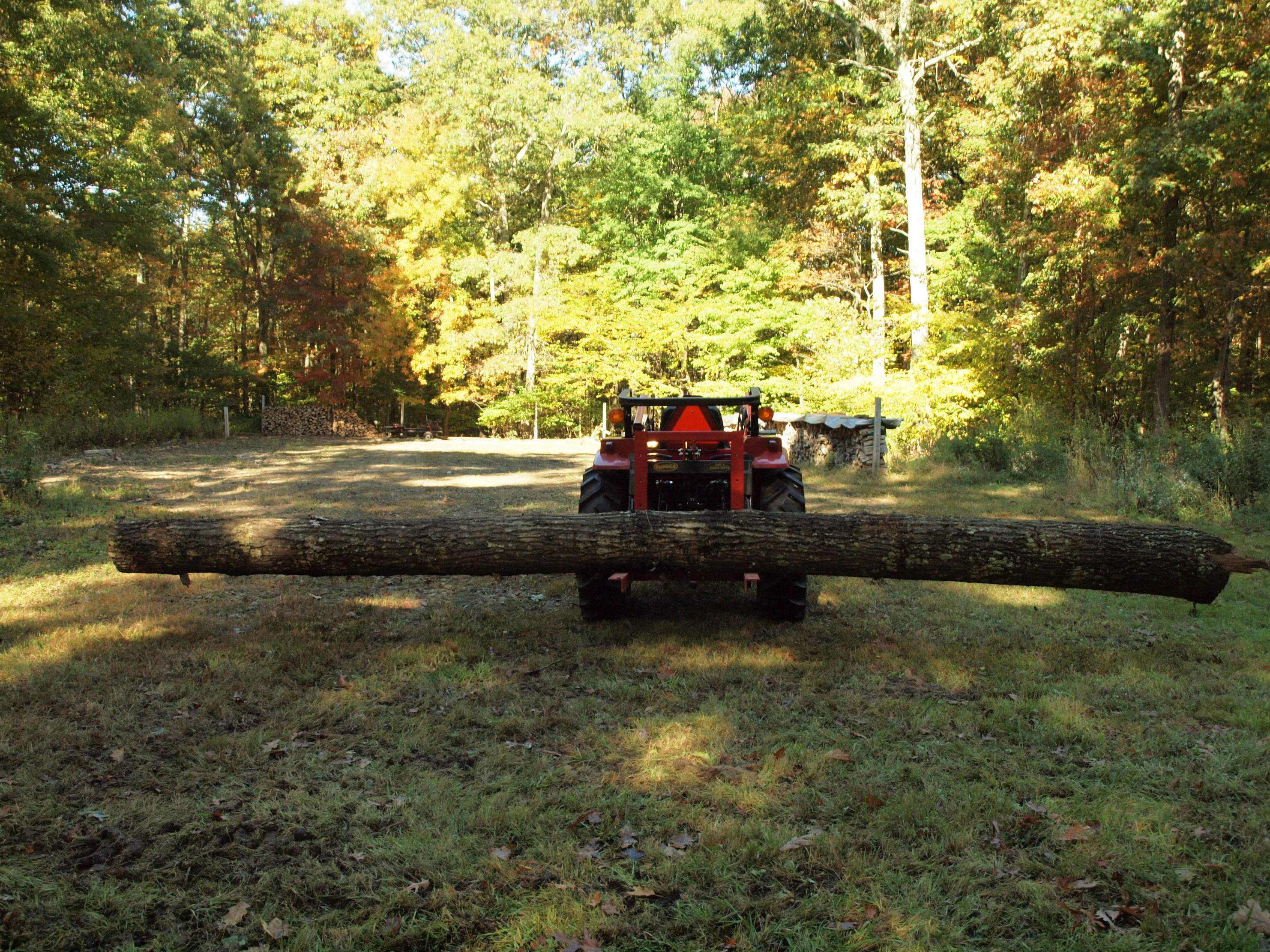

i attempted some real world stuff. This log is not 8 long but it does weigh over 1650 lbs at 20' long. My loader is rated @1600lbs. It can lift it but you can tell the loader is fast reaching its limit. Never would I attempt to travel with this type of stem very far and bring it to the splitter with the 3 pt carry all. If I had about 800 lbs more ballast, it would have made the tractor more stable. Big weight to load requires bigger tractors of more like a utility type rather than a mid size cut in my opinion..

are you 2wd or 4wd?

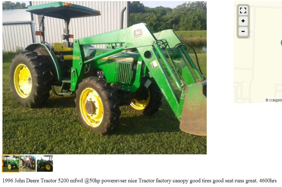

Know anything about this tractor? 4600 hours seems kind of high (to me anyway), but it is MFWD and has a loader rated at 2500.

These were good tractors. If it was used steadily, 4600 hrs doesn't seem too large a number. I once saw a JD 1050 with 13,250 hrs. It was used to cut acres of grass and still ran like a top.

It would handle the logs :thumbsup:.

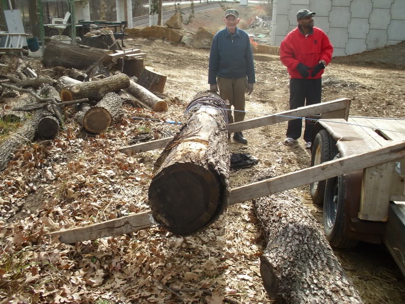

You could make a ramp out of 2 timbers, each with 1 end leaning against the side of the trailer and the other end on the ground, set wide enough to drive between. Then you can skid the logs to the ramp, then push them up the timbers onto the trailer. Something like this: <img src="http://www.tractorbynet.com/forums/files/owning-operating/394297-lifting-logs-log-ramp-jpg"/> Unloading would involve pulling them off, from the back. If you have a winch you can parbuckle the logs into the trailer.
I worked a ton of hours in the woods with a tractor. I have an l4740 kubota and I loaded many 16 foot logs that was over a ton like this. I was wondering if somebody was going to mention this tactic.

The JD 4500 is similar to my JD 1070, although mine has a JD 440 loader. So some of my experience might be pertinent. First, lifting heavy stuff should be done with a heavy counterweight on the 3PH or the backhoe mounted. The counterweight I made for mine is about 1200 pounds with the suitcase weight rack filled on it. Without the weights it is about 800 pounds. It makes a huge difference in balance, stability and traction. Otherwise you are overloading the front axle and you will ruin it in the long run. Also, you will lose rear wheel traction. You want to try to use it in 2WD mostly with heavy loads as 4WD tends to get bound up and makes turning hard and puts tremendous stress on the gear train and front axle parts. Forks are the way to go; using a bucket you will bend it as its top edge is not stiff enough and the dangling log will serve to sway, bash the front end, etc. Plus you are always having to be on and off the seat with chain setting. One lifts the heaviest stuff by getting it as close as possible to the faceplate for a shorter lift radius. It is easy to buy too small a tractor and end up struggling with tasks for which it is really too small. It is hard to buy too big a tractor. I doubt if you will lift a 36" by 8' white oak log other than getting under it and scooting it along with it dragging some. I've done it and lifted it some on the bounces but the weight is too heavy for the machine's rating, and you probably want to keep the log cleaner than this method generally generates if it is for a sawmill. Ramp methods for loading a trailer are a hassle but it depends on how frequently you are going to be doing such chores - one or two no big deal, but routinely I'd avoid it. I have a homemade set of forks for the 3PH that can lift quite a bit heavier log. Problem then becomes trying to control the fork angle to unload; it slants back into the tractor when elevated and doesn't want to roll off, but it is good and safe for moving heavy stuff then unloading by lowering to the ground and driving away. Consider putting a winch on the trailer and just drag logs up the back ramps with the winch instead of using the FEL. I've found that most logs I handle are not overloading my FEL, just the occasional big tree is too heavy for its rating. I have bent (bowed) the steel rods that hold the forks allowing fork width adjustment over the years so that gives you some idea of one consequence of going beyond the machine's rating. I also ended up having the front tires filled with polyurethane because I got too many flats lifting heavy stuff and trying to turn. Despite proper air pressure, the tires just weren't enough to handle the weight on the front axle when turning. I helped a neighbor install an outdoor boiler and my machine was unable to lift it to get it off his trailer - we ended up using 2 machines to lift and drove the trailer out from under them lifting it. Finally, lifting logs real high is dangerous for a couple reasons - the stability of the tractor is jeapordized on slopes and the log could roll back off the faceplate and drop on you if you angle it back too far. I've lifted logs real high to get through a gate that is narrower than their length sometimes, and the curl has to be reduced as you go up otherwise it'll tilt back too much. If I am going pretty far with a log load I chain them onto the faceplate just so bouncing doesn't lose any.

Arrow has it right. Buy a set of pallet forks for the 3 pt and lift your heavy logs with that. For $250 you can save yourself a lot of potential damage on the loader and front end of your tractor. Why do you want to plan on pushing it to the limits?
