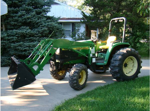

I am looking at purchasing a 1999 JD 4500 that has a Woods 1012 loader, the lift capacity is rated at 1375 lbs. Maybe that lift capacity is at the top??
Will this tractor/loader combo be able to lift 8 foot logs, anywhere from 18" to 36" in diamter??
I don't need it to be lifted very high, the highest ever would be to get it on a trailer but that wont be all the time. I didn't know if someone here has used something similar to lift logs and have done fine with it. Just as a guide an 8ft White Oak log weighs about 1648 lbs (from what I can find).
Thanks for any info.

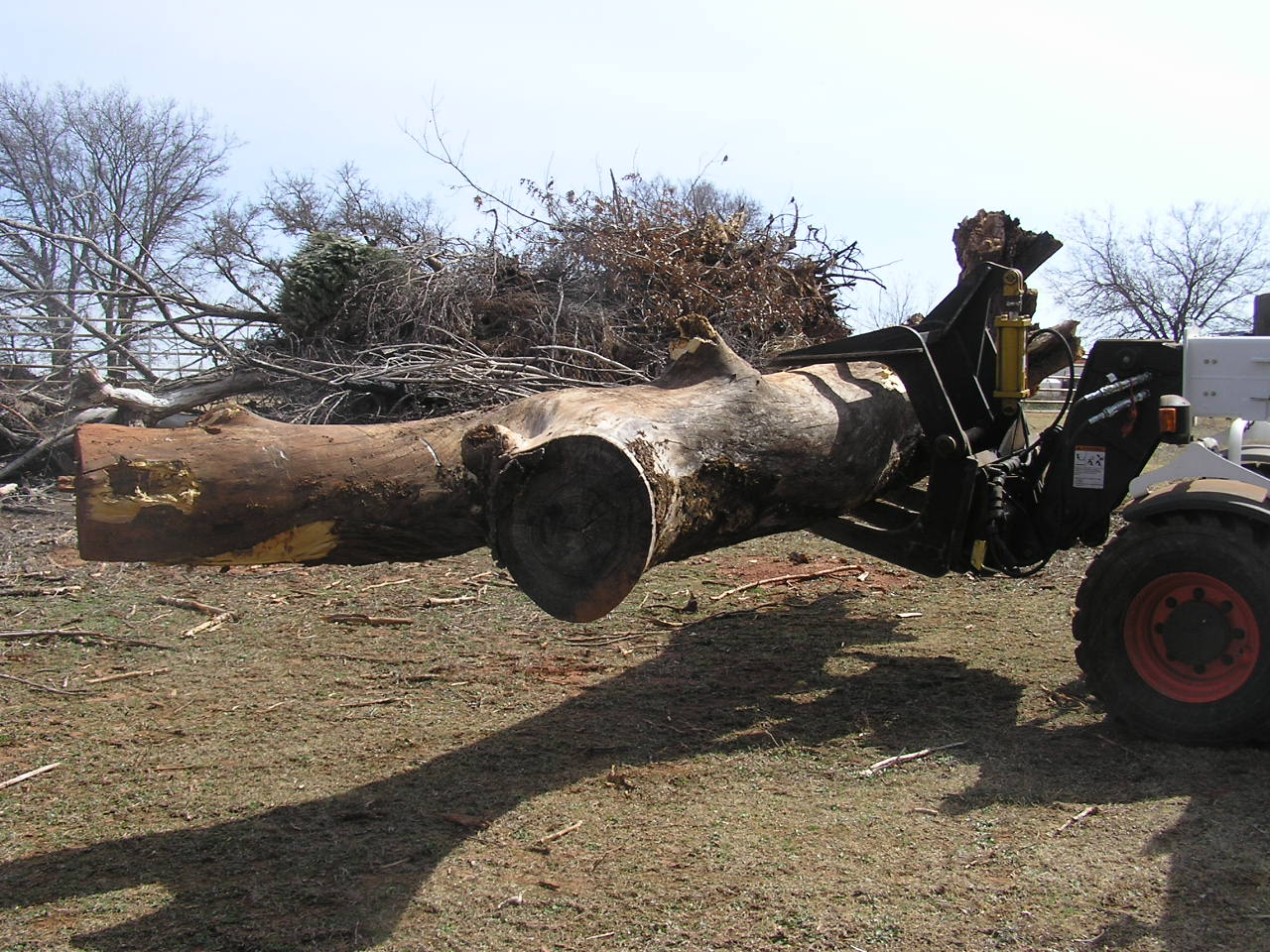

Not only is the weight a problem if the specs are to be believed, but I think 8 foot logs are going to be a bear to balance unless they are very uniform and symmetric. I like lifting 4'-5' sections myself, since they can fit inside my bucket and I know they are not going to shift or tip. For longer stuff that is for lumber, I skid them on the 3-pt. If I do have to lift them with the front loader, it's just up into the cradle on a sawmill, which is only a 3-4" inches off the ground.
/ Lifting Logs #9

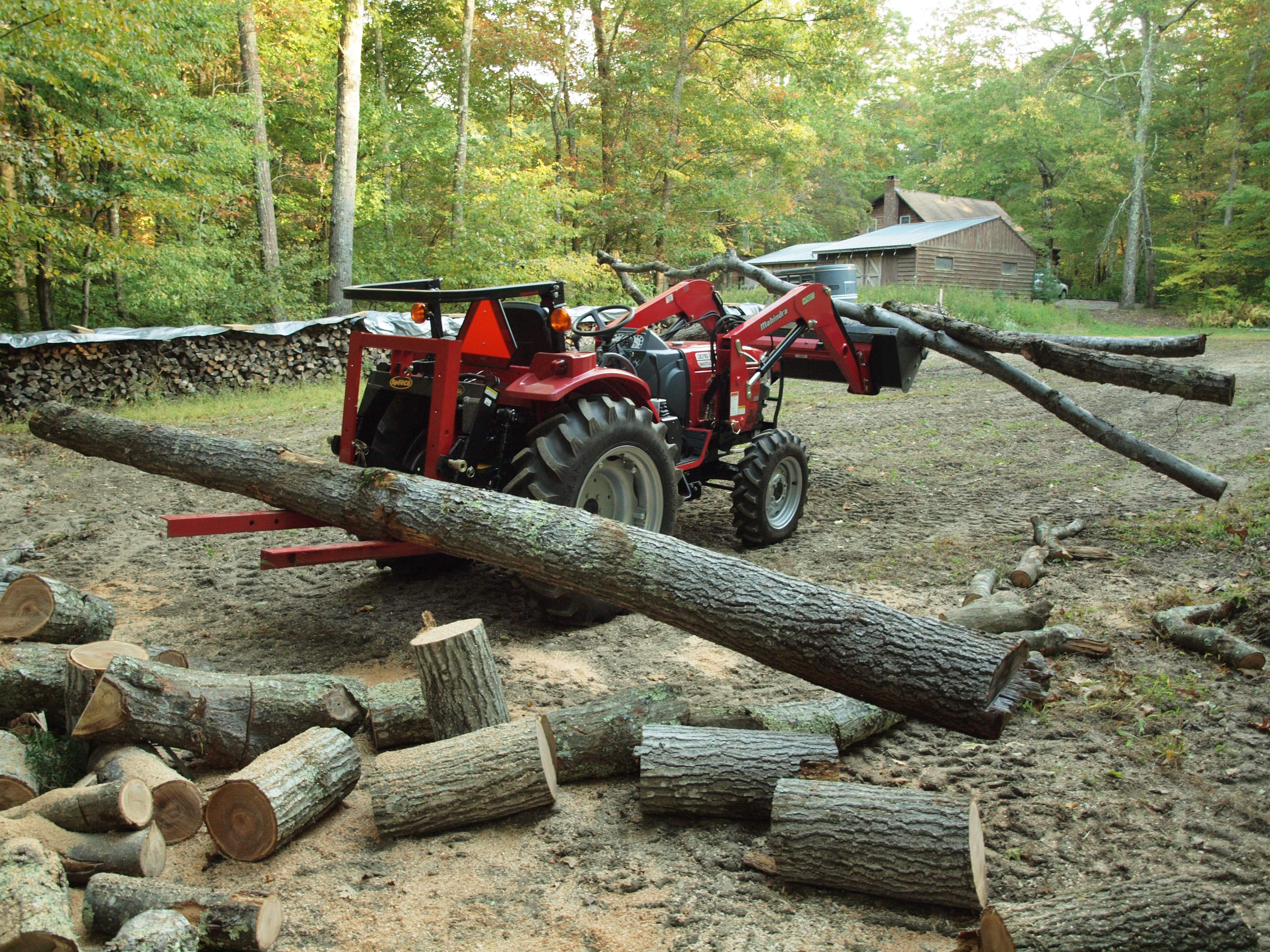

Specs aside, I find 8 ' logs extremely easy to balance as they are only overhanging most buckets 18" off of either side.. Even this log only took 2 tries to find it's balance point. Walked it down about a 100' with no issues at all. Joking aside, I refrain from lifting anything that heavy and moving with it with the front end loader for the enormous torsional stress on front end componetry. The light logs you see on the bucket is as large a load as I would go traveling a distance as combined, I doubt they weigh 400 lbs

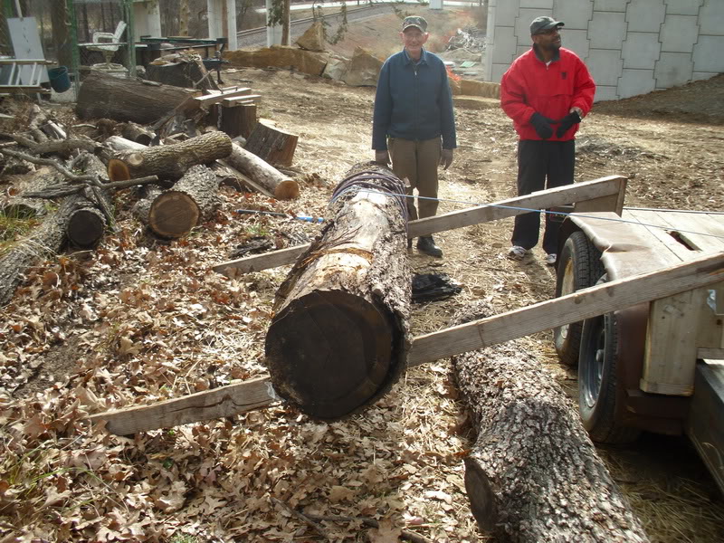

You could make a ramp out of 2 timbers, each with 1 end leaning against the side of the trailer and the other end on the ground, set wide enough to drive between.
Then you can skid the logs to the ramp, then push them up the timbers onto the trailer. Something like this:
Unloading would involve pulling them off, from the back.
If you have a winch you can parbuckle the logs into the trailer.

There is little way for this tractor to lift a 36" diameter 8' white oak at over 3500 lbs wet. You may have a shot at a 24" as this log will be less than half the weight of the 36" one.
/ Lifting Logs
#18
36" would not be the norm but have got them a couple of times, 24" would be more the norm when I did move logs.

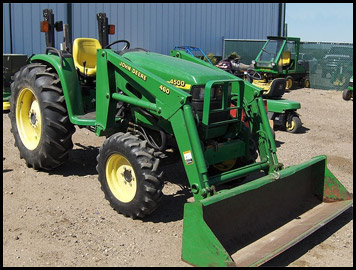

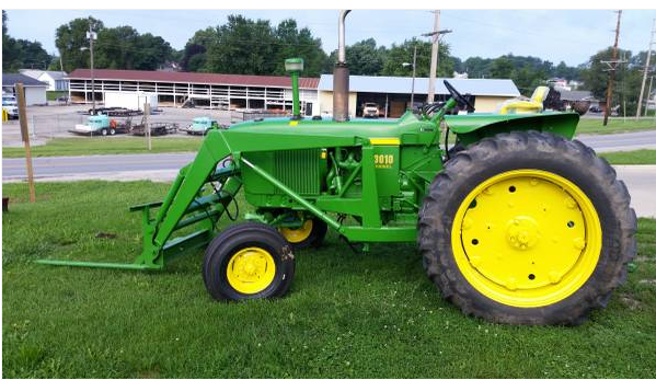

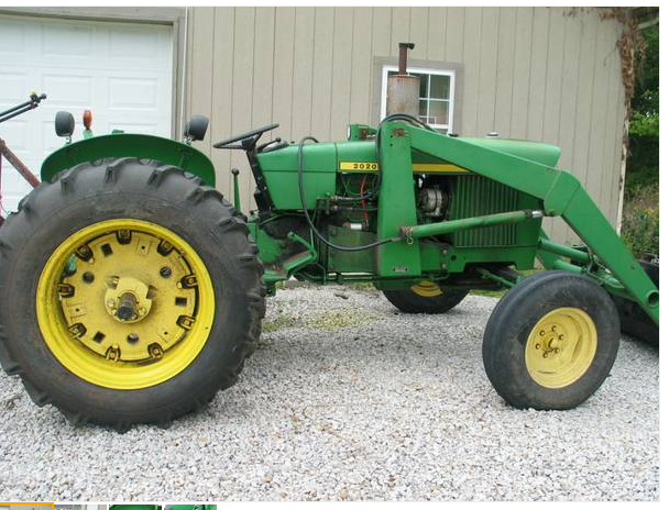

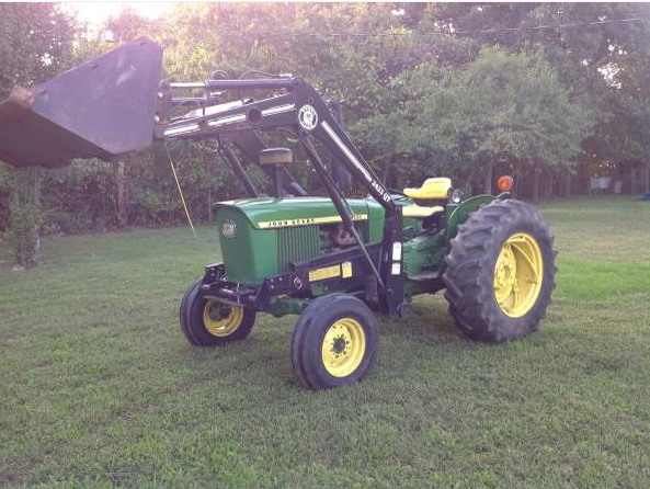

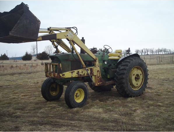

Here is a 4020 that is also in the area. (1967) 90hp I think
the 1520 (1972) 50hp
and 4500 (1999) 39hp
the 3010 55-60hp
the 2020 (1970) 54hp around
just remember what I am using it "mostly for"
thanks for all the help and advice.
