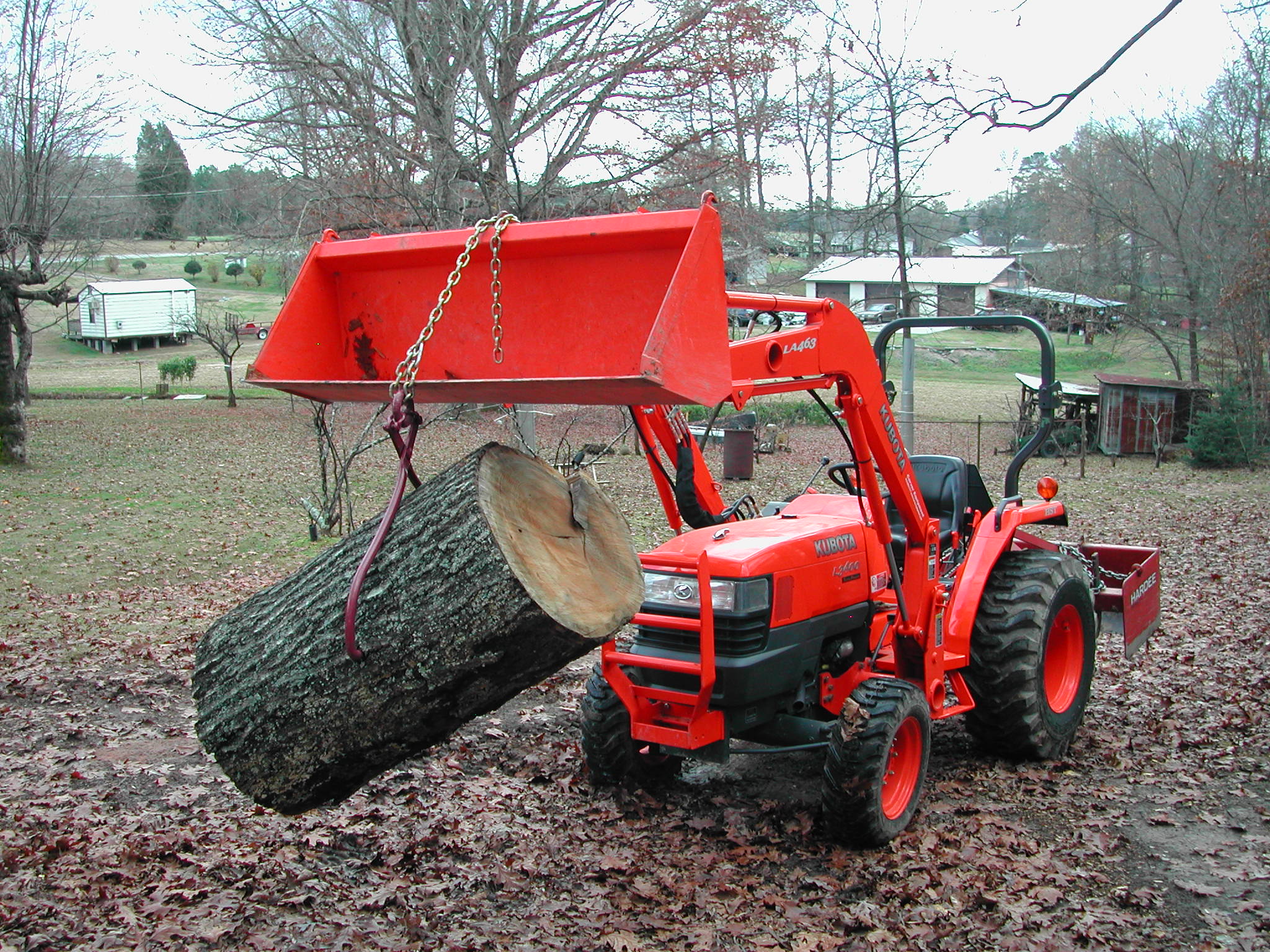

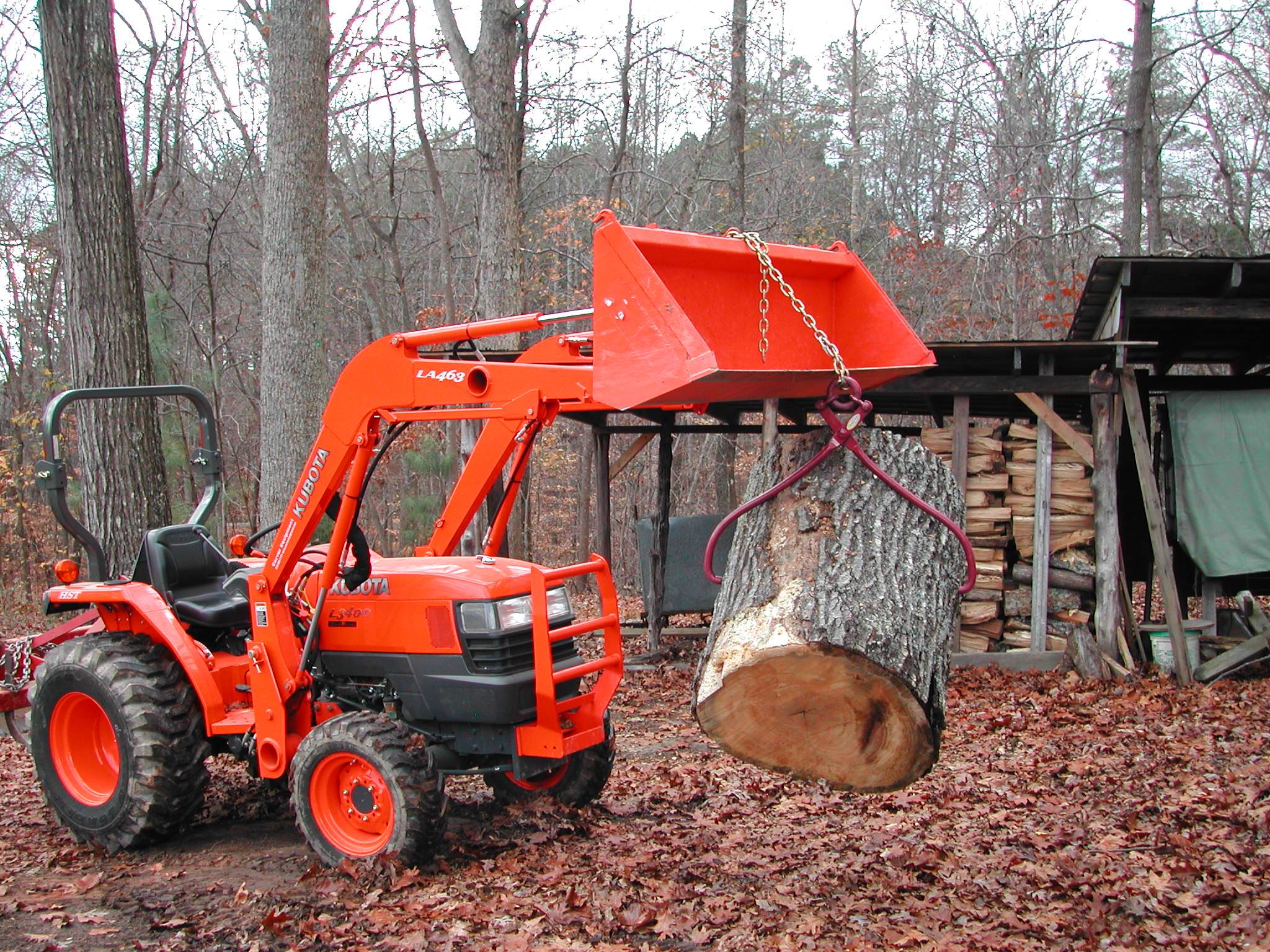

This is how I get the big ones on the splitter, it has worked very well for me. A little time consuming perhaps but I don't want to move too fast with the heavy ones.:)

Hook at the center can result in a bent bucket (unless you brace it...been many many threads on that).
Hooks on the ends distribute the load (on the bucket) better and you can use one chain (if it's long enough) by running through those outer hooks, then to the item you're lifting. Wish I had a pic since that would show the rigging a lot better then I can explain it.
My bucket has 3 hooks...one in the center (for light work) and two outboard (heavier stuff, obviously). Mine are positioned the same as Veresjwv's are (pics in post #11).
But I agree with you on NOT using one outboard hook to lift a load.

Also keep in mind that lifting from one end mounted hook places tristing force on your FEL arms. Bend buckets are easier to fix than twisted loaders. When lifting from corner hooks with the chain at 45 degree angles to the load doubles the effective load on each chain. Reinforce your bucket for a center hook or get a quick attach boom pole/forks. MikeD74T

Be very careful with that. Sideloaded hooks can release a chain quite easily if you bump the load on tailgate or splitter. MikeD74t
