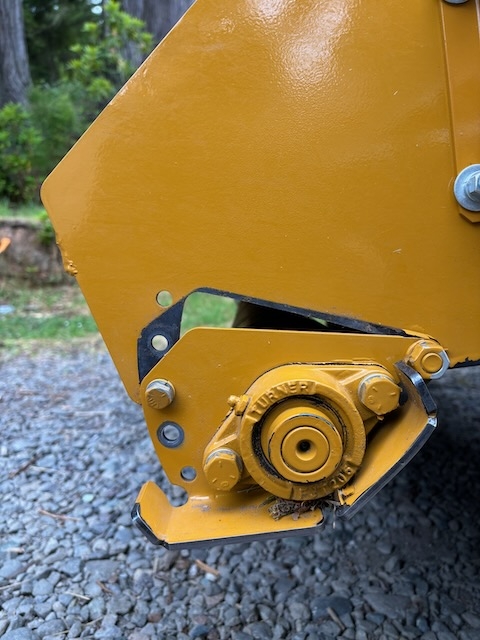

@leonz Thanks for the info on the belts. Will do.
I am currently in the process of adjusting the roller height; from the factory it came in the lowest position where both bolts can be attached (2 bolts per side lock the roller in place). I can pivot the roller lower and use only the lowest hole in the frame, but this would only allow for one bolt per side. Is this what we mean as the lowest setting? Or is the factory position, with two bolts, the lowest setting?
Photo shows the roller dropped to lowest point with one bolt.
   / Let's talk flail mowers #8,017
Yep, that is the lowest roller position which will yield the tallest cut. With the top link lengthen out to set the machine fairly level fore and aft. You can then vary the cutting height by lengthening the top link (taller stubble) or shortening a bit (shorter stubble).

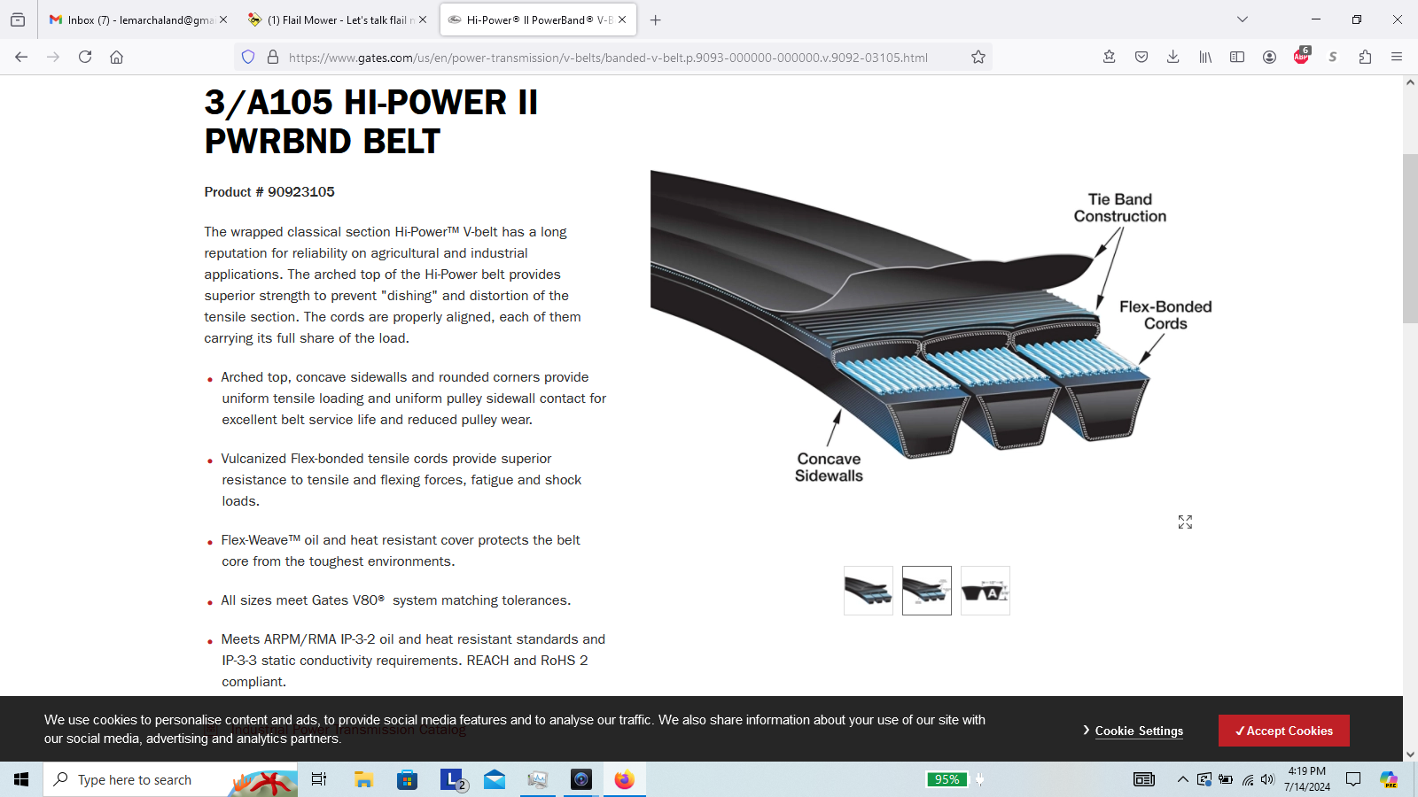

When replacing multiple V belts as leonz has mentioned you should get matched bet sets or if your pulleys can fit them banded belts will work better.
They are available in most sizes and configurations, 2,3,4,or 5 belts in one
   / Let's talk flail mowers #8,018
The Ford 917 calls for a banded belt and it works good as well as last for a long time.
