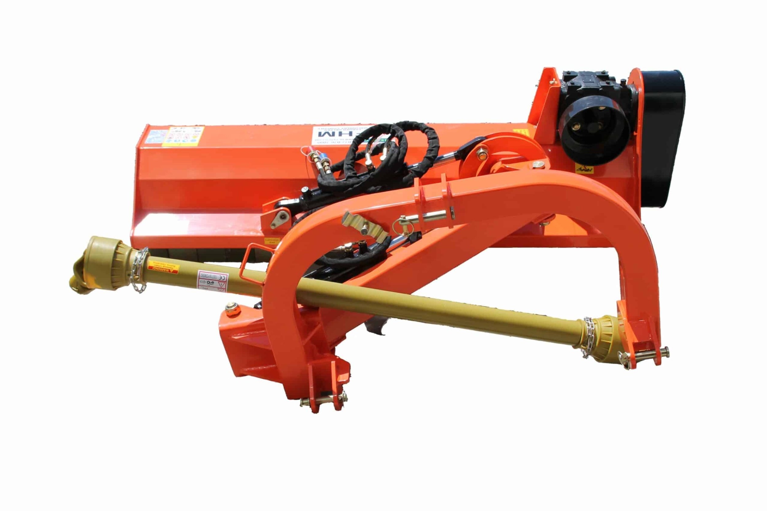

After 100+ h on my 68'' offset palletforks.com flail mower, I sold it due to the lack of available service parts, then I went and got a Betstco AGL165 articulating flailmower. Still made in China I suppose, but they seem well made. Have absolutely nothing bad to say about the palletforks.com mower. Just the company itself suck.
Hi, you can get Titan mower spare parts from Nova Tractor
