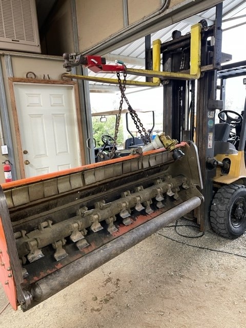

Time to sharpen all the hammers on my mower - Going to figure out an easy way to do this with lying on the ground. Initially thinking of lifting it with the bucket and a chain.
Hate to repeat a post i just made, but the Land Pride FM2560 (of which i ain't bought one yet) manual says, don't sharpen the blades. Also, don't replace a single blade if you break it, for fear of unbalancing the rotor, buy a whole new set. Sounds like they want to sell some blades!

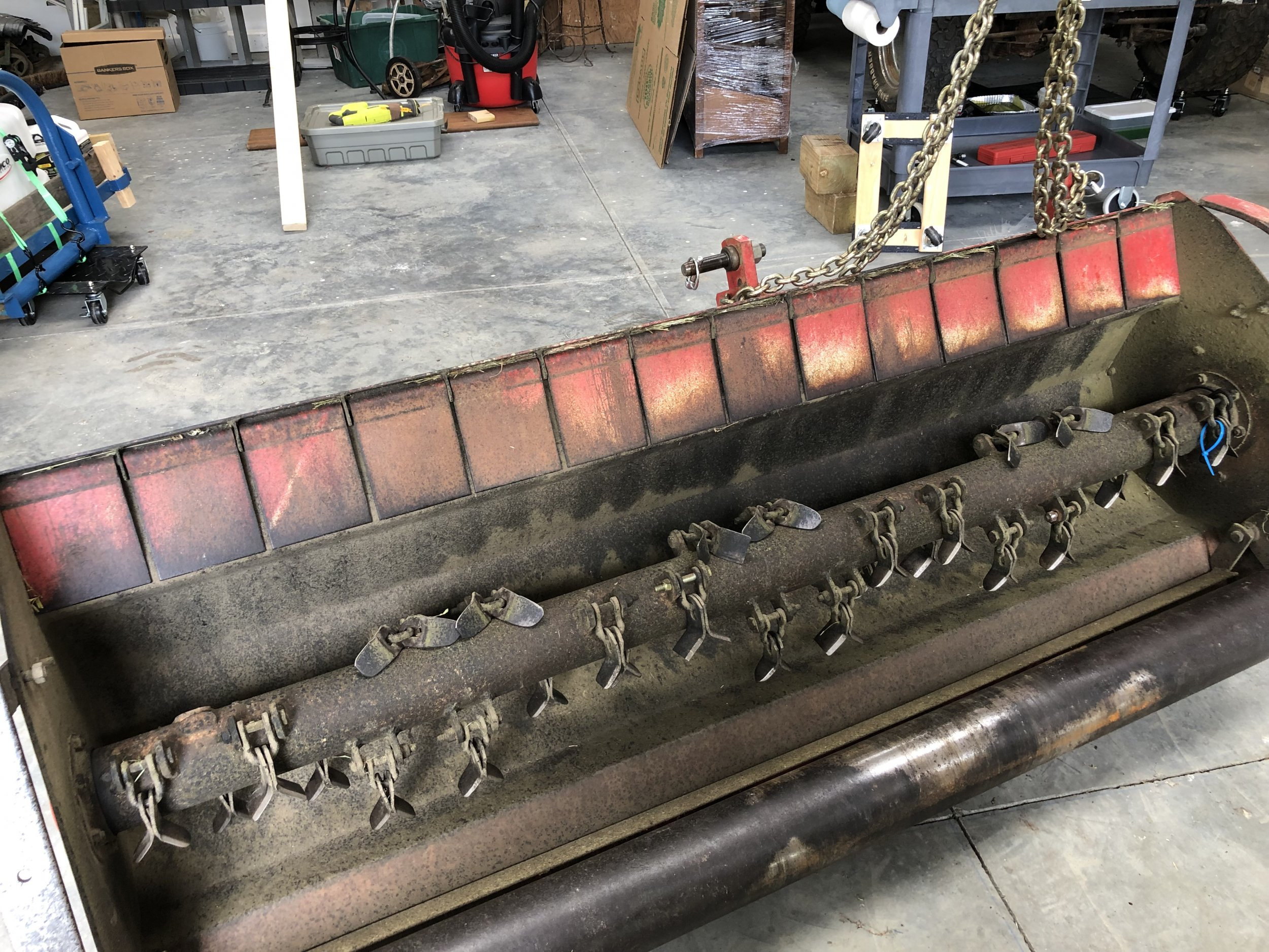

I have big 3 inch wide hammers. I replaced the whole set after the first year. Now I'm just sharpening them. 2 or 3 times so far. The result is no noticeable vibration. Just improved cutting.

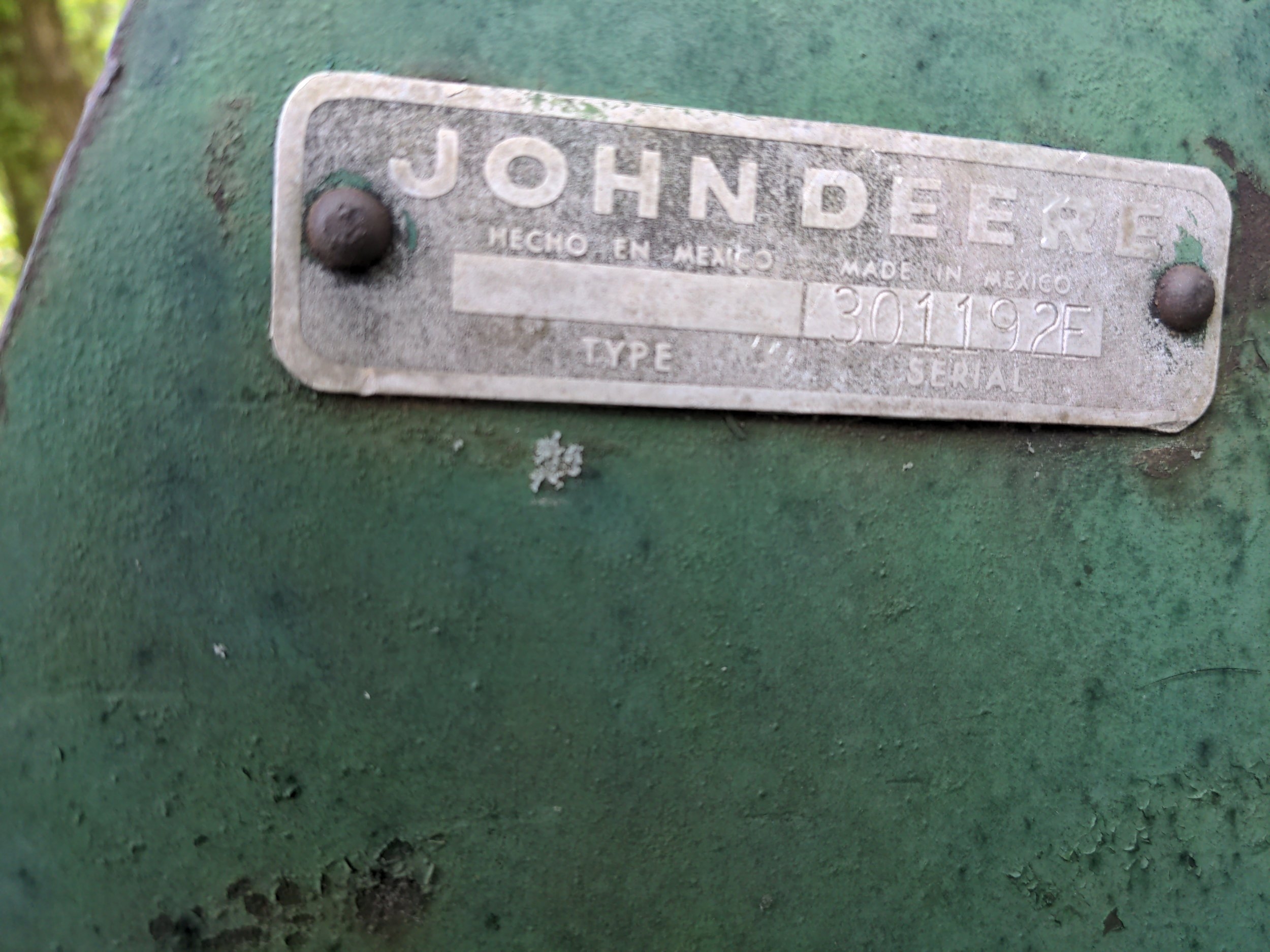

Got my auction find flail mower home today. It looks to be in pretty good shape overall, just a bit neglected. It needs a belt and the tractor side of the pto. Anyone know a good source for half, or is it best to replace the entire pto?
Can anyone confirm the model from this serial number tag?
Thanks
Thanks
You need a new complete PTO Shaft to cut it to the right length
