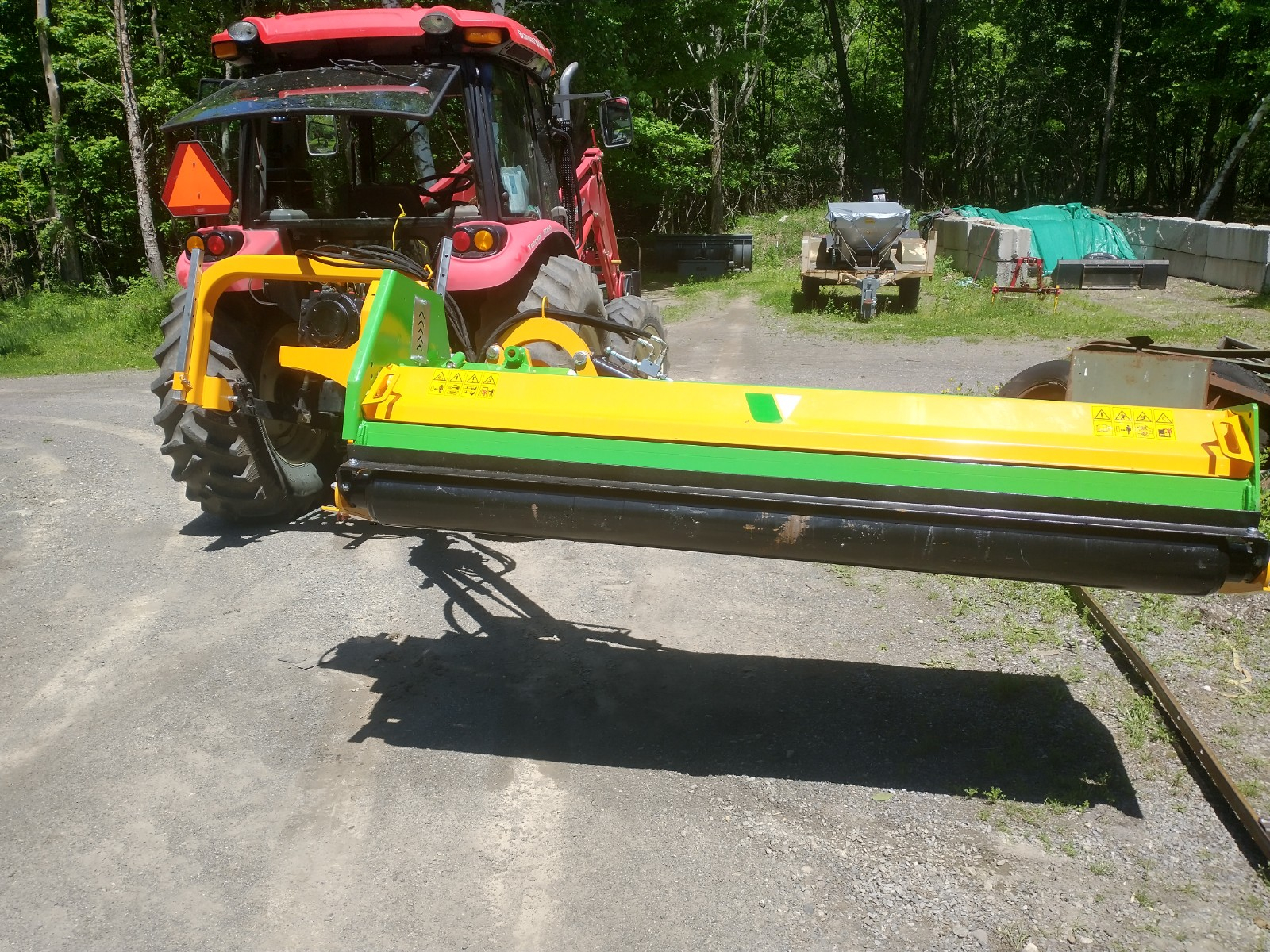

I have an 86 inch on a tractor that sits at around 11,000 pounds, the mower will bounce that tractor around quite easily.

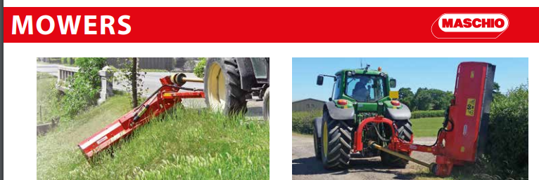

The smallest Maschio boom mounted hedge cutter with the upper and lower boom is the KATIA unit in the 50-60 horsepower range and it would allow you
to mow the slope from the ditch or the lane shoulder but you would need to make 2-3 passes.
The new mule would have to have the hydraulic capacity and flow to power the boom mounted flail mower.
You would have to decide which style of mower knife and knife hanger you want and any additional attachment options you would need for your mowing needs among them being an oil cooler and external engine mounted hydraulic pump and reservoir. All of the additional attachment options are shown and described in the Maschio boom mower catalog.
The new mule would also have the correct center of gravity and machine weight to allow the KATIA model boom mower to work in all positions and provide the stability for the proper over center control of the flail mower head on the lower boom in all positions as described in the excellent working illustrations showing the mower
heads fully extended upper and lower reach for mowing and hedge cutting.

I think that Katia might be more machine than I want....
My thought had been one of the offsets used like the first picture in the Maschio brochure is showing. Run one direction from the top and then run the other direction from the bottom with the mower rotated up.
Still gotta take that picture so people can tell me if I'm crazy or not....
