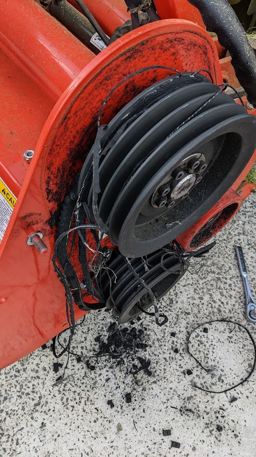

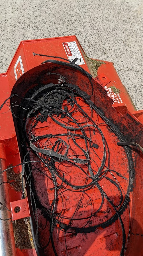

Disaster time. Not sure what took these belts out, unit has less that 3 hours on it. Didn't even make it to the first maint check LOL
I was just mowing grass and it tanked.
