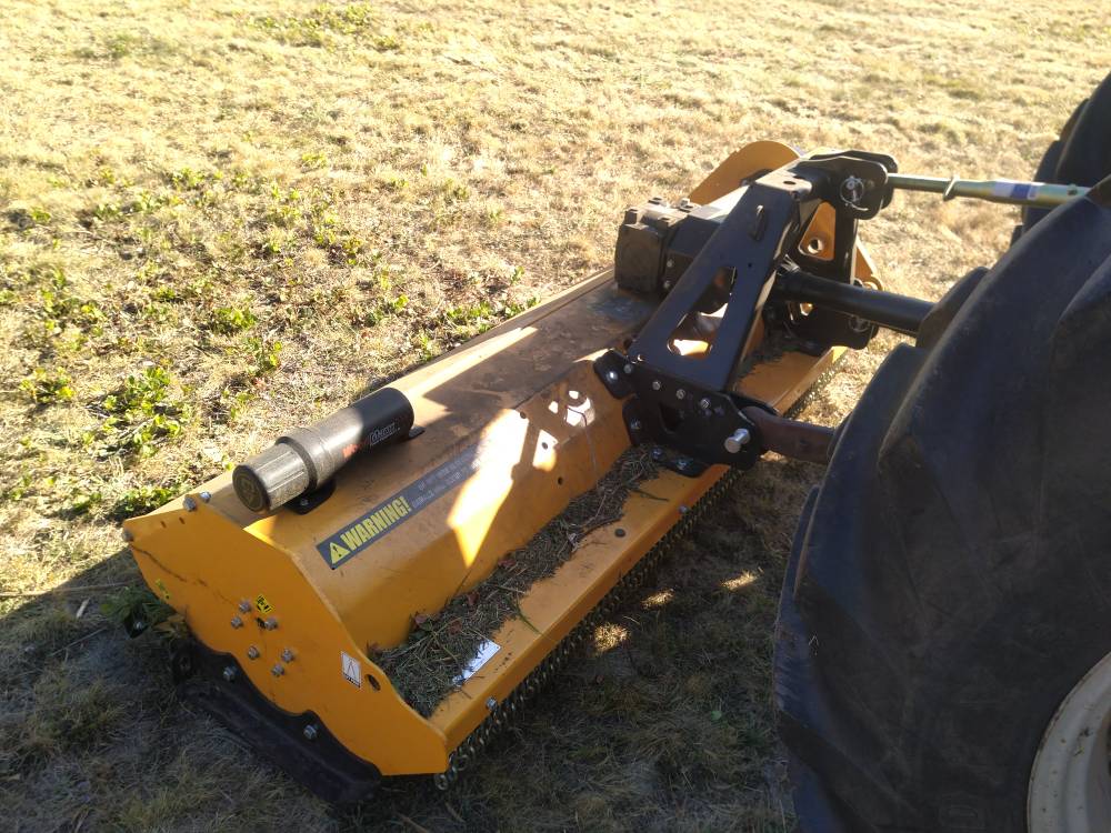

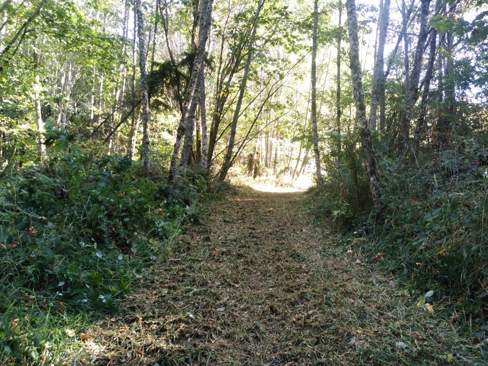

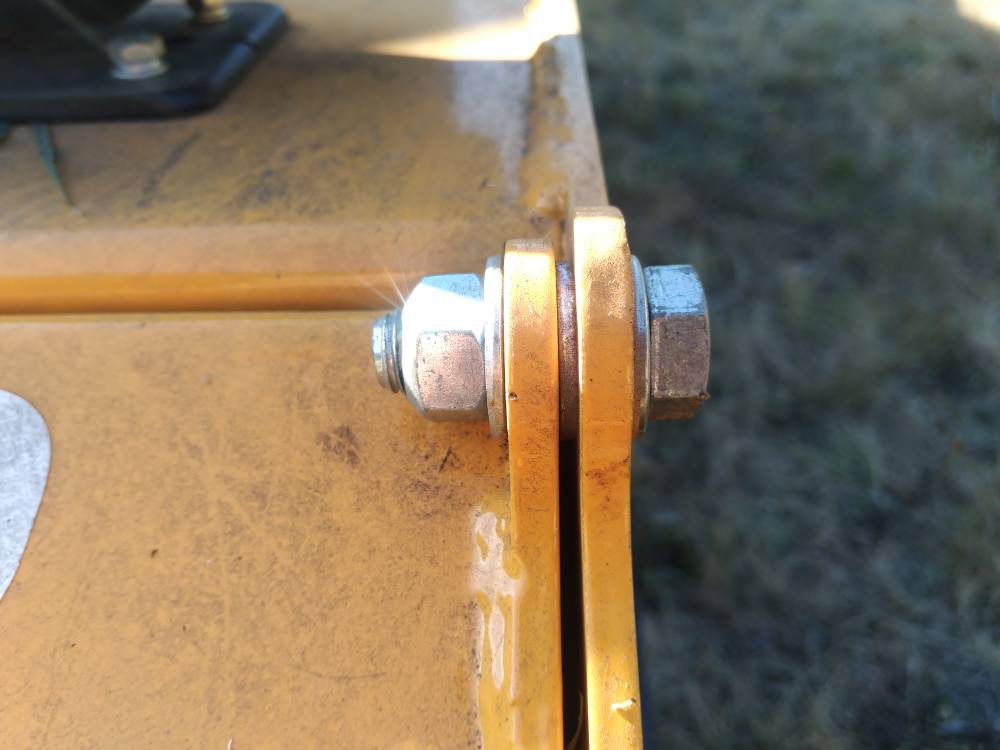

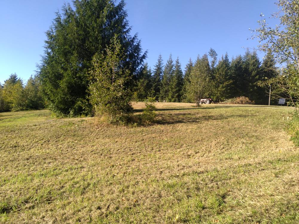

Put 5 or 6 hours on the WoodMaxx this week, so far so good. I did loctite and torque all the important fasteners, I also put some washers in the gap between the access door and the side frames so you can actually tighten the bolts down instead of leaving them loose to rattle.
It does a nice job, no vibration to speak of and none of the bearings or gearbox got hot. Tried it out it the woods too, works awesome but I think I'll leave the initial clearing to the brush hog, it's a little more boulder resistant. IMG_20200907_171035.jpegIMG_20200907_171047.jpegIMG_20200907_172008.jpegIMG_20200907_170834.jpeg

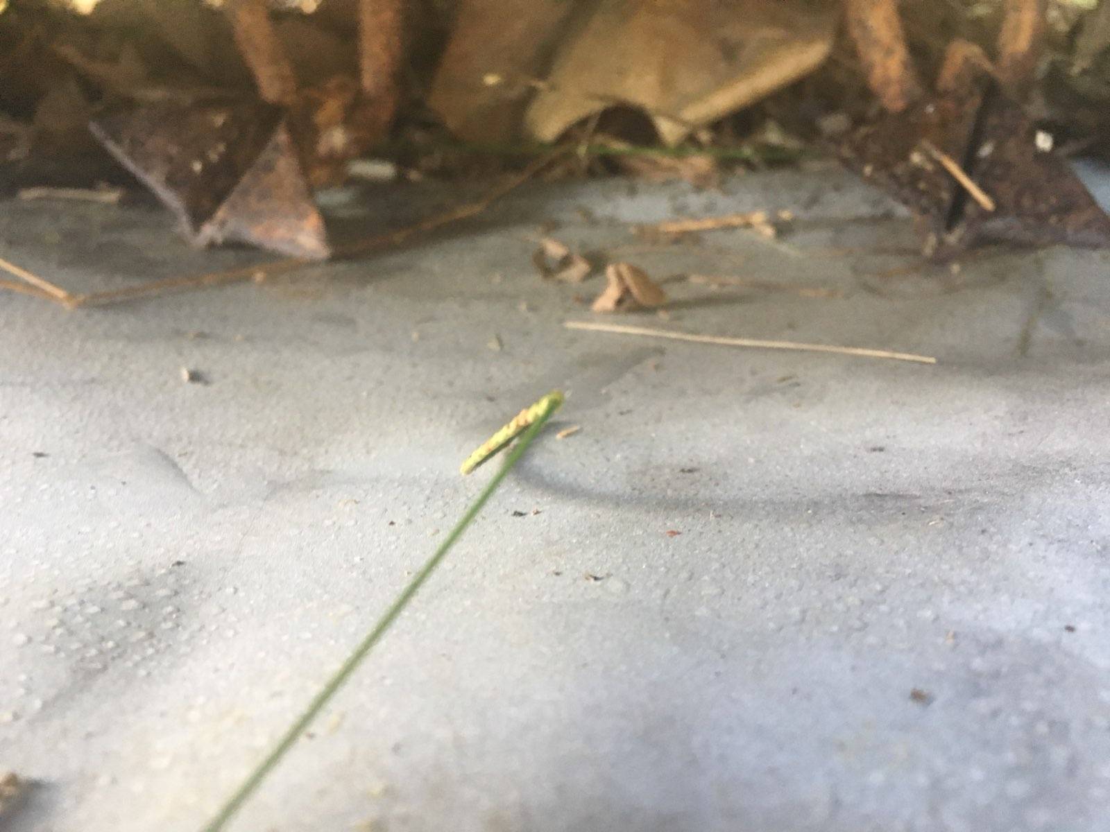

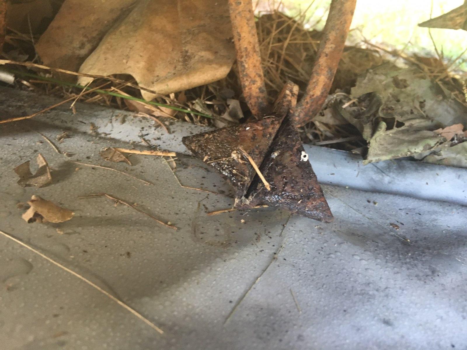

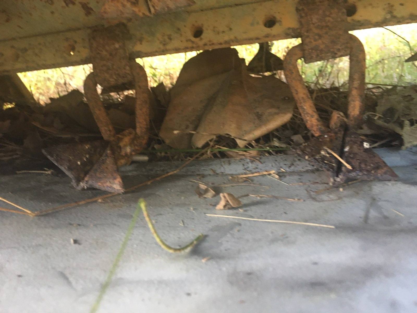

I'm looking at a used flail mower, Ford 917H. Can anyone tell me how much life is left in these blades? I can't tell if they are nearly new or nearly worn.
   / Let's talk flail mowers #6,968
Those are NOT worn out.
If you keep from hitting rocks they will last for more than a season or two. However, if you hit rocks they will break.
Note they can be sharpened without having to remove them with a angle grinder, but they don't need a razor sharp cutting edge.
Have the owner spin it up to speed and if it runs smooth and the hood/housing isn't all rusted though it should be a good mower.
