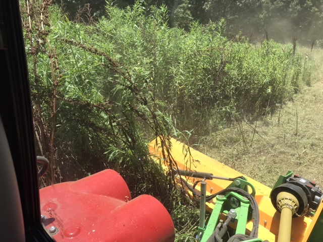

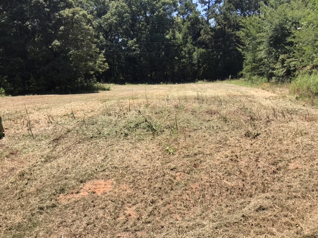

Ran my first flail mower today and I must admit it ain't half bad. :thumbsup:

Hllo and good afternoon K5Iwq,
I want to welcome you as the newest resident member of the "Flail Mower Nations" from the Great State of Texas, Mineola branch.
If you decide to recut it in a few days ypu will find that the clippings will mulch that much faster for you. I always suggest to the members that they can mow in a spiral pattern to avoid having to stop back up turn around and then return on the next pass as it saves fuel time and labor when mowing.
Happy Mowing
