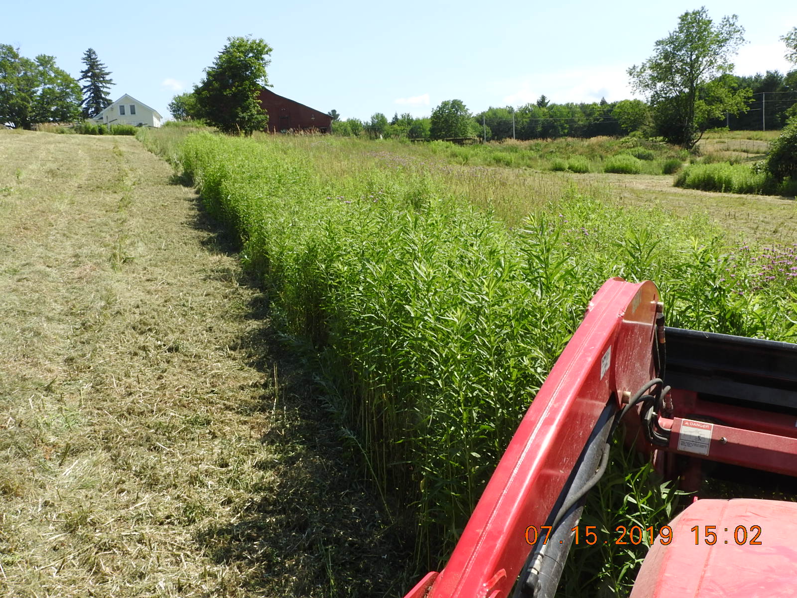

I was finally able to use my WoodMaxx 62H a week and a half ago. Had to wait for them to design and manufacture an adapter to make it Cat 1 quick hitch compatible. No way I can muscle 700 pounds to get it on the 3 point directly. Clearly someone, potentially not with authorization, changed the design of the lifting arch and it was Cat 3, not Cat 1/2 height from the 2018 and prior models. I don't know if they are shipping the adapter with the machine since it is sold as Cat 1 compatible or if one needs to request it.
@FarmLife4 - if you plan to use it with a Cat 2 QH, also order the bushing set from WoodMaxx and make sure you get the adapter (you might also want to get a tractor to pull the flail ;D). It consists of 2 heavy duty plates, a solid rod and a bolt with washers and nut that connect the plates to the slot in the lifting arch and a longer clevis pin since the one that came with the mower wasn't long enough to go through the adapter plates. I will say that is is very well made, very solid.
My tractor dealer had hoses made up so I could "borrow" the curl/dump function from the loader and got adapters for the flail's male thread end fittings plus the needed quick connectors. I connected all that and shifted the mower left, but one of the adapters leaked and I couldn't shift it back to the right. So I disconnected the hydraulics and mowed with the mower all the way left. I have finally gotten a replacement adapter at Advanced Auto (same store different guy, the guy the prior Saturday didn't have any. The guy last week said he probably didn't look in the Hydraulic section :thumbdown: )
Pictures of what I mowed and what it looked like. I got the knives, not the hammers/duck foot.
View attachment 614419 View attachment 614420
