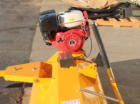

At work. Later tonight.
It's a regular 3 position switch with key - Off/Run/Start.
Unmount the whole key assembly. Cut & extend the wires 10' or so until they reach the cab. Splice them back together & secure them the the mower. No need to figure out what wires do what as long as you keep them the same. You get "remote" start & stop.
   / Let's talk flail mowers #5,773
That's good idea. I can even mount switch on whatever I'm using to pull mower with and make a plug on extension.
Thank you.

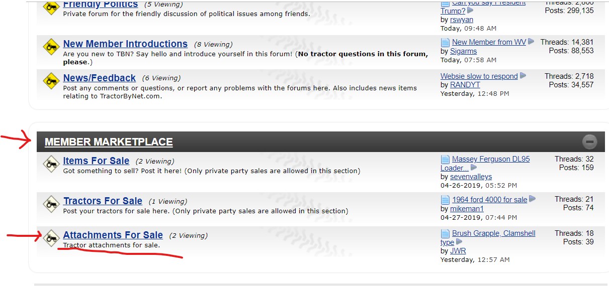

Since you didn't fill in your location, it would help to know where in the world it is located.
This Flail Mower thread is a good starting place. The next place would be a post in the "Member Marketplace", "Attachments For Sale" thread: https://www.tractorbynet.com/forums/attachments-sale/
Good luck and please keep participating on TractorByNet :thumbsup:.
