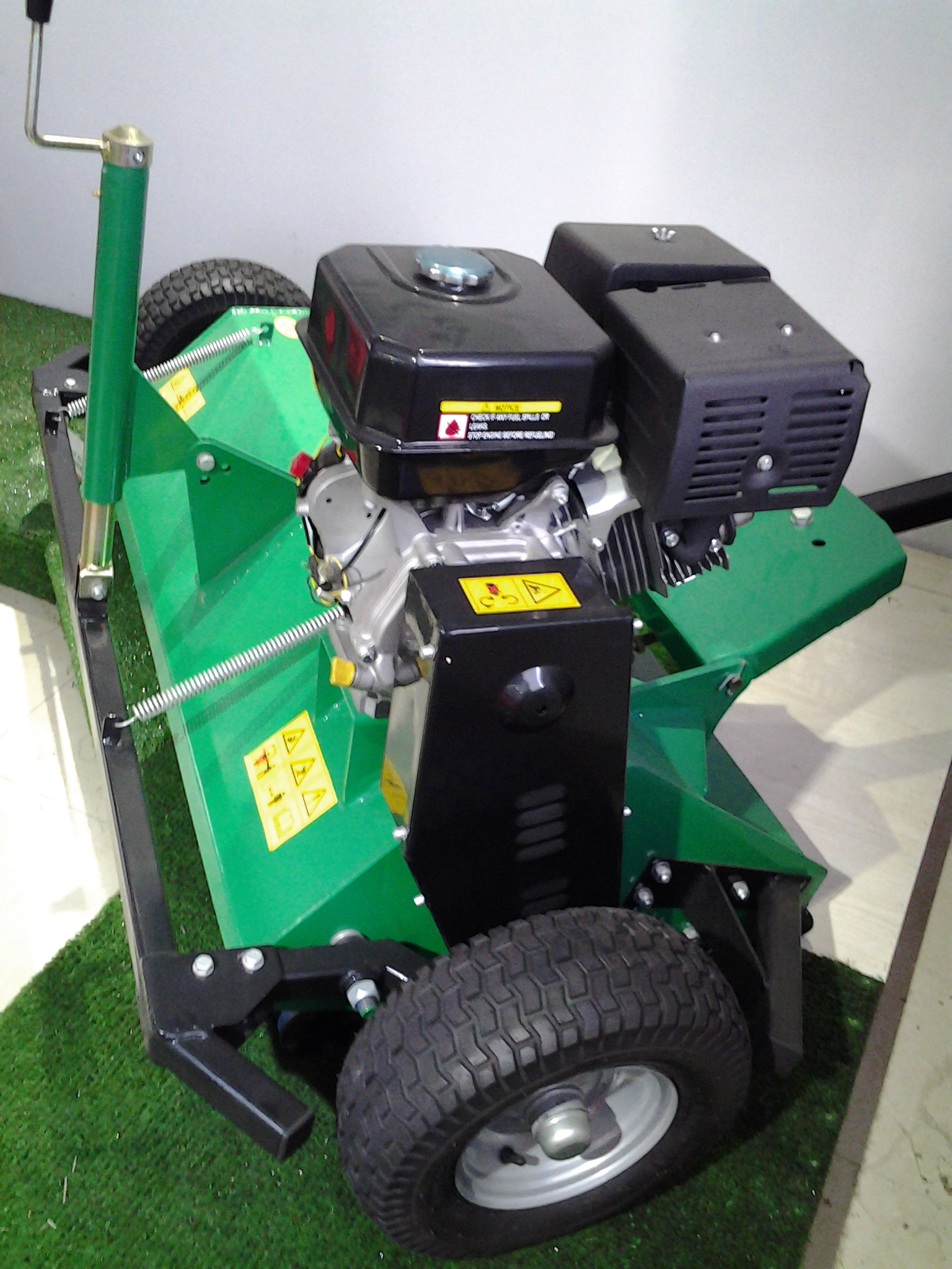

It is VERY solid. Solid and heavy. Thick gauge steel, thick welds. Blades do not get hurt, they do indeed bounce off obstacles. 3 belts. It'll last.
Best priced I could find, otherwise, they start at $3K plus and go up higher. There'splenty of PTO driven ones, tow behinds are mostly in England.
Hi ukrkoz, is its belt tension tightened by one single spring which is nearly half inch diameter? Like this one? 20140402_081619.jpg20140402_082316.jpg
According to the photos on their site, it looks like same belt tension system like this. This type belt tension system was proved not solid for years work. I think even Betstco didn't realize it, they started ATV flail mower sale not so long time. My suggestion is that you can buy some of that spring, clutch, belts in your stock.
I just want to know if that factory improved on this point. Thank you.
