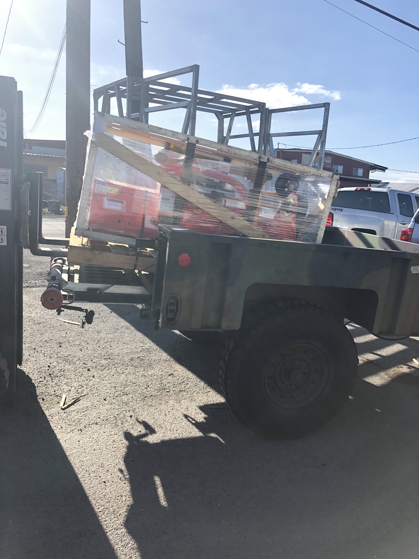

Amazing. I ordered the mower from Betst yesterday morning. It was shipped last night. I just got notification it is at the Fedex terminal in Sacramento ready for me to pick up.

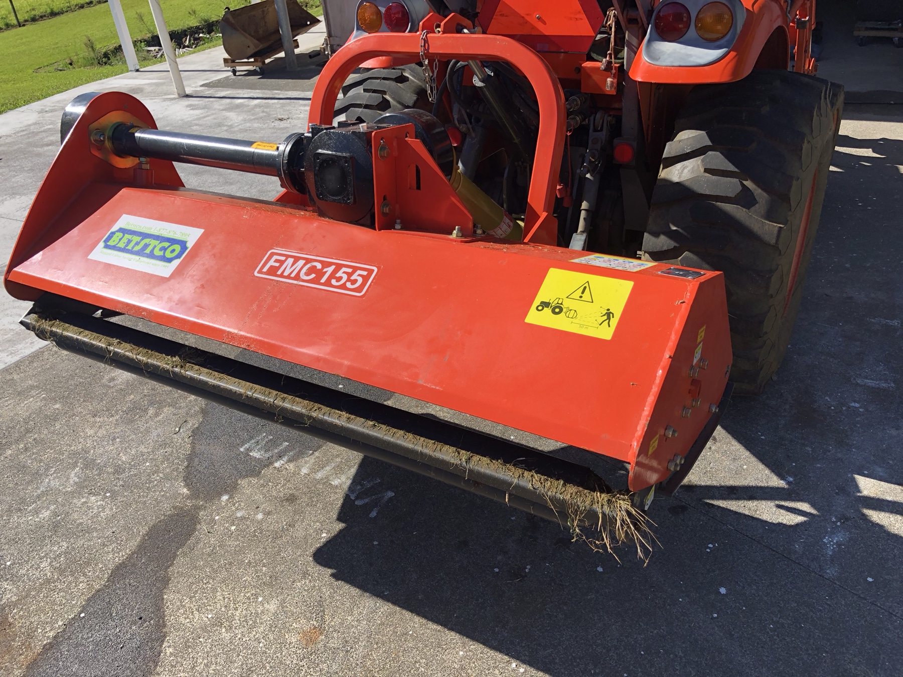

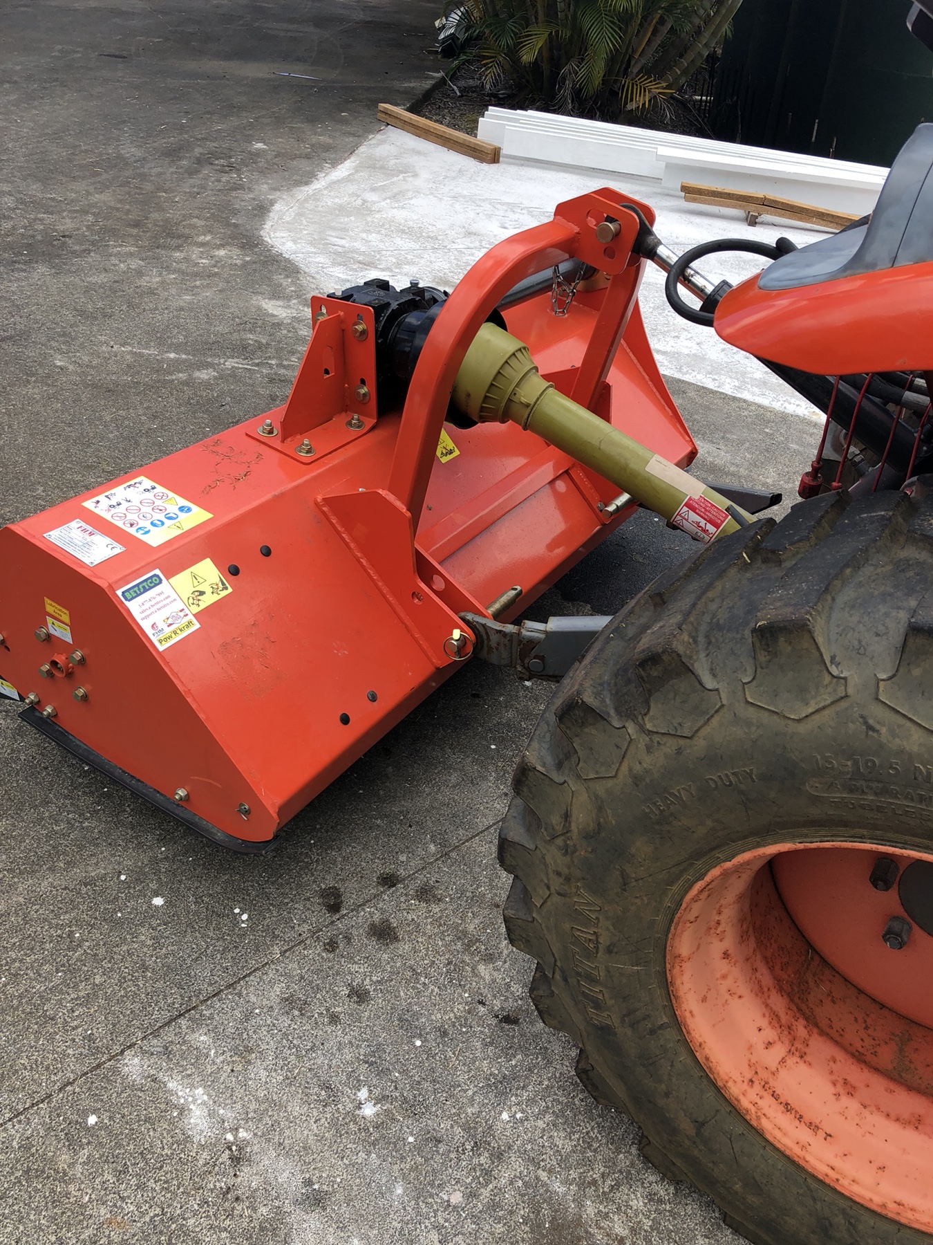

Picked up my new FH FMC155 from freight office Friday. Took a bit longer to get to Hawaii, bought on Mar 13.
This is my 3rd flail from Betstco. Somewhere in this thread is story of my catching 1st one on large root and racking mower. Sold it at decent price to a guy that would fix and resell.
My 2nd was the 195 with hydraulic offset. Nice, but I kept getting in trouble with wife with the edges digging in our less that flat and level property. Sold that one with my DX35 tractor last month and got the 155 in hopes going back to shorter length will keep me out of doghouse.
