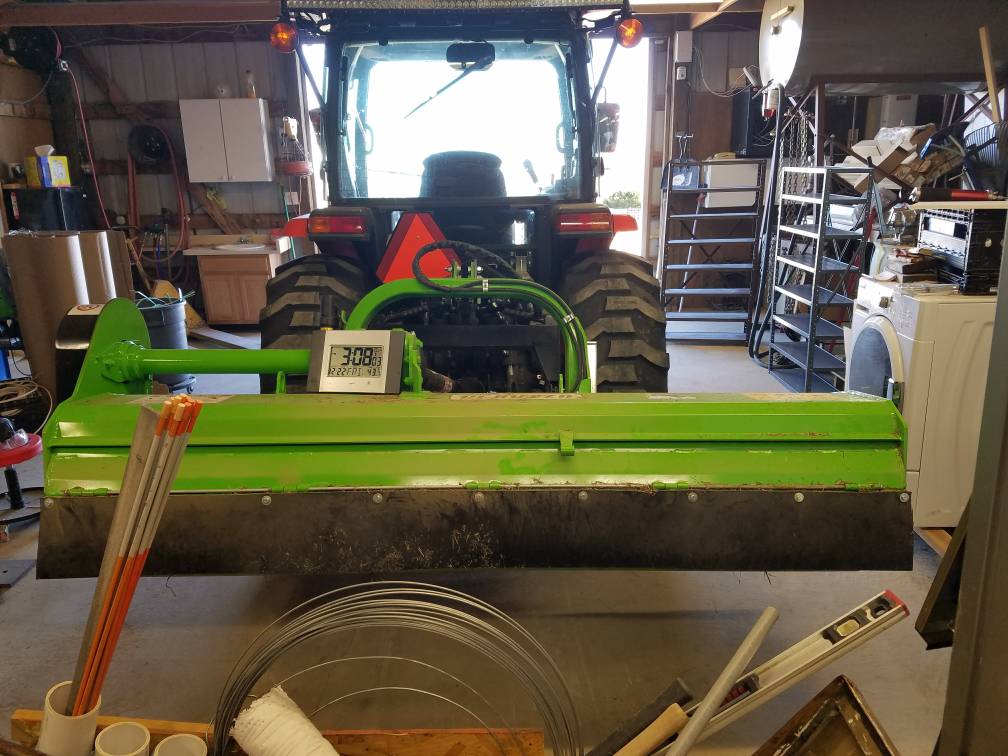

I wouldnt wory much about HP. I ran a 7' behind a 25pto HP L3200. You can compensate by going slow (especially with a HST).
I would heavily wory about your weight & width. Your TBL will be heavy for its class, but very narrow for a 4,000 CUT.
My L4060 feels it when I shift my Super Bull (1,700lbs 8'). When i offset it fully to the right the belt guard is even with the left tire. So despite being heavier it's likely putting less side torque on my 5,000lbs 72" track machine than that smaller mower would when it hangs way out. The heavy end of the mower & the gearbox stays on the left of or equal to the drawbar giving me some balance still.
I'm gonna guess that you could pull it off ok if the roller on the mower stayed supported by the ground. But if it came off the ground it might get pretty hairy quickly. 20171222_150735.jpeg
