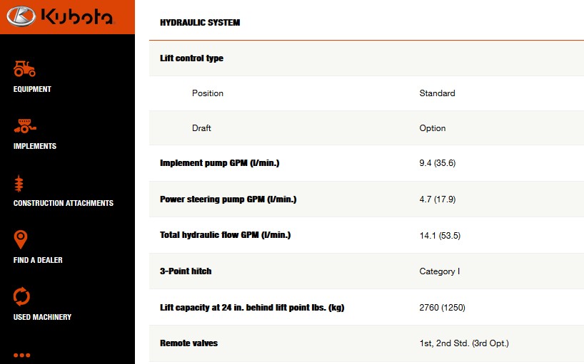

You have 2 pumps on your L4060HST. One for your Power steering and one for your Implements.The manufacturer adds them together to give you give you "Total Hydraulic Flow" of 14.1 GPM. Considerably less than the 21 GPM you mentioned. In addition, you are only going to get the flow from the Implements pump of 9.4 GPM. See attached from the Kabota site:
https://kubota.ca/en/products/power-equipment/tractors/l60/l4060hstcc:
I definitely know that. Never bothered to look to see if it's a 2 chamber pump or a 1 chamber with a flow divider, but the effect is the same.
I was just pointing out what HP would be transferred to that flail based on common pressures & the stated GPM range.
I run a hydraulic SSQA on the L4060 & it has about half the HP (seat of the pants, a bit more calculated) that the PTO PHD on my old L3200. Other factors make it better over all (downpressure & ease of hookup), but it has way less power. Most CUTs can put out under 15hp at best via hydraulics.

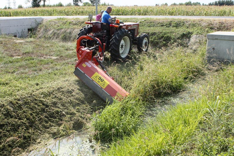

If you want to do "down" banks of greater than 15 degrees and not have one tire over the bank, you really need one that has the gearbox on the outboard of the belts rather than the inboard AND when swung completely to the right it should clear your tires. Otherwise you won't be able to get the full downward motion.
The videos show them doing banks but notice that right tires are always on the down slope.

Have one similar to the one linking. It does swing out far enough to do the steep banks. Mine is around six ft

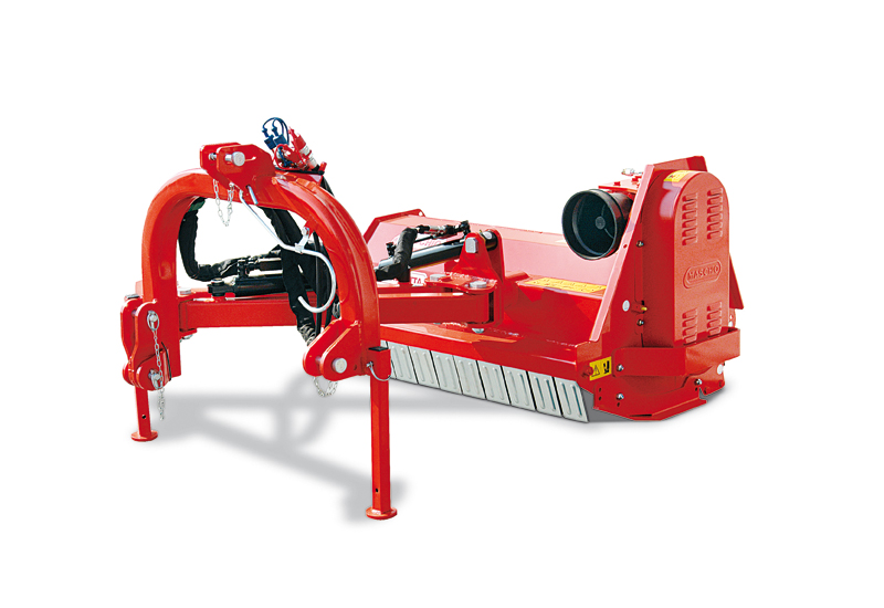

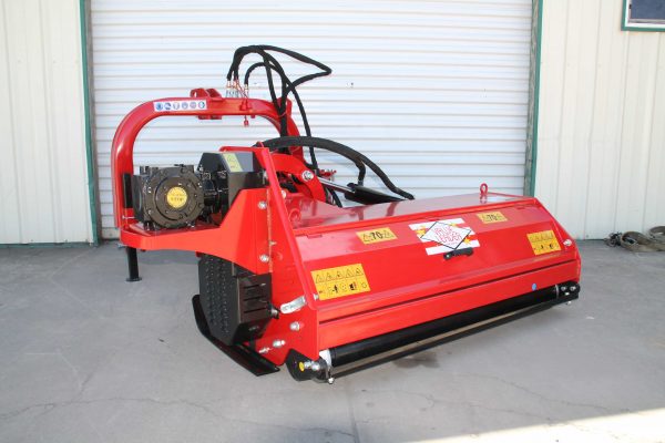

I wonder if anyone has any experience or thoughts about this flail mower. It would be perfect for getting into all the hard to clean up areas of our property.
48" Ditch Flail Mower (Embankment), EMSD-12 from Victory Tractor Implements 68665944583 | eBay
I use a similar model with my L6060. It's a 72" Maschio Girafetta offset flail
It cuts banks with the right tire on the level as shown:
The trade off is the cutting path on the level with the head fully retracted is not centered with the tire track and the left tire rolls over an uncut surface. This forces you to mow in only one direction when on level ground. There is a model which does center but the slope cutting width is reduced.
