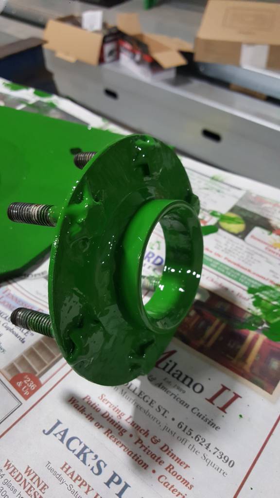

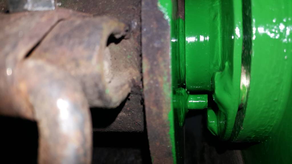

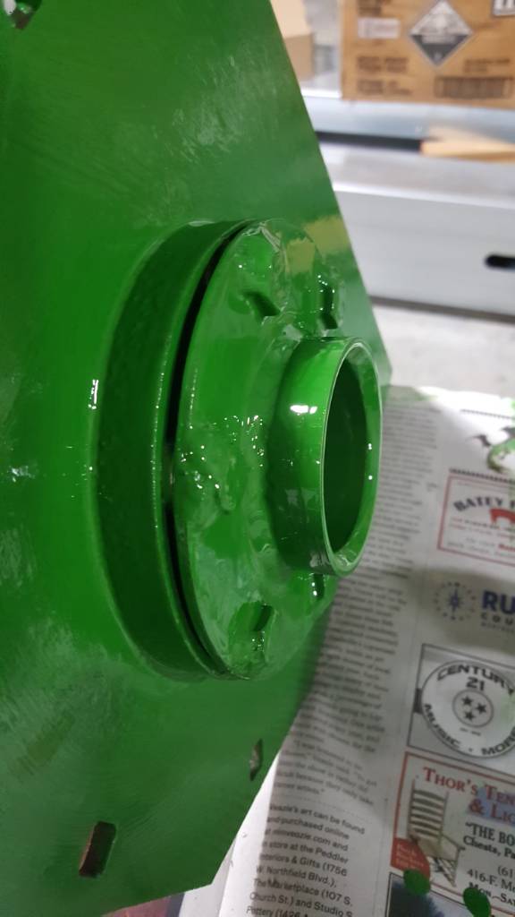

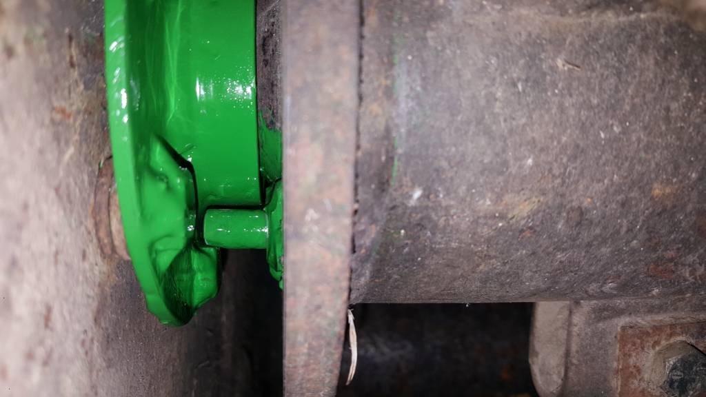

Finally got the anti-wrap modification on my JD 25A complete. Rotor spins great. Welded the original bolts to the washer plate to make a stud plate with collar. Rotor has about 1/8" axial and radial clearance. The design is similar to what is on my JD390. Just need to add some paint to the drive end plate and covers and it will be ready to mow.

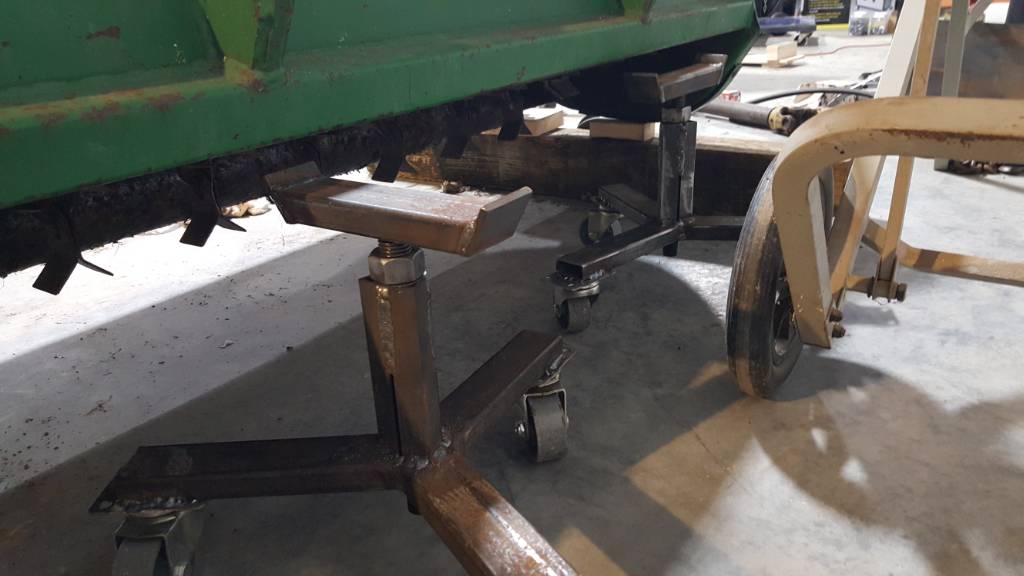

I included a pic of the jack stands on casters that I made to allow me to support and move the rotor when replacing the bearings or pulling the rotor. The stands work great and can extend from 12" to about 21" tall. They will be put to use again when i add the grease zerks to the rotor bearings on my JD 390 Flail. 20190226_200920.jpeg20190226_200859.jpeg20190228_055648.jpeg20190228_055912.jpeg20190228_055842.jpeg

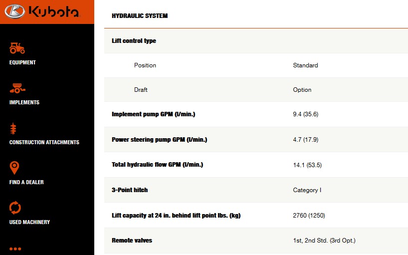

   / Let's talk flail mowers #5,710
13gpm @ 2,500psi (tractor standard) = under 19hp
21gpm @ 3,000psi (common on skid steers) = 37hp
Seems a little underpowered to me. Especially when you factor in hydraulic being less efficient than PTO. Of course this is coming from somebody who ran a 7' flail on a 25 hp PTO (L3200) machine ok.
A tractor of appropriate size for that will not have enough hydraulics to run it. Doable for a skid though.
You have 2 pumps on your L4060HST. One for your Power steering and one for your Implements.The manufacturer adds them together to give you give you "Total Hydraulic Flow" of 14.1 GPM. Considerably less than the 21 GPM you mentioned. In addition, you are only going to get the flow from the Implements pump of 9.4 GPM. See attached from the Kabota site:
