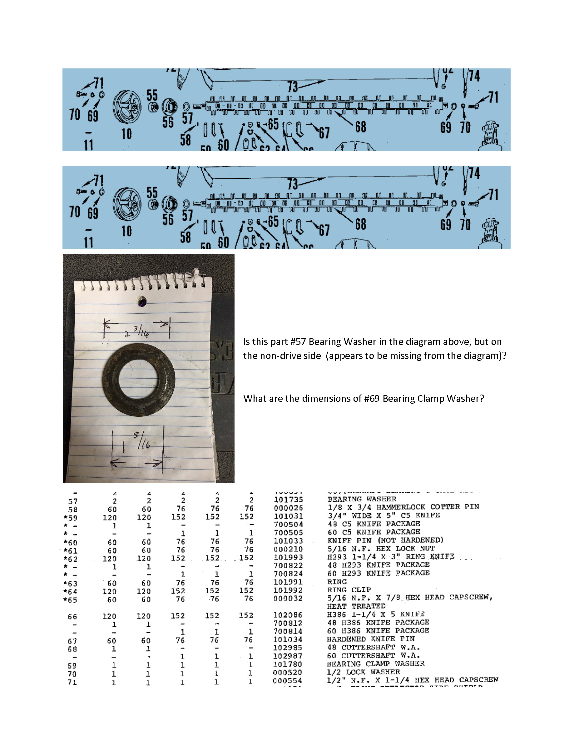

I am appealing to Flail Mower Nation for some assistance. I have a Mott 72 that had a bolt (#71 on the attached diagram) rattle loose that held the non-drive side cutter shaft bearing in place. This resulted in the bearing and a large washer working its way out and depositing themselves on the ground. The noise was not pleasant... However, the bearing is intact.
I have consulted the parts diagram which is lacking in detail. I have two questions.
First, what is the attached washer and where does it go? I don't believe it is #69, but perhaps the equivalent of #57 that is shown on the other side?
Second, what is the size of #69 Bearing Clamp Washer?
Thank you for any assistance!
Ed

The parts list says there are two #57 washers required. The diagrams only show one of each part regardless of the number required .... that's why you don't see 152 knives in the diagram.
   / Let's talk flail mowers #5,516
Thanks Whirly. That makes sense, although I think I'd have still shown it on the diagram. Obviously, showing the 152 knives makes no sense. :)
