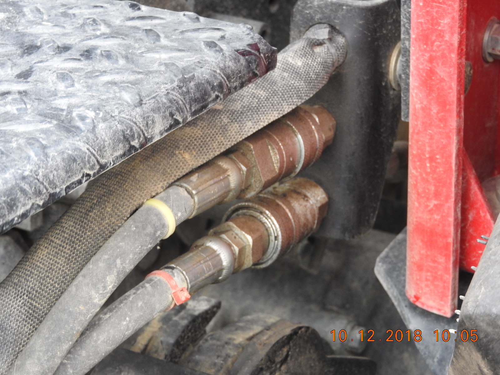

Stupid question I'm sure and maybe answered somewhere I've not found.
My tractor has rear remotes for the backhoe which has its own controls. How do you control the side shift on a flail? The hoses connect to the rear ports on the tractor but that doesn't give you any control. Does someone make a "control box" of some sort that you can connect to the rear ports and connect the flail hoses to that? I know some people get long hoses and "steal" the bucket dump from the loader control. Wondering if there isn't maybe a cleaner solution, small box with a single lever control or something.
Thanks
   / Let's talk flail mowers #5,506
What you're looking for would be called an Open Center valve.
Your tractor probably needs one that is rated for around 8 gallons per minute, something along the lines of this: 1 Spool 8 GPM Prince MB11B5C1 DA Valve | Directional Control Valves | Hydraulic Valves | Hydraulics | www.surpluscenter.com
Depending on if you have two or three lines that would connect your backhoe, you may also need a power beyond kit for that valve.
The way the hydraulics on your tractor work, the hydraulic pump is always pumping fluid through the system, the valve diverts the flow from being pumped through the open loop to going into your cylinder to extend it or retract it depending on which way you move the valves.
When it does that, the pressure will rise from the 100 to 500 PSI that it is at when you're not doing anything to whatever your system relief pressure is or whatever pressure is needed to move the cylinder whichever is lower.

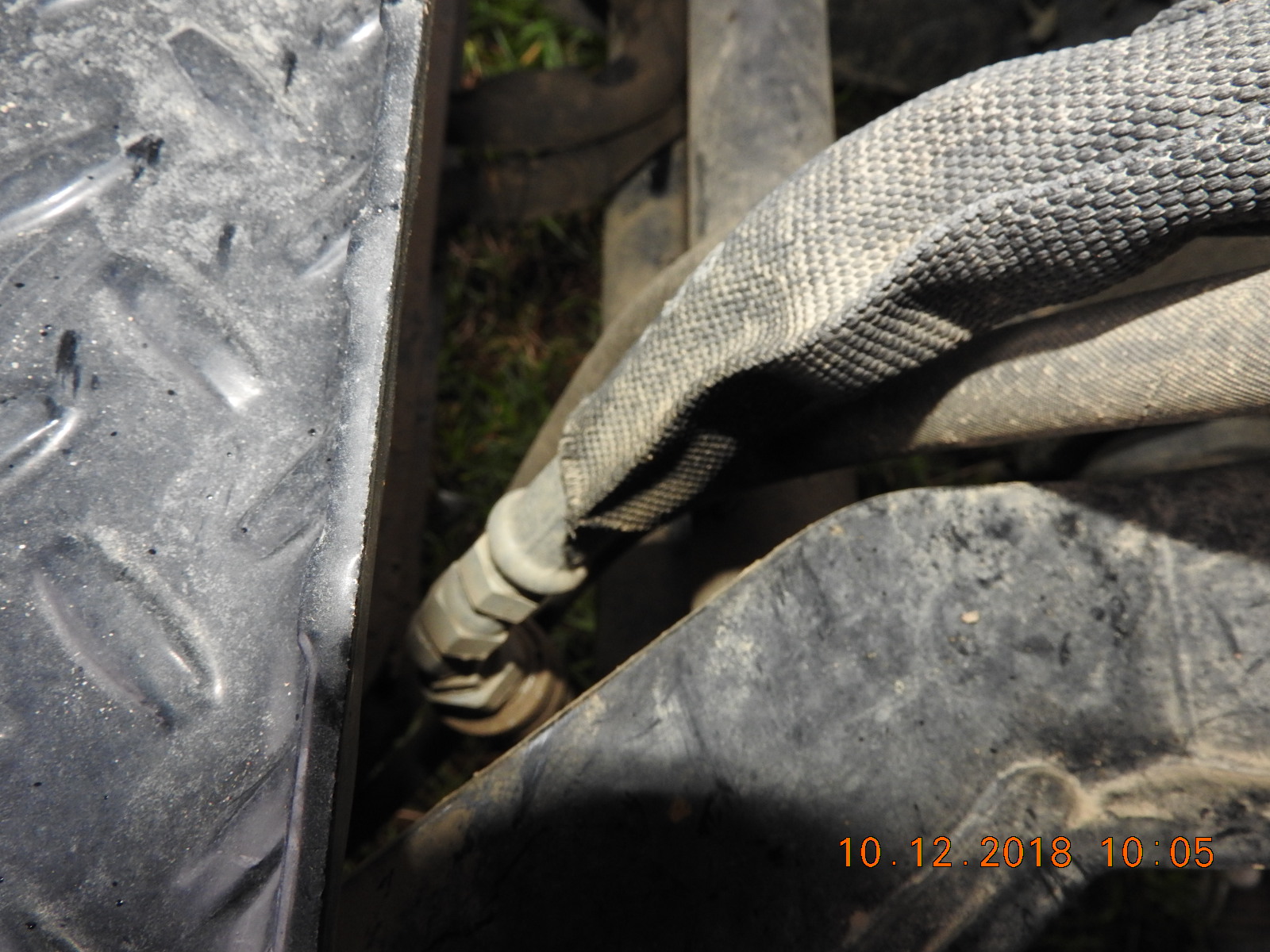

Thanks Aaron.
There are 3 hoses. The manual says that the female hose connecter must be put into the male connector (lower in the picture) when the BH is removed to "keep the tractor from going over the main pressure relief". The female is on a hose that comes out past the fixed connectors on the back of the tractor and goes down under the BH footwell DSCN1322.JPGDSCN1323.JPG
Of course there is then the question of where to put the spool valve. Starting to wonder if it isn't easier to just steal the loader dump function. 2 hoses about 5' -6' long each.
