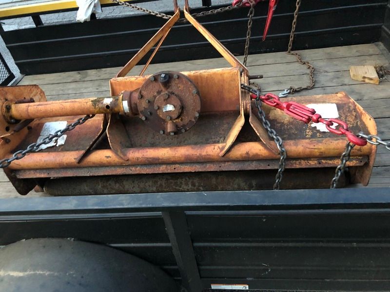

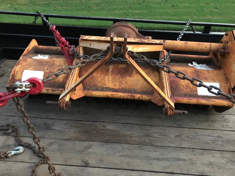

I picked up a Mott model 60 Hammer Knife fine cut this month. Got it for a steal at $300, but replaced both cuttershaft bearings and the belt for a quick $300 more. There is a pronounced gear whine under load, so looking for suggestions on diagnosis and possible gearbox rebuild. It cuts very well, like a finish mower without the windrows.
   / Let's talk flail mowers #5,527
Grease and gear oil checked? I would assume since you did the other repairs you checked but it's just a reminder in case ...
   / Let's talk flail mowers #5,528
Yes, everything greased up. I would post a video with sound but not sure how to post it
   / Let's talk flail mowers #5,529
Put it on Youtube and post the link.
