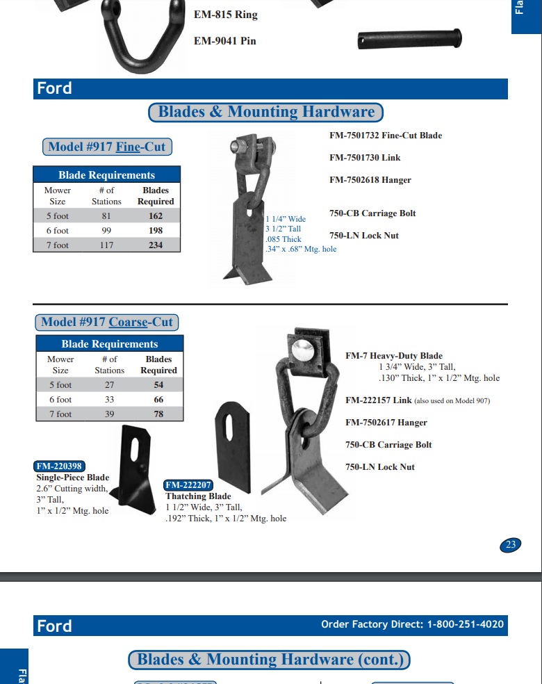

not trying to argue, just respectfully point out my opinion but I just don't see how side slicers generate enough lateral force to overcome the centripetal force acting on the knives at full operating speed. I don't know the math but I do know with the weight of the side slicers turning at several thousand rpm the force required would most likely be in the several hundred pound range if not in the thousands.
example hang one knife from the hanger and it will hang crooked because it will balance its center of gravity under the attachment point. hang two side slicers and they will touch each other and the vertical parts will be straight. there is no way to generate lateral forces to seperate the two knives with a plain flat profile like most typical side slicer knives.
that being said, I have never seen a picture of these airplane wing shaped knives before and would appreciate if someone could post one. all I have seen are plain stamped steel side slicers, scoop knives, or hammers that are in the flail master catalog.
Take a look at the attached image. The airplane wing is on the left.
I agree about the lateral vs centripetal force and have seen pictures of the side slicers leaving v-shaped groves in a lawn. When you go with a finish mower using the side slicers you over lap and have smaller v's so it isn't apparent, but they don't go flat.

The tool less mounting stations on my Mathews Company Lawn Genie Pick Up Mower mower are spring tensioned knife hangers. The wide loop hangers allow the side slicer knives to become horizontal when the flail mower spins up to the operating speed and cut flat. with the tapered side slicer knives.
The Mott folks recommended that the thatching blades were ment to be used alone in each mounting station when dethatching a lawn.
With the Lawn Genie when the thatching blade is placed between the side slicers on the mounting station the side slicers and the flail mower rotor are lowered with the mowing height gauge to permit the thatching blades to dig into the turf.
When this is done the process of thatching begins and it allows the side slicers to mow closer to the ground and lift the thatch and grass up and over the flail mower rotor. In my case the baffle plate is lifted and the air flow is diverted to flow upward into the collection basket for later disposal. The side slicer flail knives also create the aerodynamic lift needed to vacuum the grass and thatch into the coolection hopper with the tapered side slicer knife edge that becomes horizontal due to the ability of the knife pairs to become air foils due to the long mounting slot of the side slicer knife.
When this is done the grass really looks naked with the grooved vacuumed turf and you can spread grass seed, gypsum and lime pellets or hydrated lime to help the lawn and help kill the weeds with the lime pellets or hydrated lime
Again the airplane wing knives ARE WHAT ARE REFERRED TO AS "SCOOP KNIVES". The delta wing configuration is simply a result of the thinner bar stock being formed into shape to create the Scoop Knife after the mounting hole is punched and the knife edge is ground.
The "Scoop Knife" is a "multipurpose flail mower knife" for brush and sod and does not provide a fine finish cut.

I have a hard time believing this. The laws of physics disagree with this theory. Do you have any proof that this actually happens? I've seen nice lawns mowed with side slicers and you can see the "V" shape left by the side slicers proving that it doesn't go horizontal.
Airplane wings are not scoop knives. They are made differently and hang differently. The scoop has a single blade that goes all the way across the front, parallel to the ground and sits out front of the hanging point. The airplane wing has 2 small blades that are parallel but sit directly below the hanging point. Airplane wings are specific to Ford 917 (and I think 907 and possibly the Ford made Bush Hog) mowers. The design and manufacturing of the two are different.
And the scoop knives provide a good fine finish cut if they are sharp. Someone else (I think on this forum) swapped side slicer for scoop knives on a Caroni and got a much better cut than the rough cut side slicers.
Each type of knife has it's place. Hammers are good for cutting anything, including rocks, but don't leave superior finish. Large side slicers are good for rough cutting, but leave "V" shapes. Scoops are good for rough and finish cutting (but not the best at either). Small side slicers are good for fine finish cutting due to the number of blades and overlapping.
