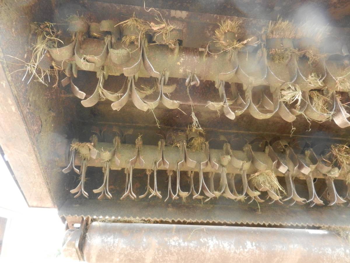

   / Let's talk flail mowers #5,368
Just discovered that Alamo made a dual rotor flail mower called "Grass Gator". It must not have been very popular because it is no longer produced.
