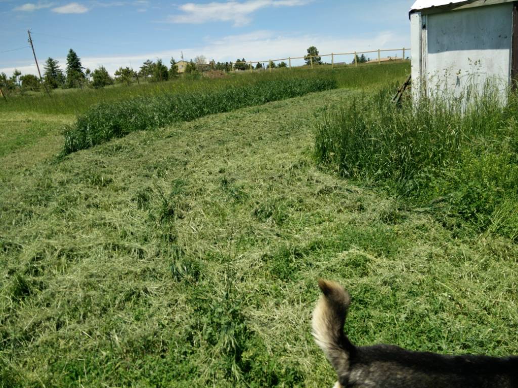

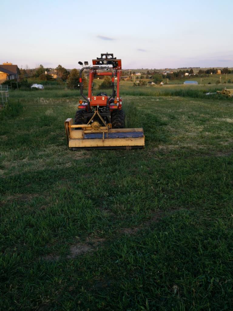

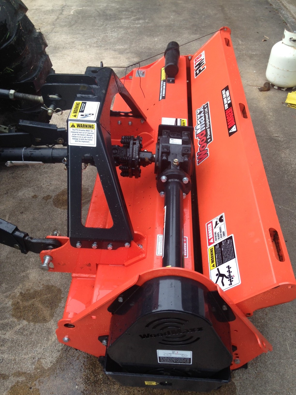

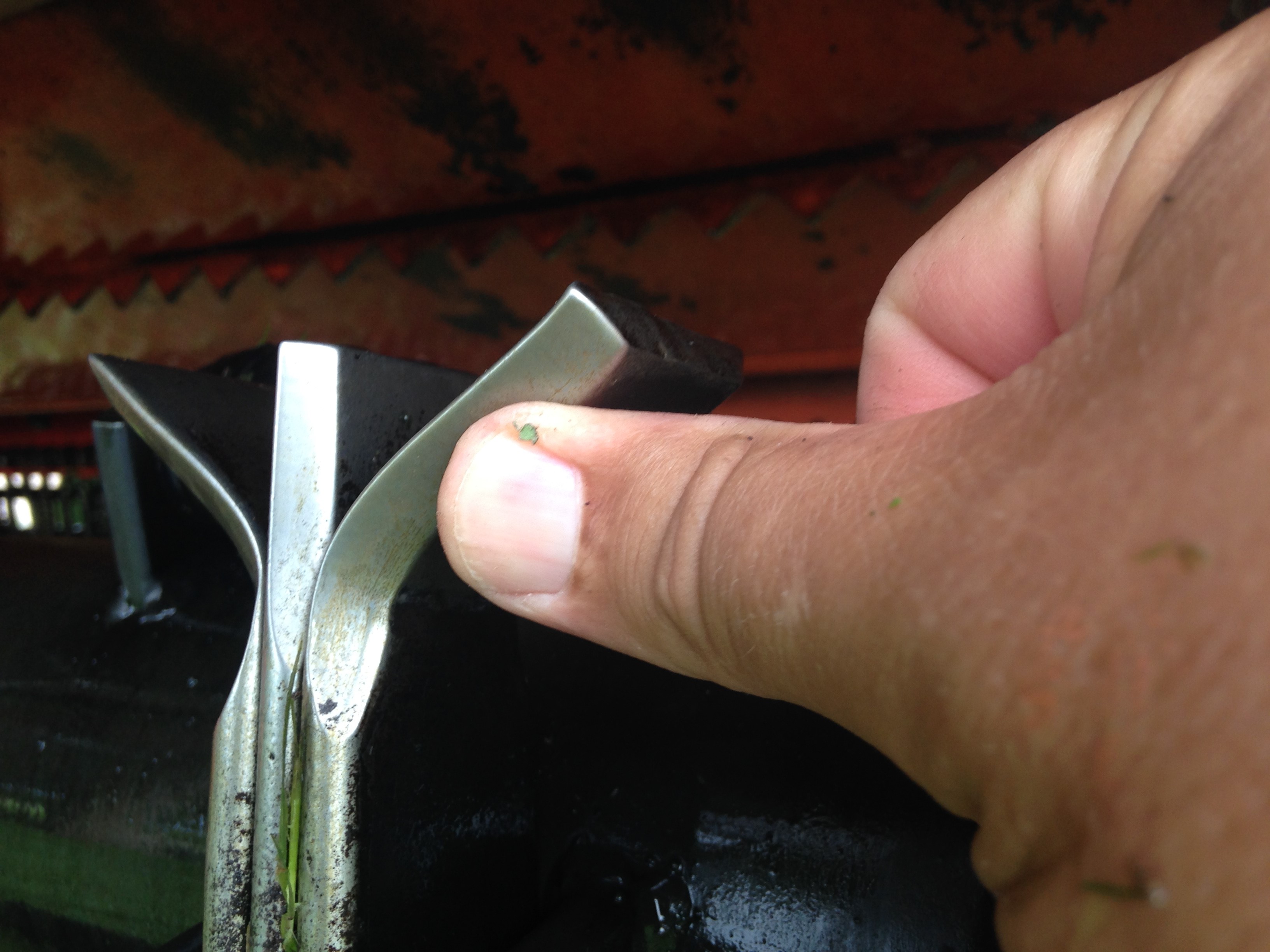

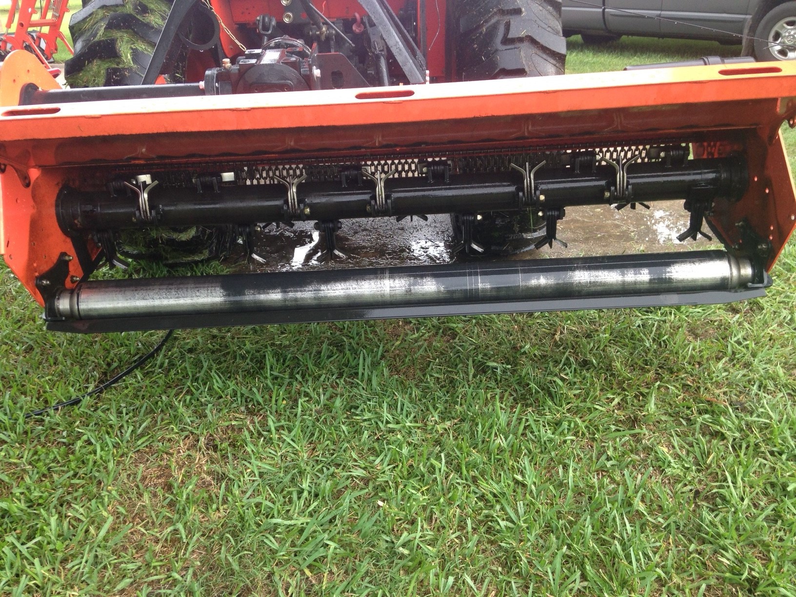

I guess I have about 20 hours on my Woodmax FM78 now. Cleaned it up last night and inspected things before I put it back in the barn. Didn't notice anything out of place or unusual. I'm happy so far. It will leave some tall clumpy weed stragglers sometimes, but most grass it cuts up fine and the clippings decompose quickly which is what I was looking for. The knives are going to last a LONG time just mowing grass, especially since I can flip them around at some point.

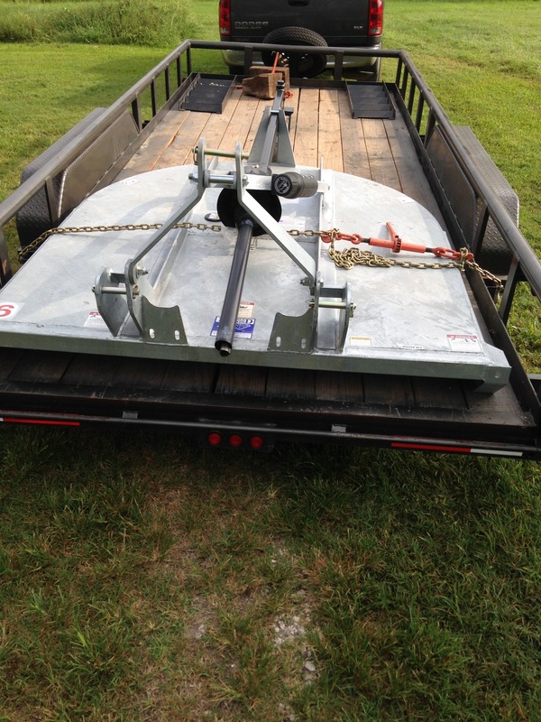

PS, the 6ft Modern Manufacturing Super Sunshine brush hog is for sale. Like new. Will deliver in the Houston area.

Excellent photos & description, StuartDK45SE, thanks!
What have you experienced so far with the "solid state" (as described at the Woodmaxx site) belt tensioner? I wonder about the longevity of such a device in a tractor implement subject to the acidic grass residues, shocks, and vibrations that a flail mower experiences. On the other hand, a lot of tractor components are solid state these days...

Unless I missed it. The poster purchased a 54" model that did not have rear door and tensioner. My FM-62H has all the features that come on a Woodmaxx. It is little over a month old.
Yea, that's the one. The point I was trying to make is that Woodmax shipped a unit without those features. They may be changing designs. So if those features are important it'd be a good idea to verify with them that the unit you order has them. The new one sounds a lot closer to the generic chinese EFGC units that you can get from a number of resellers.
Also Woodmaxx's minimum HP for their woodchipper is way lower than what I'd consider the real minimum. They rate my 8H at a minimum 19 pto hp. I have 32 and when chipping larger material I have to set the feed very slow. It's an 8" chipper but at 19 hp you're not going to be chipping material anywhere close to that size. While there's reasons to have an 8" chipper for chipping much smaller material, their min HP rating gives the impression that it'll be fully functional but slow. To me fully functional means chipping material close to the capacity. They may have the same low minimum for the flails. I'd compare with other manufacture's ratings for units of similar cutting width. It's not possible for one to be radically more efficient than others of the same design.... physics is physics.

I took the cover off the belts a while back an everything looked okay with no signs of slippage and the pulleys and belts were remarkably clean. The tensioner feature is one of the reasons I chose this model.
The Woodmaxx belt guard does look better than guards on some other companies' models, and I'm glad to hear that everything underneath looked good!

I noticed on my Woodmaxx 78 that after running it the main roller flail shaft is pretty hot the touch right near the belt driven bearing area. I greased it up but I plan to watch it as I do not want a bearing failure on a new tool....that would irritate me to no end.
