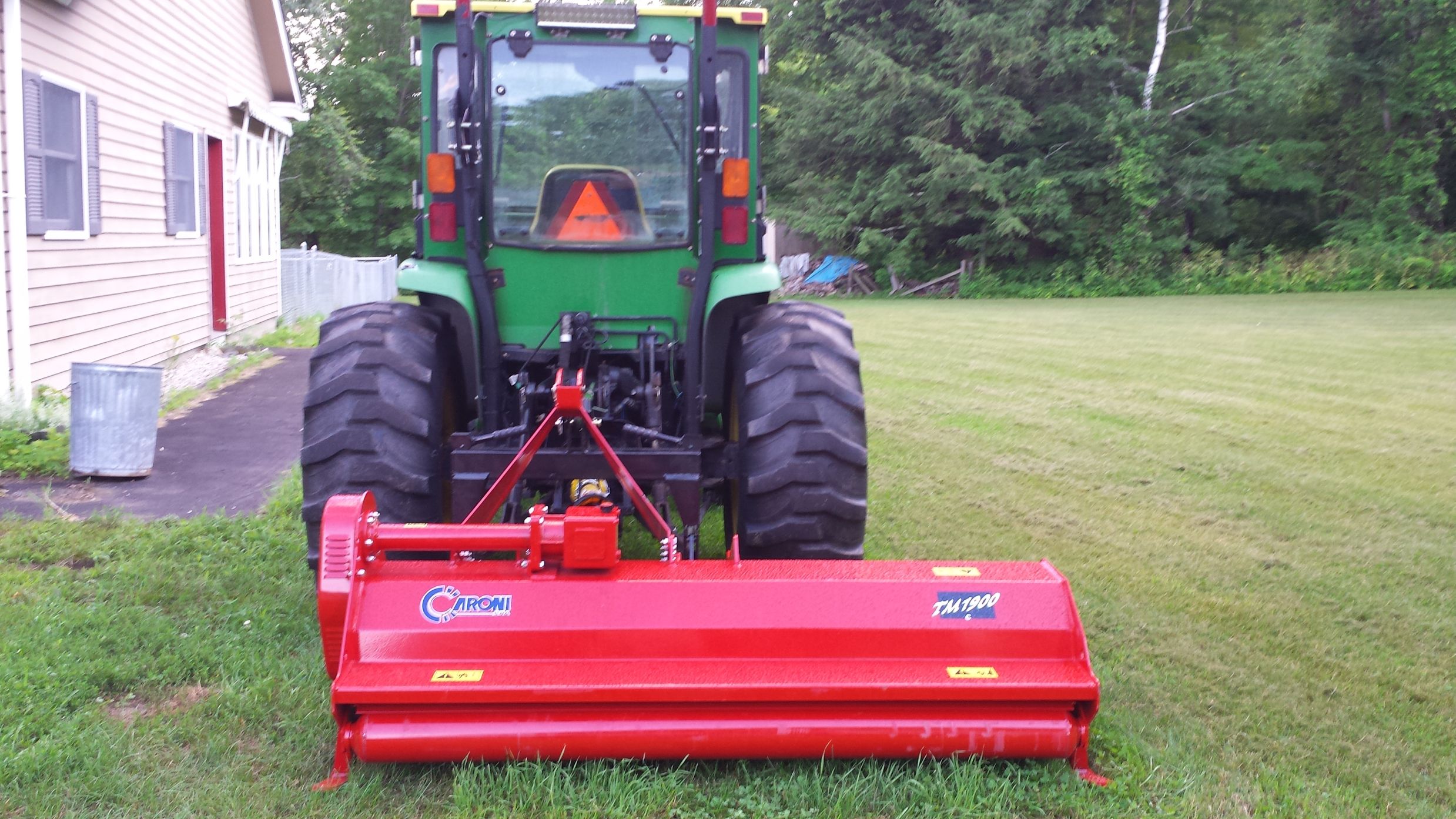

I don't believe the Caroni hydraulic side shift doesn't travel any further out then then the fixed side shift (the Caroni TM1 1900 mounting assembly (for the PTO and 3PH) can be positioned either at the centerline, or offset to the right around 15" or so as shown in the picture attached
I was thinking about the side shift kit...but it's a bit pricey ($800) and wasn't in stock when I bought the flail mower. Since using the mower, I've found mounting assembly fixed offset works fine for all my mowing.
There was a TBNer who did get the hydraulic kit and has a number of posts describing the assembly. Those posts are in this thread, if you've got time to go through 129(!!!) pages of posts!

It offsets more by several inches, and centers more as well when drawn in. You can get an idea from this picture:
http://www.tractorbynet.com/forums/...1523156106-lets-talk-flail-mowers-nv7webi-jpg
My setup process is here: Caroni Flail Mower with Hydraulic Side Shift kit - Album on Imgur
Unfortunately the shift rails restrict how high you can lift the mower without binding against the PTO shaft. For road travel and going up/down steep inclines (trailer ramps) the PTO shaft needs to be unhooked.

Can you attach two pictures to a response?
First...centered behind the tractor
Second...maximum offset
Take the pictures like I did...directly behind the tractor's centerline
