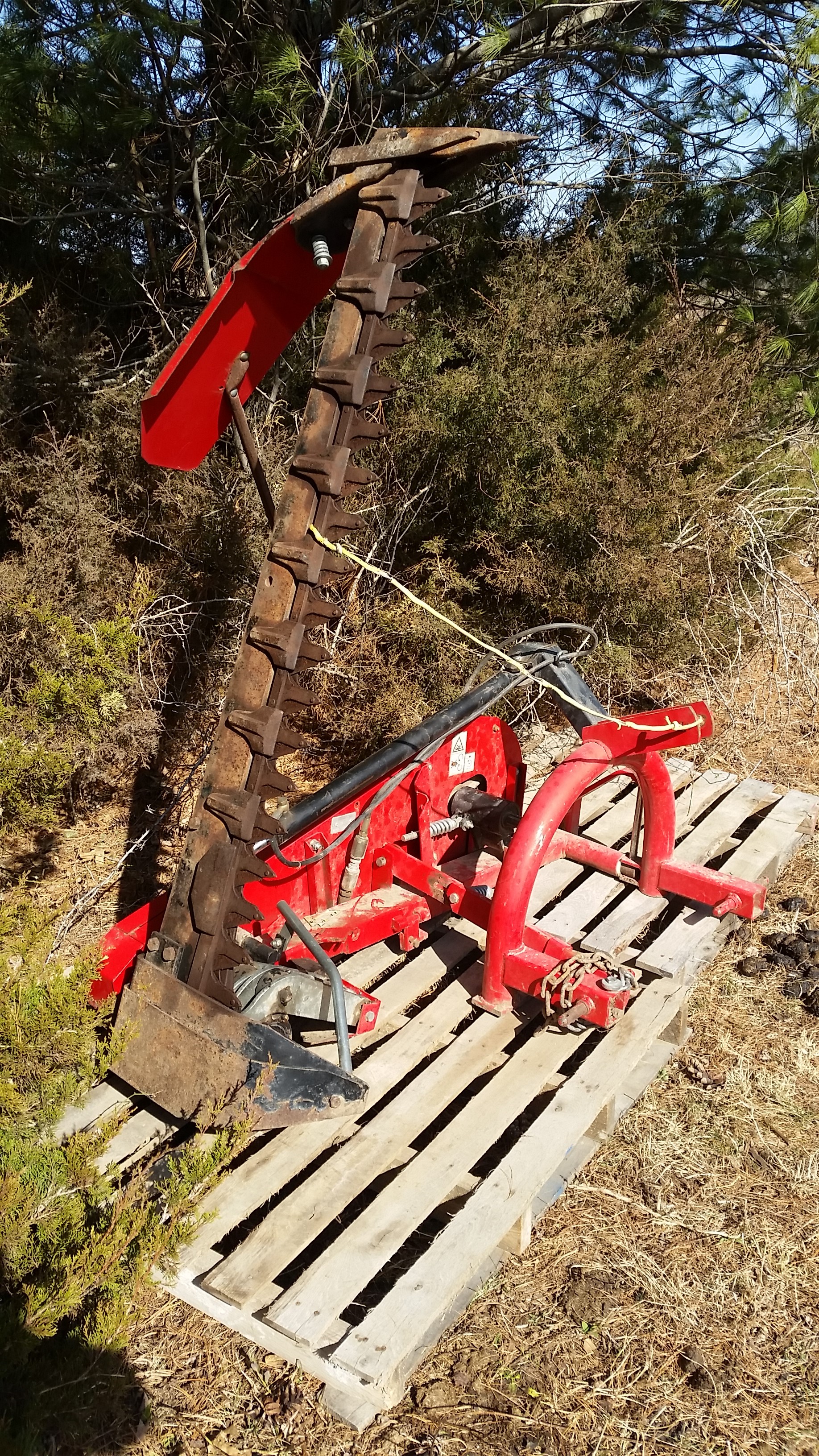

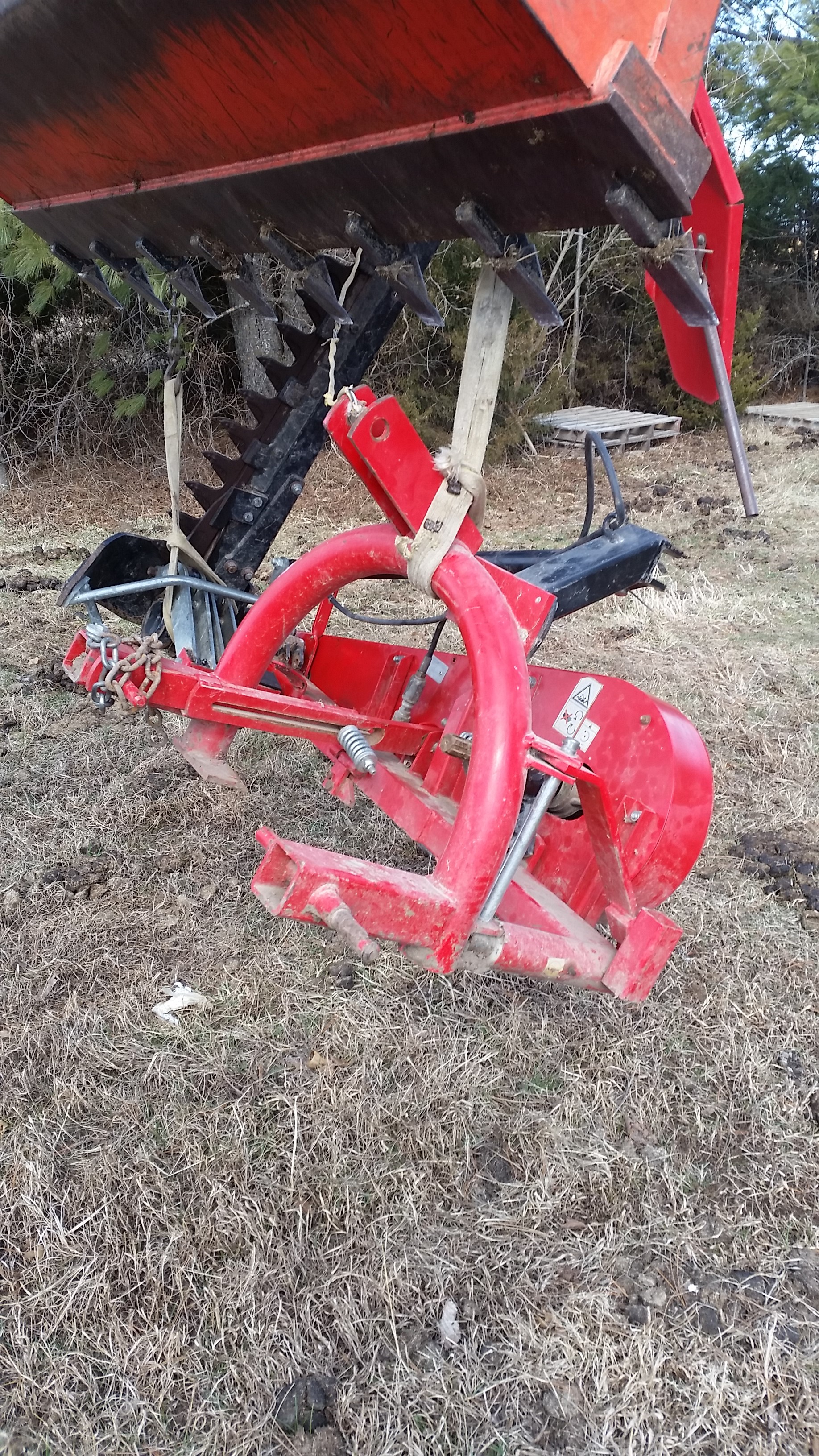

I've got a mower that will suit your needs. Be excellent for ditches, a bit short for much of a field. But you can't bog them down. listed on CL right now. EnoRossi 5' sickle mower with hydraulic lift. Can mow in straight up 90 deg and down to 75 deg. Model 150 CM. $1800 in excellent condition.

Can he purchase spare tiger teeth or a complete bar locally from a Hesston dealer?
Is it a hydraulic drive sickle mower with a #60 or #80 roller chain drive?
I have to go but I will check back later.
   / Let's talk flail mowers #5,166
It appears to be a belt drive, it is probably actually a model BF150H. You can see the implement end PTO stub shaft on the second picture and that there is only 1 hydraulic line (to lift the cutter bar).
Messick's has an ad for a new one for almost $4k and they list it as being belt drive: Enorossi BF15

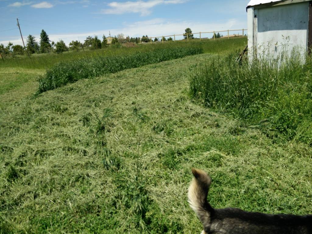

I picked up my Woodmaxx 78 today. I ordered it on 18 May. So a little less than 30 days. Some assembly and I did have to cut the PTO shaft a little but not anything that was a big deal. I lubed it up and set the height to max, I pulled the grease zerks prior and then re-installed after height adjustment. It is much easier to adjust the height once you have it mounted to the tractor and then just lift it up. You need to remove the gear box shield to mount the clutch pin. Comes in a very solid aluminum shipping frame.
I used t for an hour and all I can really say is I should have purchased one year ago......huge difference from bushhog cutter. I was cutting 5ft high prairie grass.

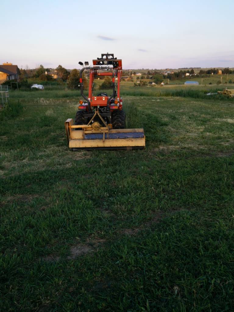

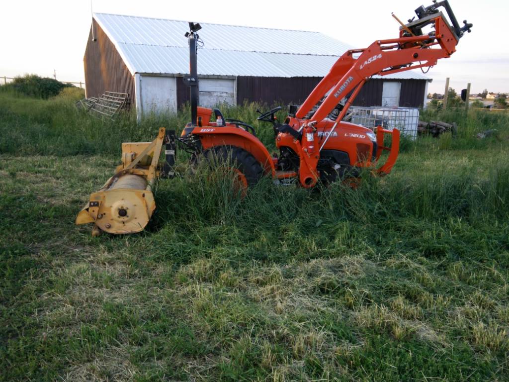

It will take bit more power than a rotary due to the extra mulching action. But I can vouch for the old beat to **** 917 doing good in over knee high green grass (which is about the worst possible conditions up to thicker than fingers woody brush material).
As somebody else mention Peruzzo makes ditch mowers that can be offset with the inside past the outside of your tires. My Peruzzo only side shifts 18", maybe 2' to the right from being centered. You are looking at double to triple what a Woodmaxx or Caronni flail will run though.IMG_20150626_200329.jpegIMG_20150614_130149-1.jpegIMG_20150626_200301-1.jpeg
