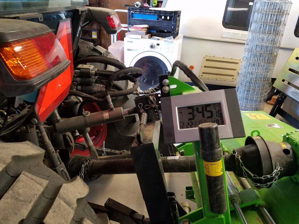

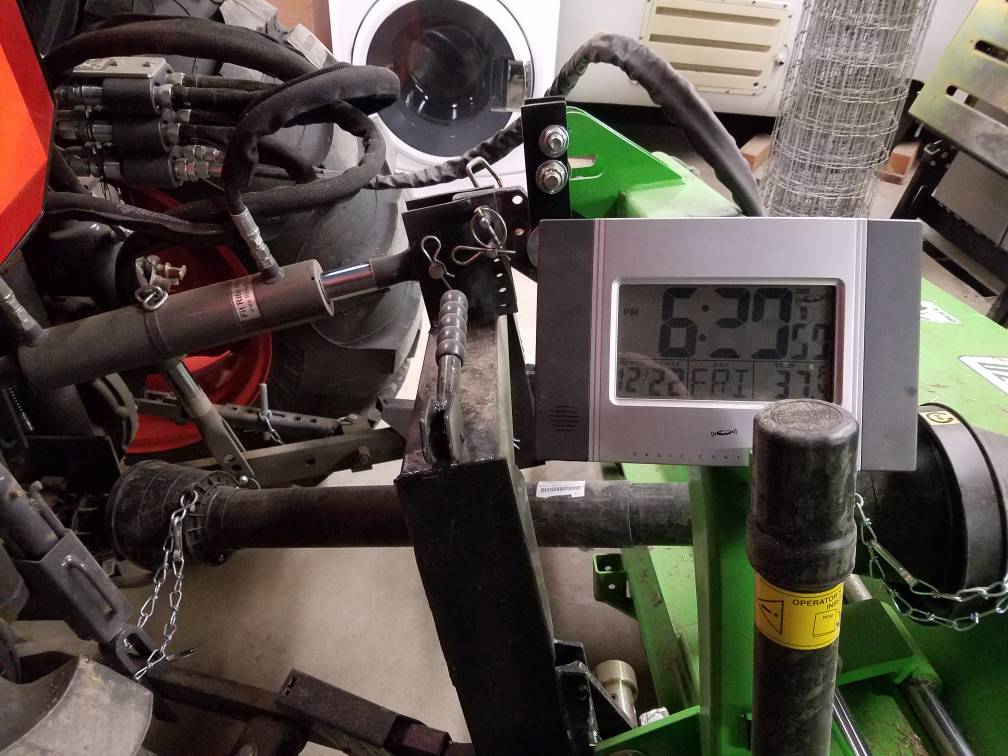

My new Peruzzo SuperBull 2200 had a quick hitch kit that was $100 or so. As near as I can tell it's just 2 pieces if bar stock & some bolts to lower the toplink. Unfortunately I don't think it lowers it to stock QH top hook height. The adjustable top hook makes that something I can work around though.
I also took a grinder to the lift hooks & pin mounts on the flail. Beveled things so the hooks would slide in as it was a bit to tight to line up when I got it.
Forgive the click in the photos. It's there to show how fast the crap Kubota rear hydraulic spools leak down (well under an hour for the side link, a few hours for the toplink... After the dealer "fixed" them). 20171222_182931.jpg20171222_154447.jpg20171222_150735.jpg

Hard to say as his clock blocks a view of his top link connection.

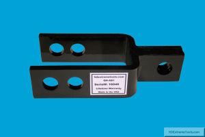

I may have bought something similar for my old New Holland 918H flail.
Unfortunately I sold the mower before getting a chance to try it out. Vic
The adapter is hard mounted with 2 bolts. It's not a flex adapter like what you pictured. No good flex hitch on the mower like on my old Ford 917 or wahat not. I have float on my toplink so that takes care of flex for me. I was wondering how the flail dealt with flex by default though as not everybody has a hydraulic toplink with float.
The 2 arms the lift pins are attached to on my 917 are in slots that give it maybe 5-10 degrees of float.

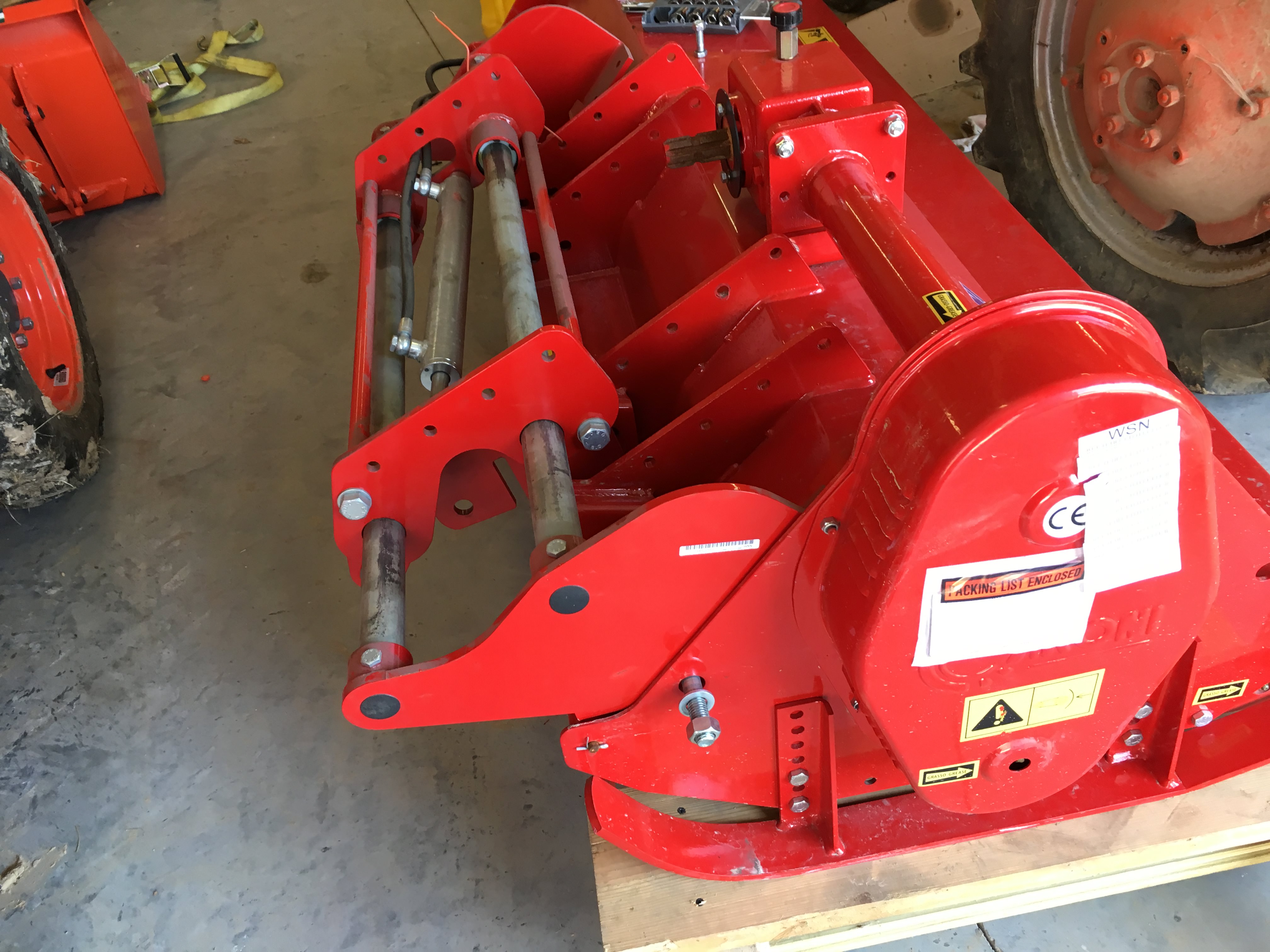

Well I finally have time to start getting the side shift kit onto the TM1900. The "directions" (if you can call them that) are TERRIBLE. I am trying to document the process in case anyone else can benefit from it.
To fit the side shift kit you have to take all the standard hitch equipment off.
This leaves you with the standard top link tower and lower 3pt mounts as spare parts (unless you take the slide shift kit off later).
The kit comes with it's own top link tower. It is different from the standard one
I dry-fit the side shift assembly on top. It's held on by a bolt and some wire. The cylinder mounts aren't lined up in this picture, so it won't normally be cockeyed.
One thing I didn't realize was that holes need to be drilled to mount the kit. I'm not looking forward to that. That's the next step, for another day. There are spacers that need to be inserted on the cylinder assembly, but I haven't figured out exactly how many or where. Different spacing is required for rear mount or front mount assembly, and the instructions aren't clear.
