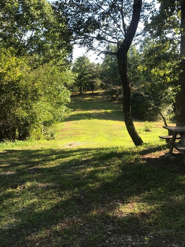

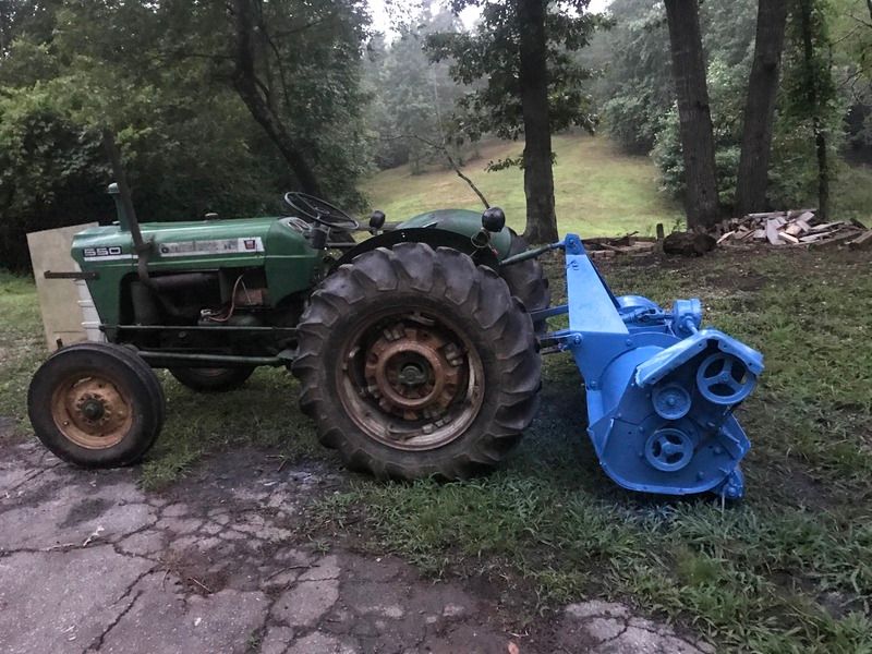

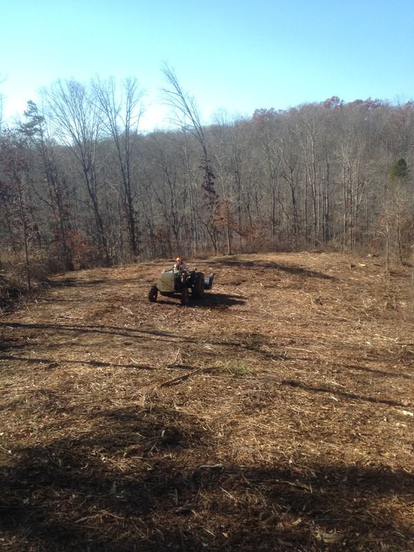

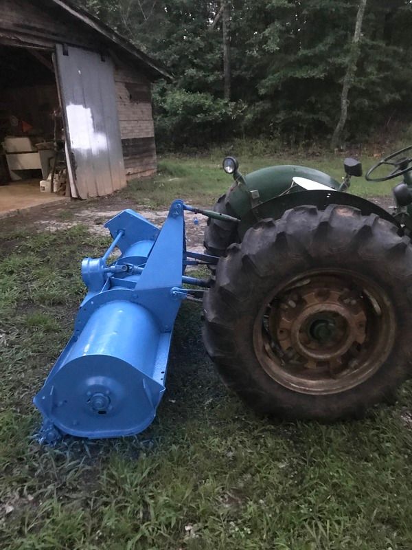

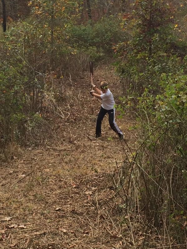

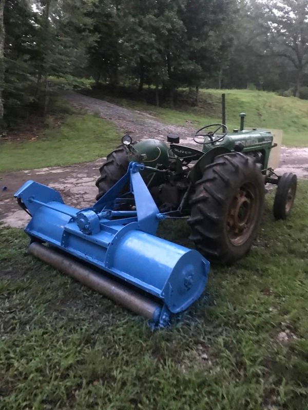

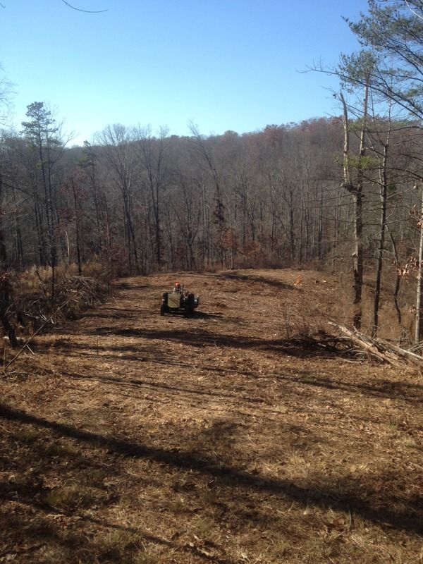

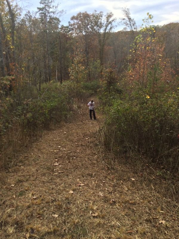

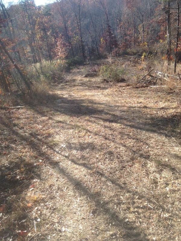

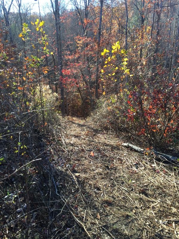

First time post, I picked up an old Ford 907 I found on Craigslist for $500. It is missing the rear shield, and the original knives were worn out. After replacing the blades (with the Mott style two piece Y blades) and belt, it has served well to clear my dad's property. He purchased about 34 acres in north Georgia that had been partially clear cut, leaving tons of stumps. His 1950s era Bush Hog (has a patent pending tag!) kept shearing PTO linkage pins, so we were looking for something that would allow clearing. We have monster briars in this area of the state if land has been left for several years. They are virtually impassible, and the dozer operators wanted $4-5000 just to get their dozer and full size excavator machines in there with all the stumps.
With the flail, I was able to start by backing the tractor in, weaving between stumps, and then setting it down and mowing out in first gear. Tractor is an Oliver 550, about 40 PTO hp, 1964 year model.

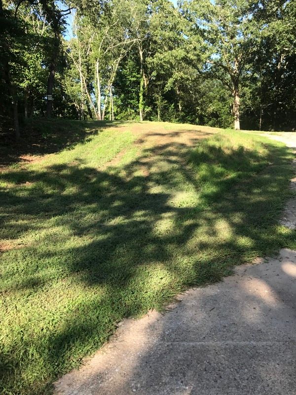

Here are some pics of one of the clearings before and after. My son is 5 deet tall in these pics, to give some idea. Once we were able to get close to the trees larger than 2 inches we could cut them with saws. Also got a stump grinder in, and now the area is mowable. Included some pics of other areas that have been mowed with the flail at about 4 inches.
As you probably already know flails cut for crap in reverse. But if that's the only way in, it's the only way in. Then cut forward on your way out to get a decent cut & mulch.
The Y knives don't do a great job on heavier brush, but as you noted they definitely can get the job done.

Yeah, I actually bought some Deere scoop type knives for grooming, but my links were worn and most places want like $5 per piece at 33 pieces. So I am currently looking for an Alamo. Found a used Rhino Rhd88 for $1000 locally. It looks to be about the same as an Alamo. Haven稚 pulled the trigger yet.
The Ford doesn稚 like to be spun at true 540, usually have to be just under or it starts to clank. Not super heavy duty built, but would work as a medium duty mulched cut if I can get another grooming mower.
