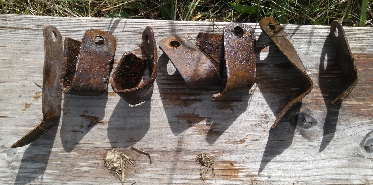

Those are finish blades. “Bent” or L shaped rough cut blades might be dulled but don’t bend with rock strikes as they are mounted via a clevis rather than directly to the rotor mount.
Correct. However the OP installed "96" fine cut blades which would have been L blades. The blades in the picture were my first set and that is what they looked like AFTER I managed to find all of the rocks and debris in my fields. Surprising enough, even bent they did a pretty good job in their last pass on pastures and the horses never complained about the cut.;)

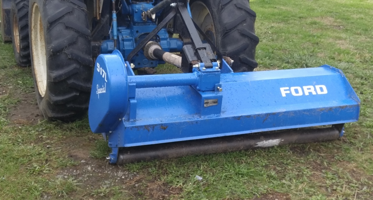

Thanks Leon
The blades I removed were in sorry shape, I wasn't joking when I said it looked like the previous owner used it to mow a rock garden. The photo is just a sample of what I removed and is pretty representative of what was on the machine when I got it.
I used Rustoleum HiVis Blue on the body of the mower but I thought black looked better on the attachment structure. I think it cleaned up pretty well.
I had to apply the lettering by hand using the outline that showed through the new paint. Doesn't look too bad from 15 feet away. 1-Bad blades.jpg1-Ford 917L.jpg

Thanks Leon
I had to apply the lettering by hand using the outline that showed through the new paint. Doesn't look too bad from 15 feet away.View attachment 525066View attachment 525067
Nice refurb!
   / Let's talk flail mowers #4,898
Thanks Rick, it was fun, frustrating and rewarding. It is the first project I've done since I retired this past July. I am really enjoying getting my hands dirty fixing major things like this as well as the minor fixes and upgrades, and personalization of owning a tractor and implements.
