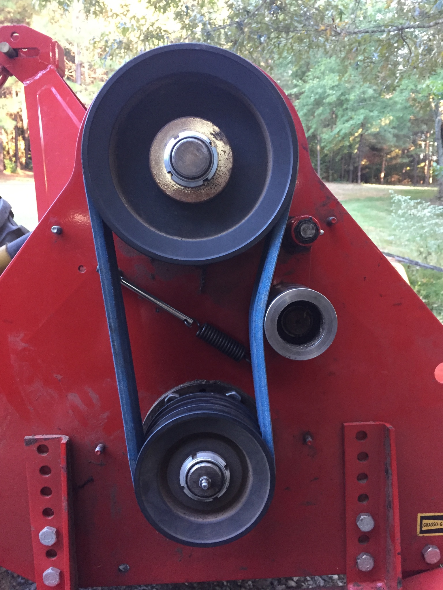

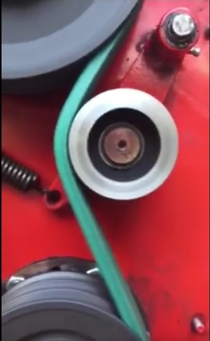

I got in some 45 kevlar belts to try. They were really no harder to get on the pulleys than the 46 belts but after installed they were tighter than the 46 belt. They may be tight enough that the idler pulley might not have to be used but I adjusted it to where the belts can be deflected slightly with my thumb, probably less than 1/2 There is definitely less belt contact on the idler compared to the 46 belts. Hopefully there will be less friction and less heat build up on the pulleys
I had already mowed everything so I did not ave any high grass to try it out on but I did mow a couple patches that had grown some since last week. So far so good.

Looks much better.Should make a big difference.Was the 46" the length that Caroni originally had on it?
