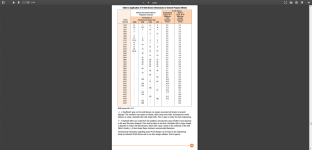

Here is a link to more information on the belts.http://www.driveengineer.com/files/downloads/Carlisle_V_Belt_Service_Manual_2015.pdf. If you go to section 2 troubleshooting design problems somewhere around pg. 32-37. Although trying to understand some of it it can get confusing. If you can't make out the foot notes in the photo you can read it in attached link in troubleshooting design problems.
   / Let's talk flail mowers #4,842
Thanks for the PDF. Very enlightening.
You are welcome. It was for me as well. Most of you guys out there are a lot smarter than I am. Figured if I could put the ball out there one or more of you would pick it up and run with it.
