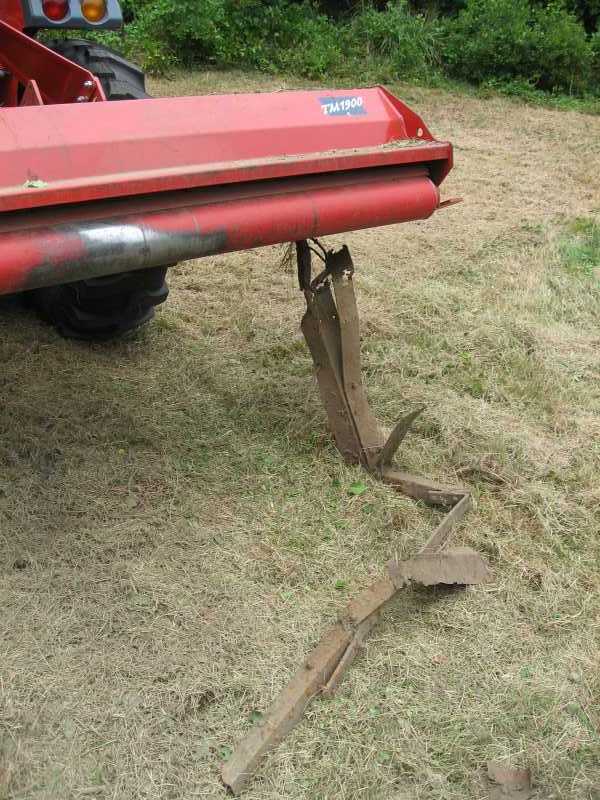

Glad I am not the only one who has hit stuff so bad I stalled the tractor. :laughing:
Worst episode was catching a string of barbed wire and wrapping it up! That took a while to cut off. Wish I had grabbed a pic!
I've hit stuff worse than garden hose and firewood. I ran into an unmarked junk car dump at the end of a field and wrapped Lord knows what pieces of sheet metal around the rotor. No damage but I wasn't equipped to remove it in the field.

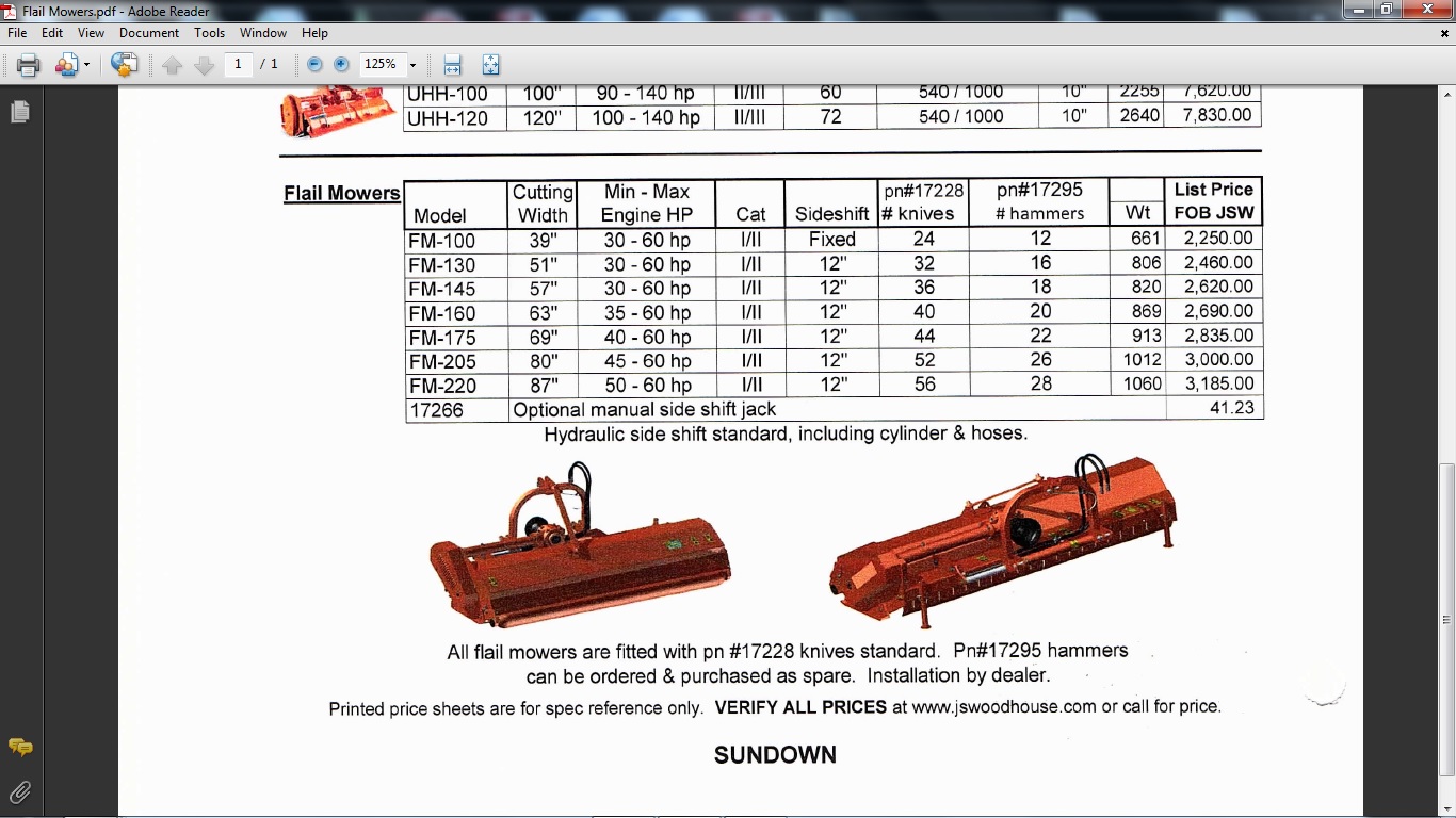

I have read this entire thread, what an informative and enlightening novel! So many folks sharing invaluable info, insight and experience, very helpful. Quick rundown on my situation. I have a Mahindra Max26XL HST and purchased it with a MMM which I quickly realized doesn't fit my needs. I have ~7 acres, and clear between 2-3 of those (the rest wooded) which consists of varying vegetation; average lawn, low pasture, light brush and saplings and pond perimeter growth about half on varying degrees of slope. Based on this thread I believe a flail with knives would work well for me for the majority of my needs. If I need to clear anything larger I will rent a rotary to knock it down and then use the flail to maintain. Here is my question: my dealer gets his non-OEM implements from JS Woodhouse and he is recommending the Sundown FM130 Flail. I cannot find any information on that brand of mowers, some of their other equipment is listed, but not the flails. The 130 has a 51" cut with hydraulic or manual offset and weighs in at 800+lbs. Seems pretty beefy compared to most of the brands/models folks have discussed here of comparable cutting width. I'll try to attach the price list that gives some stats and has a pic of the mower. I asked the dealer for some literature and he told me the distributor said none is available beyond the pricing sheet?! Does anyone have any experience or information on this brand? My mule is rated at 20HP PTO and 2200lb 3pt lift, I have a FEL and rear tires are loaded, so I think I could manage this flail even though its rated for 30HP+. I think ideally I would prefer something a little lighter, 400-500 lbs and rated for lower HP. At any rate, I'm very tentative to purchase this brand w/out more info. Perhaps I should see if he'll take the MMM in trade on another implement (forks or grapple) and go for purchasing a Caroni or Woodmaxx from another dealer, though I was counting on the trade-in allowance to cover some of the cost. Any thoughts or information would be greatly appreciated. Thanks in advance!

Welcome Shawn. I don't know the Sundown brand but they seem like beefy mowers. Not so sure you really need that heavy duty type though. If it were my choice I'd get a quote on the Caroni TL1500 (or better yet TM1500 if they carry it) from Agrisupply. I suspect it will save you quite a bit of cash even with shipping. I wouldn't hesitate to use the Caroni for the tasks you outlined. The equivalent Woodmaxx is probably cheaper too.
Whichever you choose, I agree with your assessment that a flail would be great for your uses.
   / Let's talk flail mowers #4,574
I think it's the same as this: https://www.shaktimanagro.com/flail-mower/
Its chinese. The prices you're being quoted are in line with the typical EFGC (see betstco for example).
The design is a little different. Looks like there's an actual tensioner for the belts instead of adjusting the top shaft. Some SFMs seem to have rear doors, not sure all have them.
The HP ratings are suspect as they're identical for models of different width.
It's too bad the side shift is only 11.8" in all sizes.
