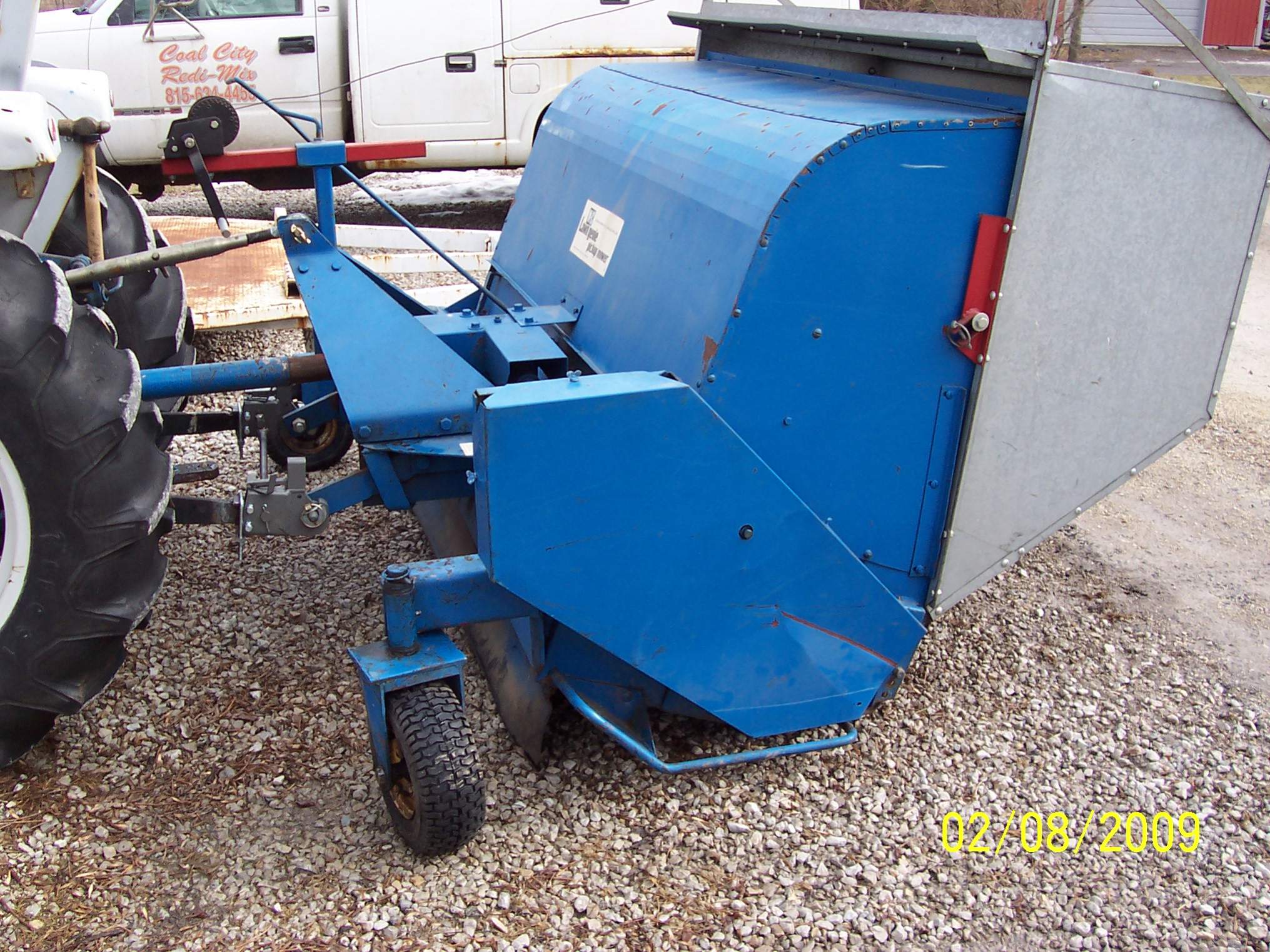

My Mathews flail mower rotates the opposite direction of the tires so it can throw the clippings in the hopper.If I dont want to catch the clippings I push the lever to send the clippings out the back. This system works great it saves me the hassle of sweeping.
Bill
